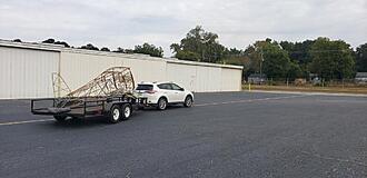

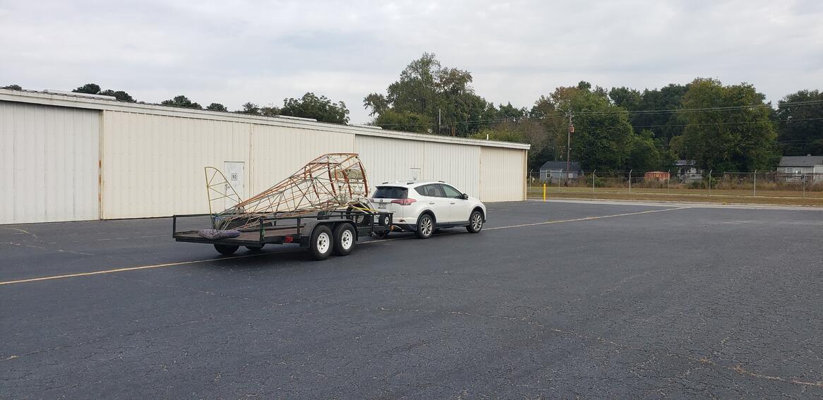

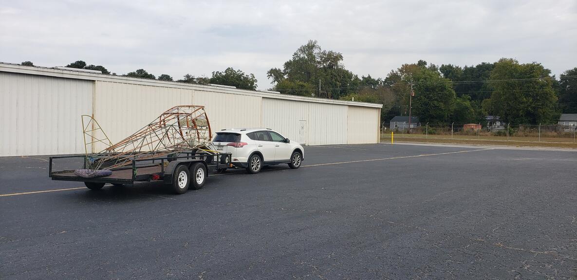

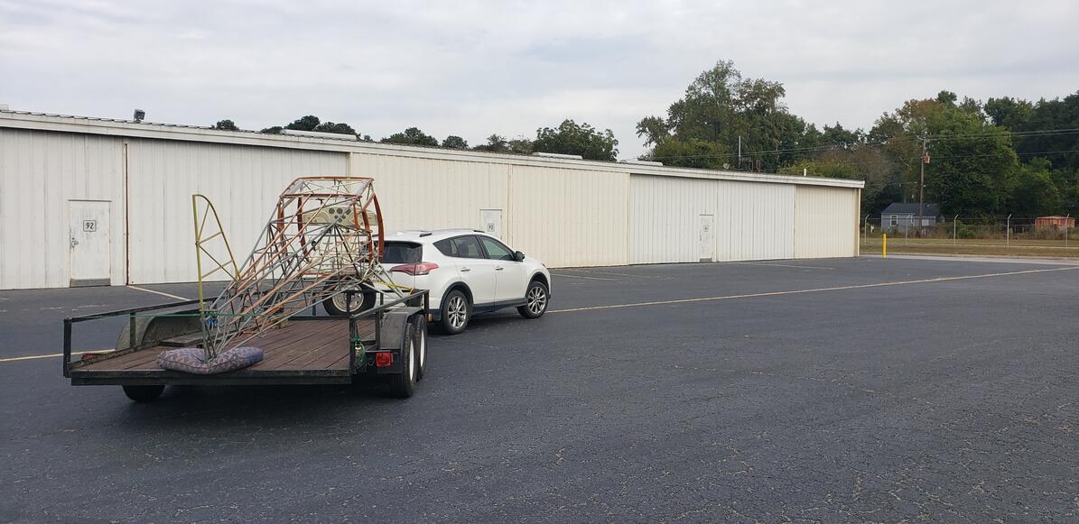

    A true friend and genuine good man covering the fuslage as he told me he 20231011_110731.jpg 20231011_110733.jpg 20231011_110730.jpg needed a project to do to stay busy. He is 87 and looks and acts 57. Key to youth is staying active. This is his 31st Covering job.and he is an A&P and an IA. He even insisted on picking it up! Dad is looking down and smiling for sure! When it comes back it will be in silver ready for paint. I am on to the empenage frames clean up and epoxy them now. Next after that will be taking the old covering off the wings (saving the Taylorcraft wire) and seeing how good or bad they are .

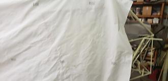

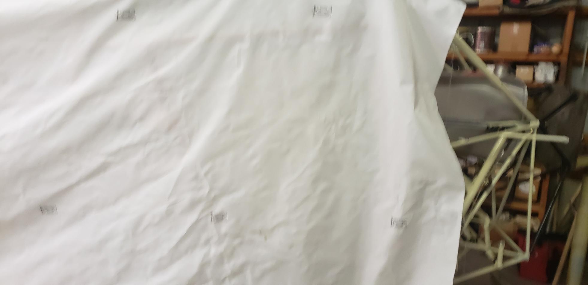

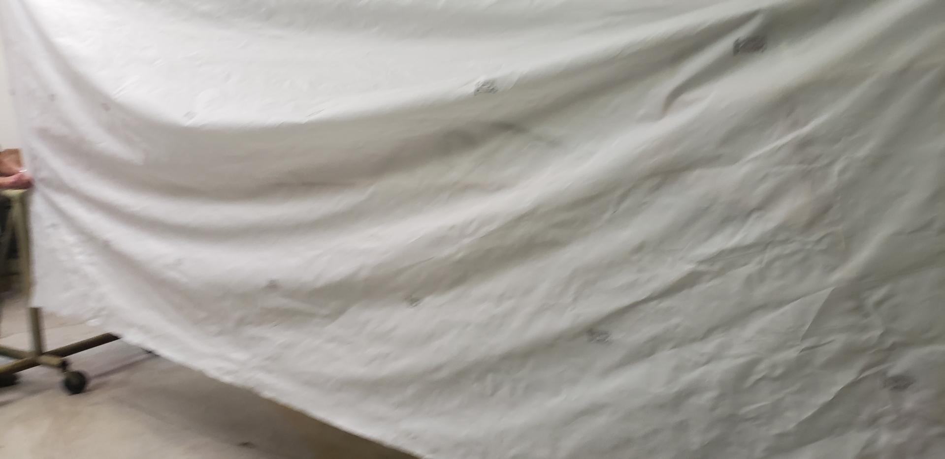

                ​ Yup. Definitely what you outlined Scott as the number 2 method. I worked with him today on the initial layout. . After some lay out work on the floor of two pieces on top of each other , then laying these upside down over a wire he runs from the top of the tail to the windshield, then sews that seam , then lays it again upside down over the wire then marks a center line from the top of the fin down to a temporary wood strip that runs on the top of the fuselage from the bottom of the fin to the windshield . He then sews that . He then cuts that along the seam out with pinking shears along the tail to fuselage center line Material is then turned over (He says he will use the excess material cut out for the bottom of the fuselage i believe is what he said as he asked me if I was ok with a tape line at the bottom ) Any way it was a good part of an afternoons work. He has his system down pat.Top pic was the "final pic of the day . Bottom two were from the ]beginning. He most recently did an Interstate Cadet which I inspected. His seam was lazer straight .20231031_144720.jpg 20231031_144722.jpg

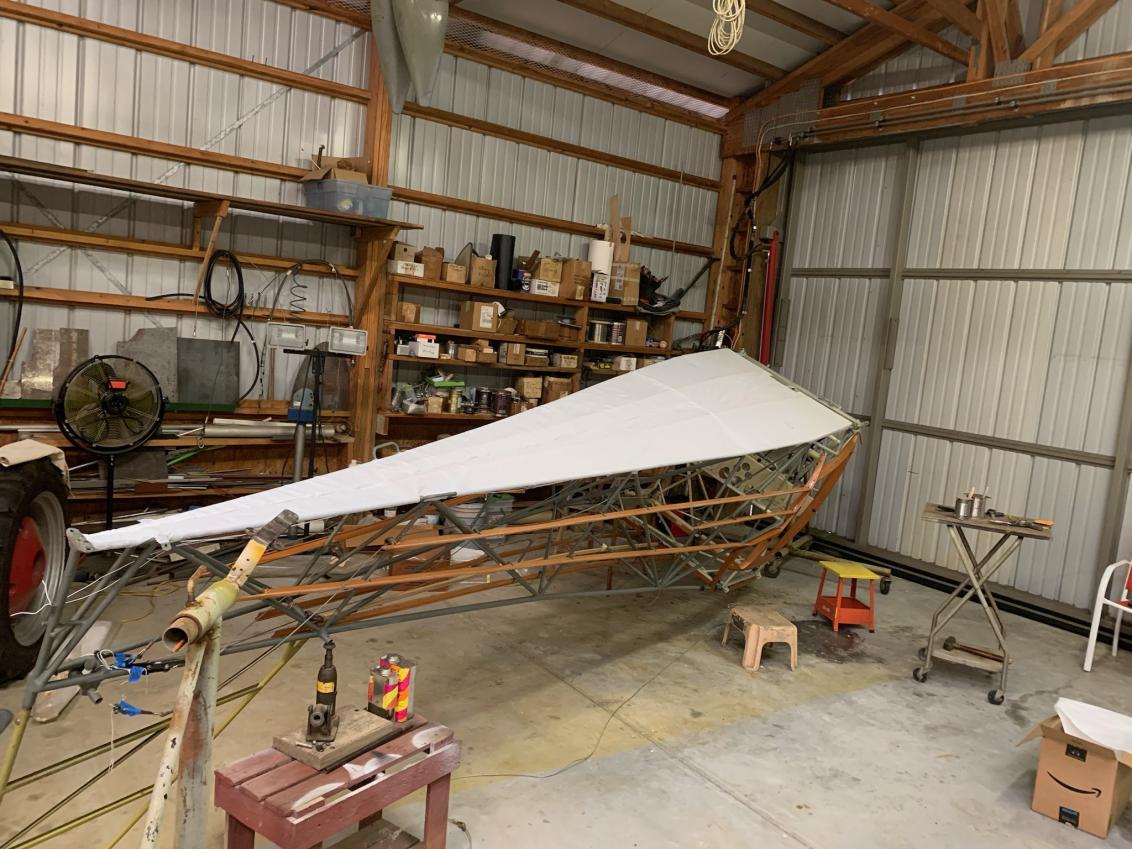

                  Bottom of fuslage covered yesterday. Tighten today. Top also to begin today IMG_0575.jpg
