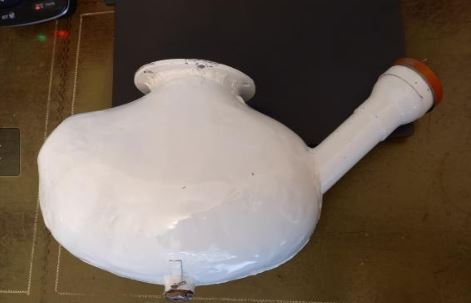

    Does this look like the correct kidney oil tank for a BC12d? Click image for larger version
    correct tank would be a long neck, although that tank should work. Looks a bit on the rough side
      Okay thanks - Yes it is a bit "used"
        They are like hens teeth here in the UK!

                The nice thing about these oil tanks is that they can be repaired. Material is weldable, the opening is big enough to media blast the inside and insert dollies to reform any dents, and then treat and paint to prevent corrosion in the future. I also made new tabs for the cap.
                Relatively uncomplicated work that can be classed as minor repairs.

                      The tank has arrived and looks pretty good and I have decided to leave it as is... (no cost swapped it for an 0 -200 oil tank we had surplus)

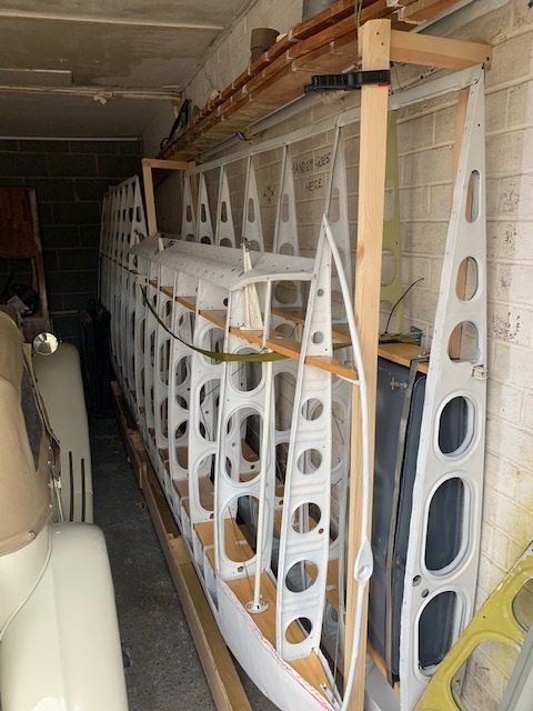

                      We stripped the ailerons last week to inspect - Unfortunately on inspection all 4 ailerons we have are badly cracked and unusable - As the wings are now "as new" we are going to cut some new aileron spars as there is no point in cutting corners.

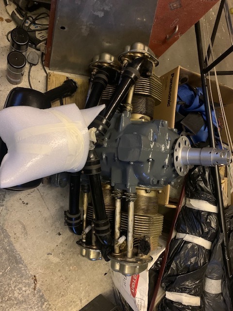

ID:	193884 Our "spares" source - unfortunately well beyond restoration but gave us lots of parts to use.
ID:	193885 Replacement A65 ready to go

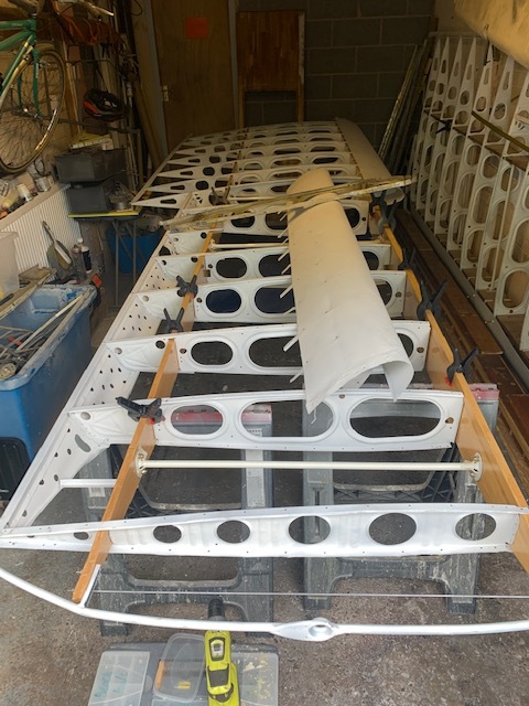

Name:	wing 1 (1).jpg
ID:	193886 Both wings have been totally rebuilt
ID:	193887 Now stored ready for covering this summer

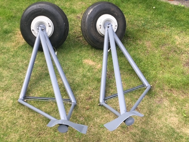

                        Undercarriage, wheels and brakes rebuilt - Awaiting a final coat of epoxy before covering this Summer. Click image for larger version

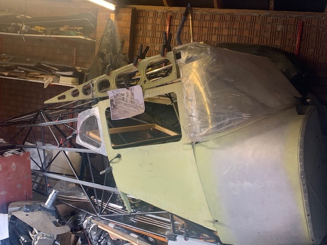

ID:	193891 Main tank and fin G-BVDZ will have 2 wing tanks in addition to the main.
ID:	193892 Aligning the door frames was a difficult task - Both doors now open / close smoothly after days of packing and fuselage is also nearly ready for covering.

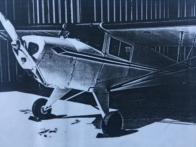

                          Hopefully N96743 (Now G-BVDZ) will shortly Click image for larger version
                          look something like she did before the crash in 1991
