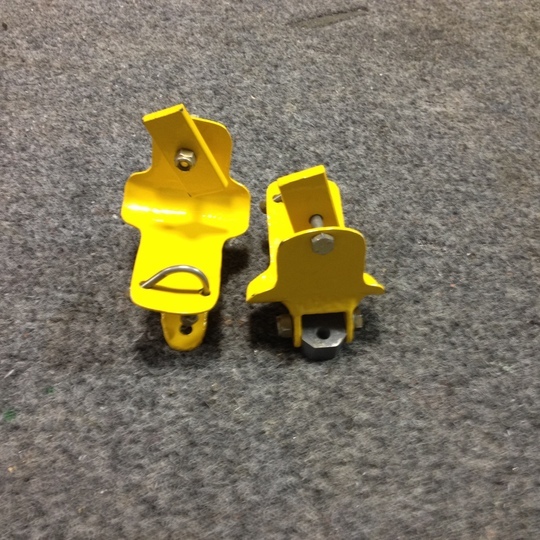

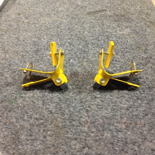

      Thanks for the help!! Is there a source for the clamp-on version or a drawing and specification for the clamp version? It appears to me 1/8” thick metal?? Thanks again for taking the time to help.
      paul
        I've not seen a formal drawing. Forrest Barber (https://www.barberaircraft.com) may have further information. There is an informal factory drawing in the link. They may have just sold the part as is. The Atlee Dodge fitting is commonly fitted but might take a Field Approval from the FAA.
          I am not sure of the bolt size, but I am guessing it is a AN5. This would mean that the head is 1/2". For the metal to be 1/8" the thickness would be 1/4 the head flat to flat. I would guess that the metal is .063 from the picture, but that is just an educated guess.
            Look at the print PDF. The adjacent tubing cluster is probably sized relative to the fitting (?). Try taking the tubing OD and then size the fitting relative to them. Owner built parts for those that are now extinct. Here's two of mine plus rear longeron float cable pulley ears.
            Click image for larger version  Name:	IMG_2520.jpeg Views:	0 Size:	124.0 KB ID:	192366Click image for larger version  Name:	IMG_2519.jpeg Views:	0 Size:	141.4 KB ID:	192367Click image for larger version  Name:	IMG_2521.jpeg Views:	0 Size:	133.2 KB ID:	192368
              Well then there's the question of whether the yellow brackets above are Taylorcraft sourced, fabricated later, or for another type aircraft. Same for mine above that are welded to the tubing. John H N96337 might know as he has commented on these matters before in other threads plus the one in #2 I linked. In reality many were just "done" as the factory may have been closed as was common. Atlee's are very nice but do require welding and approval maybe.

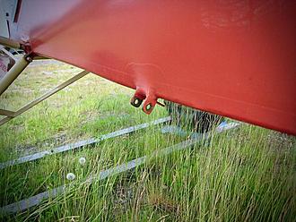

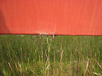

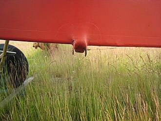

                Originally, there was just a tube up through the cluster there at an angle, and a bolt went up through it, for the rear strut . I'll see if I can get a picture of mine tomorrow.
                  Maybe the factory ex-production option replaced the tube John has to make for easier field replacement. But, obviously EDO, along with Baumann, PK, Aqua floats made their own rear fittings. Some Taylorcrafts came with float fittings; others were added later. In the end they are the very best light weight low power floatplanes I've flown, considering cruising airspeed and lifting a load off the water. VG's help as well.
