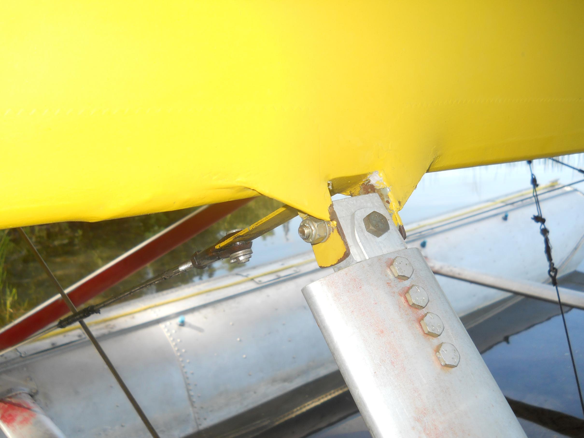

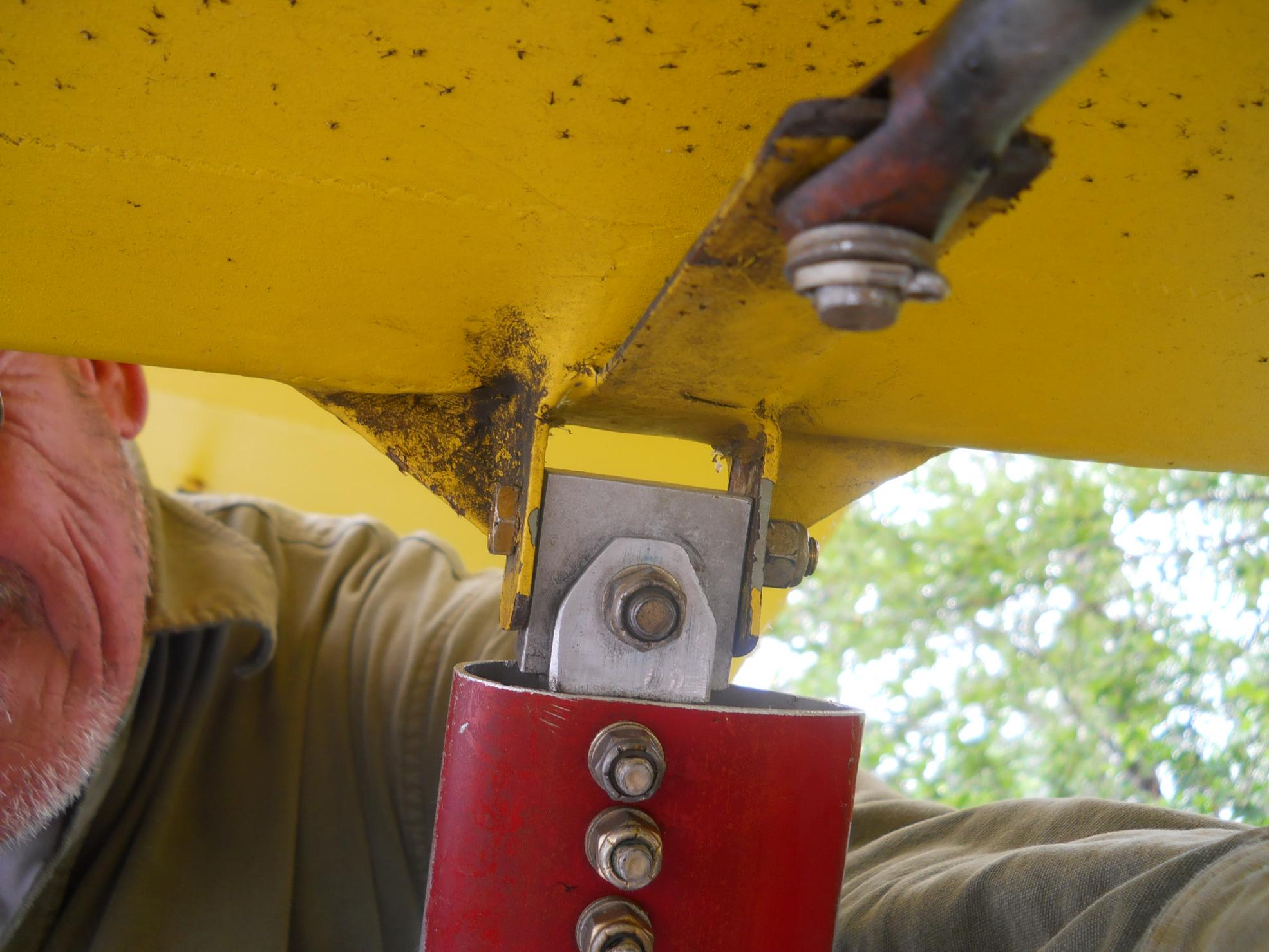

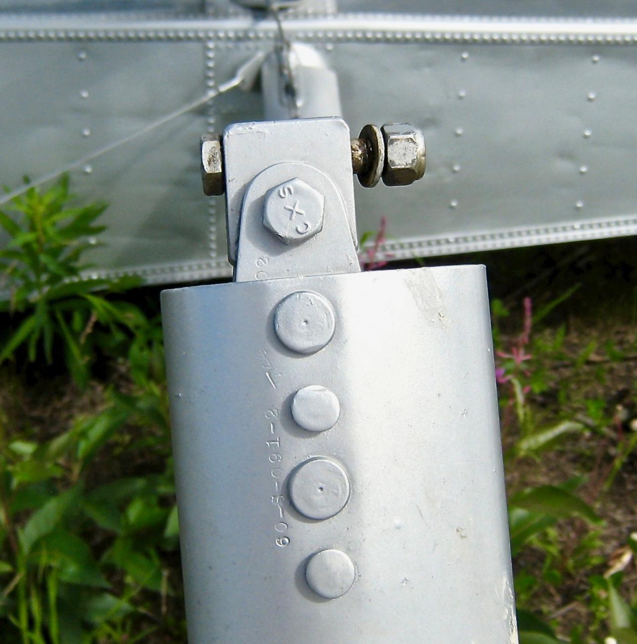

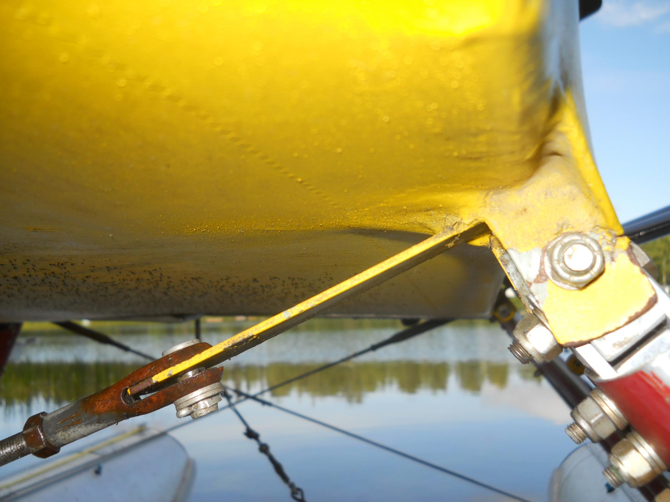

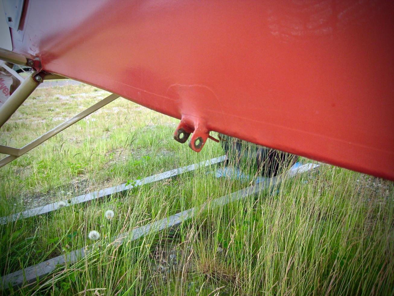

          Here's pics of my welded-on rear float fitting and upper strut fitting. The block on the strut bolts to the fuselage. Crossed tie wires attach to the lower tang on the fuselage fittings. Everybody happy.

            Mine are similar to Gary's.

              Hi Dick. I like those side braces to the "ears" similar to Atlee's fittings for Cubs. More strength and surface area.
