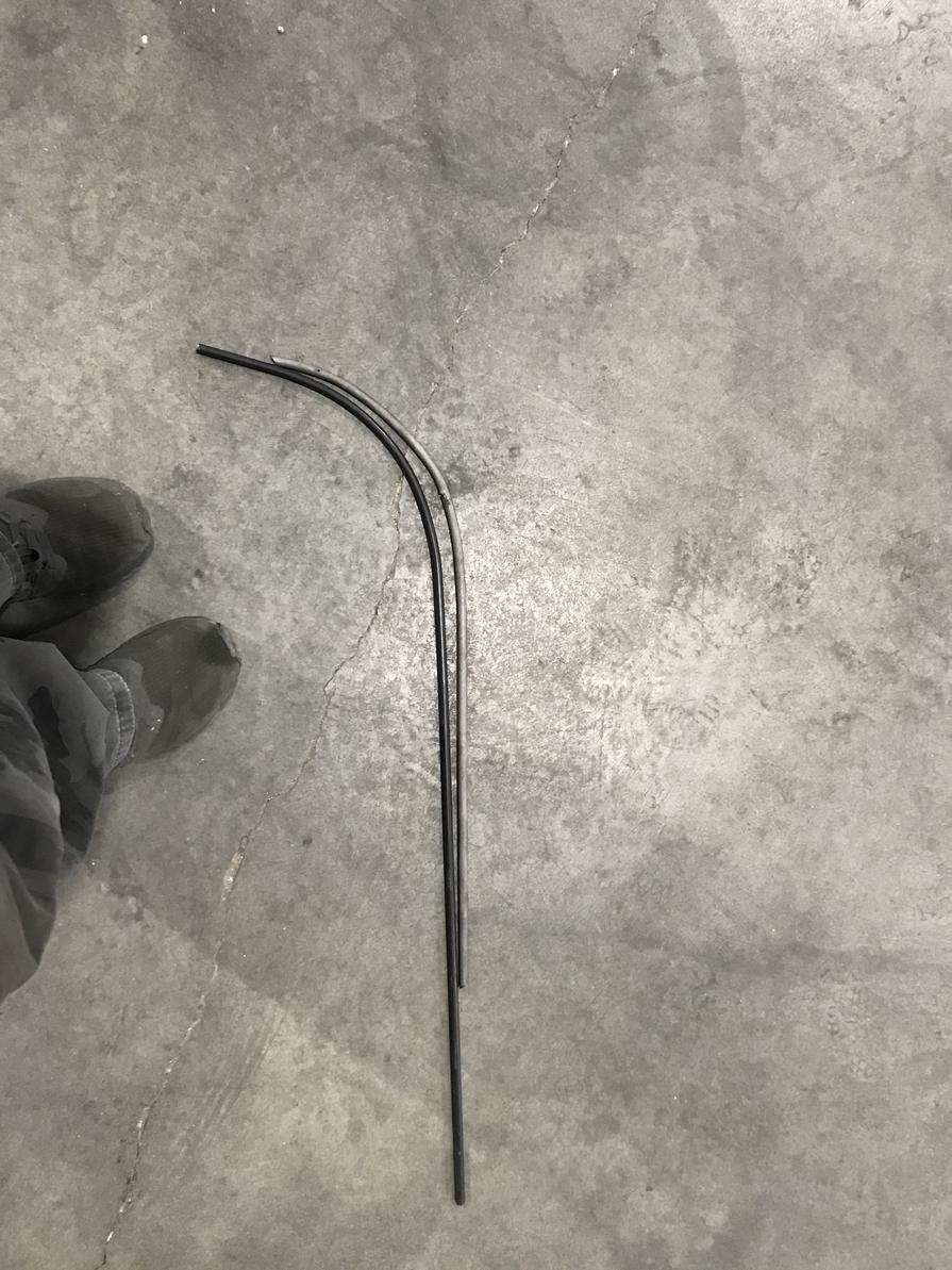

    Well it’s been 2 years since we took Peter’s airplane apart to do some fabric repairs. Suffice to say that the welder guy never touched them in a year and a half. Well I got them back a couple of weeks ago and now we have progress! I am not a great welder myself, and I have tried to get 2 other guys to come practice and one showed and had a lot of tungsten contamination from dipping into the puddle... second guy has been a no show so far. If I can’t get a guy to do the welding, I will have to practice and just make it happen!

      Yeah, taking way too long. His ailerons have fabric on them but still need tapes. Then get the rest of the tail feathers to the same point and then we can get them finished and back on! I still have to build new cables for the ball bearing pulleys when we get that far. The 2012 restoration was not so good at removing corrosion, that is why we started this project. Tim
