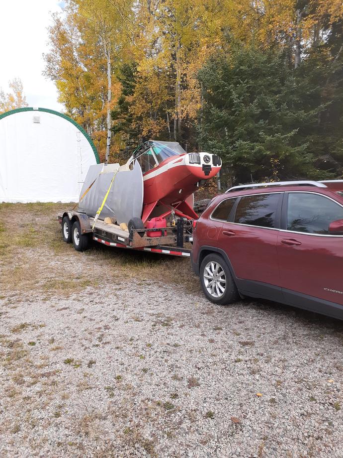

    I was contacted in September by a friend of one of the previous owners of my BC12D. He wanted me to by his airplane after seeing photos of CF-CLR.
    Long storey short... I'm into another restoration:
    PA-18-95? Hard to see the front V-brace.
      you got it. 1960, very original. PeeKay 1800s and federal 1500s, a little over 2700 TT. It was damaged while tied to a dock but so far only non-structural issues. Was in storage for over a decade.
