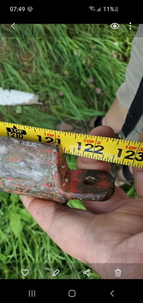

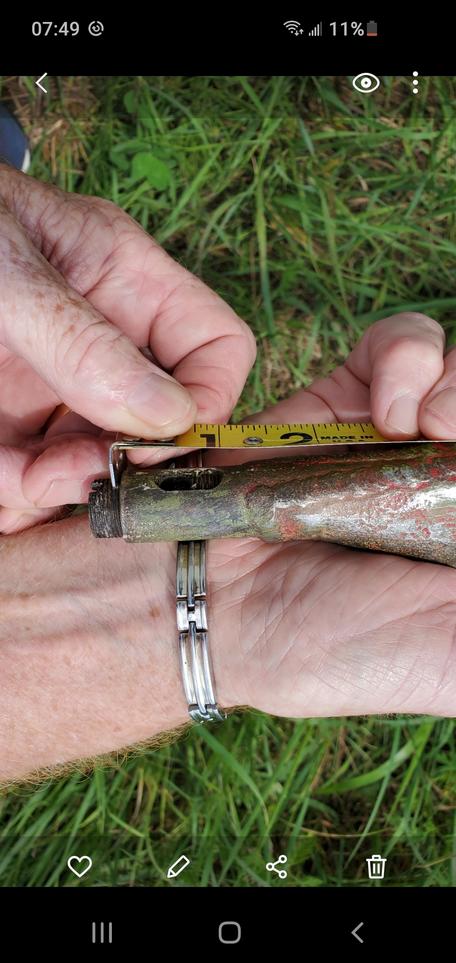

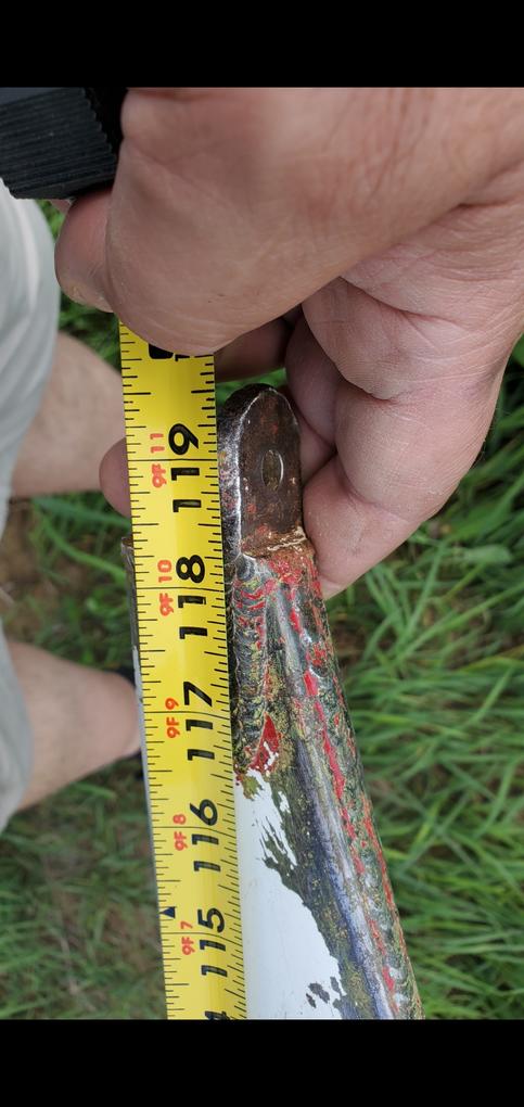

        Thank you gentlemen ! Are struts the same for pre war Taylorcrafts? I would hate to buy and not fit on mine. I include lenghts of my old struts. Thanks
          As far as I know the struts were the same from the A model all the way to the F-22. That being said the materials and tubing sizes changed along the way, with the earlier sruts being a smaller cross section and made from mild steel.

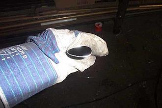

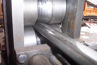

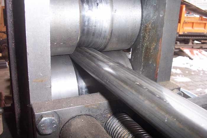

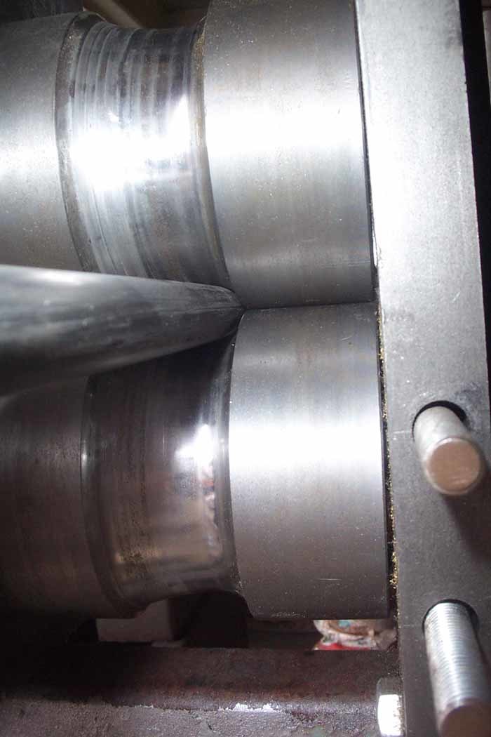

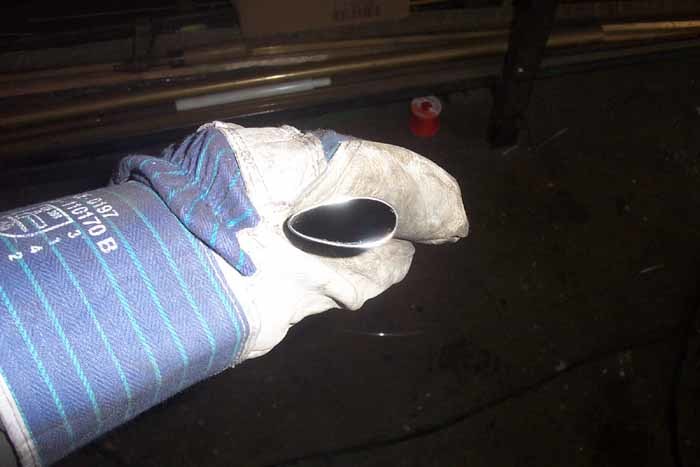

                    The reason there are so many different strut sizes is economics. Strut streamline tubing is made by pulling round tube through a set of roller dies to squeeze teh tube to a streamline cross section. As you can imagine that can cause some wear and damage to the rollers and they are NOT CHEAP (unlike most manufacturers). When the rollers get worn or damaged the least expensive fix is to machine a bit off the rollers, but this make the cross section of the strut bigger. It also requires a larger tube to start with. Now think about the factory in the 30s. Money is tight. The rollers are worn. Turn them down a bit and go to the next size up tube. CAA is happy since the new strut is stronger than the old one so it just gets a pencil whip approval. Later 4130 steel tube is available to replace the older material. Again, CAA says stronger is better so a simple approval. Overt eh years the struts keep getting bigger and bigger. If you have access to the really old original struts from the 30s the current REAR STRUTS are larger than the original FRONT STRUTS!!! The attached photos are of actual struts being rolled. It is fascinating to watch.
Name:	A E Streamline tube tool 1.jpg
ID:	187945Click image for larger version
Name:	A E Streamline tube tool 2.jpg
ID:	187946Click image for larger version
Name:	A E Streamline tube tool 3.jpg
