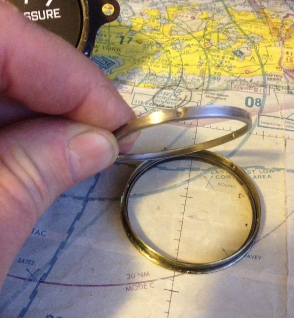

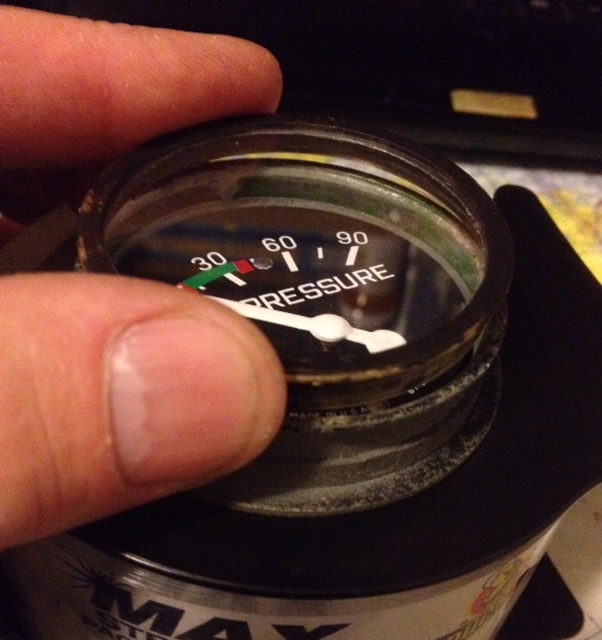

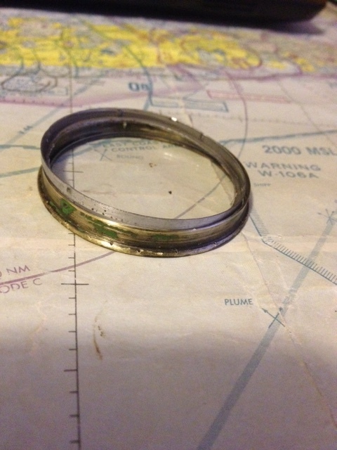

      The bezel needs to be pried out of the gauge case and then you'll see another metal ring pressed inside the bezel holding the lens--on my U.S. gauge anyway.
      It's gentle work but equally gentle cussing helped.
      When the sun comes up I'll try to take a few photos.

          I used a 48x1.5mm lens.
