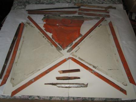

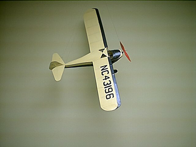

            Click image for larger version  Name:	IMG_0005 small.jpg Views:	0 Size:	20.7 KB ID:	185278Click image for larger version  Name:	Skylight1.jpg Views:	0 Size:	144.3 KB ID:	185277Click image for larger version  Name:	ModelTop.jpg Views:	0 Size:	44.6 KB ID:	185279
            In early 1945 Taylorcraft built two planes with factory Skylights. They were woodworkers nightmares and never went into production. I have one (damaged) and am rebuilding it. Can you check with your IA and find out if he would allow you to use a factory design that didn't go into general production? It worked GREAT and didn't have a lot of the problems with the huge skylights you see now. There were only two triangular transparencies over your head but when you looked up through them they have a wide angle of sight because your eyes are so close. They actually used them in at least one advertisement but the artist put the triangles one behind the other instead of side by side!
            I loved them and hope when the 41 gets recovered my IA will sign it off as a minor change. Fingers crossed! (Last one is of a model with the same skylight)

                  That is what I have assumed in the past, but my factory skylight was designed, installed (at the factory) and tested by Taylorcraft. It flew for decades on my plane. The problem is it was only "officially" put on two planes that I know of (the two prototype post war Deluxes). I wouldn't want to just home design a skylight. The question is, can my factory design be used on other planes without them needing a STC.
                  This is really a "Legal" question more than a safety one. I know the design is solid. There was some pretty deteriorated wood in mine when I took it apart but no sign of any failure. It IS well designed, just complex.
