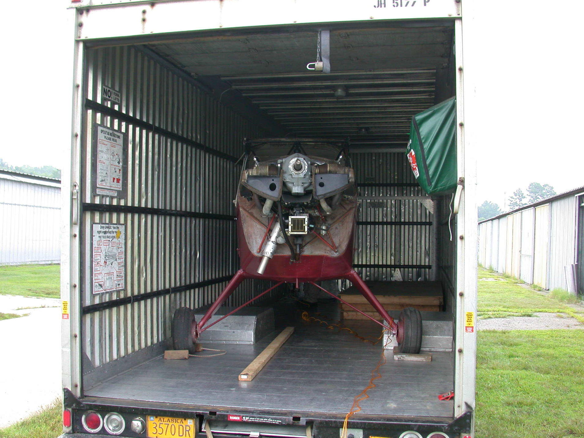

            U-Haul works fine. Can't remember the length I used but I think all I had to do was take the tail surfaces off and could even leave the engine on. Rudder was "just a tad" too long to fit. With the rudder and elevators/stabs off and a slight angle I even had a lot of room for all the extra parts in the hangar. I could have taken the wings at the same time bit we decided to make two trips and take the wings alone so we could lay them flat on a bunch of foam cushions. Miles were cheap and I only had to move it to an airport15 miles down the road. Click image for larger version

              When we put dad's airplane together we had to move it about 50 miles. We did it in 2 or 3 trips with a flat bed trailer and a van. I can't remember if we brought both wings in one trip. It was a full day with 6 plus hours of driving. Everything arrived with no damage from moving.
                Make sure you get extra help! If you think 3 people can do it, have 6! We did find that three could lift the nose of the T in even with the engine with no ramps. Also DON'T break the belly stringers on the edge of the trailer!!!! We tried ramps, but it was just too risky compared to lifting her. Had one on the prop shaft and one one each main. It WAS heavy! Three on the engine and 4 on the gear would have been a snap.
