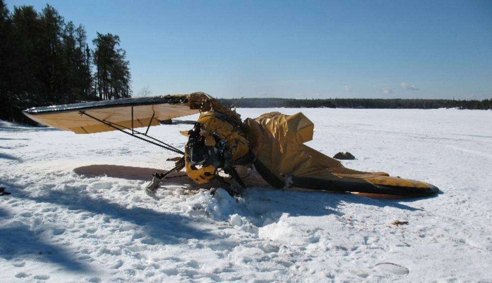

    I've attached the TSB report on a fatal J3 accident which perhaps, should leave us feeling thankful that the FAA imposed a far more stringent inspection requirement for Taylorcraft lift struts compared to other types in response to basically the same issue (internal corrosion of wing lift struts).
    The accident aircraft had not been properly maintained and the owner/pilot was clearly irresponsible, but the key finding here is that the "punch test" prescribed in the Cub AD apparently has a low probability of revealing problems:
    ".....the heavily corroded area on the lower half of the failed wing lift strut assembly had a remaining wall thickness between 0.002 and 0.019 inch, well below the required minimum. Punch tests applied to this area revealed one perceptible dent.
    the corroded area of the upper half of the failed wing lift strut assembly had a remaining wall thickness between 0.021 and 0.031 inch; therefore, some areas were below the required minimum. Punch tests applied to these areas did not produce any perceptible dents."

    Anyway, everyone needs to look at the original Piper strut AD. That was the start of ours, and from the photo in the Cub report above, was completely ignored. Just my initial opinion. For further reading, look at "Dave Wiley" Taylorcraft crash.
