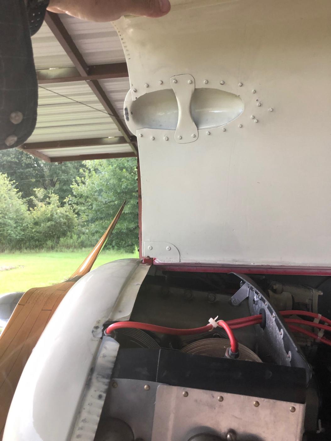

                  I'm going to try to attach a photo of the port side cowl bump on the engine side. notice that the opening cuts through the edge of the top cowl. That's why I added the little "bridge" for strength.Click image for larger version

                  Tim Hicks
                  N96872
                    Very cool. Thanks!
                      Another GREAT example of how Taylorcrafts were ALL just a little different from each other! I have about half that much cut out in my LH side of the nose bowl on the 41.
