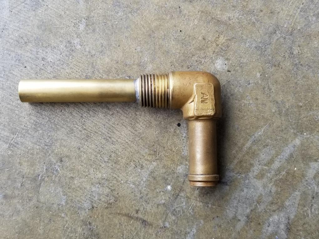

    I wanted to thank Tim (astjp2) for his help modifying the crankcase breather for the C85 to an aerobatic breather. Quality of workmanship is top notch. I was always cleaning the belly with the previous engine and am hoping this will help to cut down on that.

    If that doesn't fix it route the breather line over the front cylinder base and down in front of the rear one. I had to do that on a C-90 even with this extension. And insulate the line if freezing temps are expected.
      I just did a 65 with it, and it did a nice job of cleaning up, but he didn't have a big problem to start with either.
        We should ask about the why of excessive blowby. If it's combustion leakage passed piston rings and exhaust valve guides then fix that first. Do cylinder leak down checks and have a look inside the valve covers for exhaust gas cooking oil. Some have tapped an airspeed indicator into the oil filler cap to look for excessive crankcase pressure:
        https://www.121five.com/admin/Featur...essive_Oil.pdf Also see TCM SB M89-9 http://www.csobeech.com/files/TCM-SB-M89-9.pdf
        It might also help to drill a small lower drain hole in the added vent's extension so oil that passes by has a way back into the crankcase. Or add a whistle slot to the lower breather tube as explained in the link.

            Thanks for the vote of confidence Stu, I am glad you liked it. I got your letter. I just did it to mine a few month ago, my belly was always covered. I am thinking I might do the "real gaskets push rod tube modification." I should really wash the engine down. I just wont use purple power though, very corrosive to engine. Tim
            holy crap what a bunch of incomplete sentences. Gary my compressions were 80/80 cold and hot and I still had oil on the belly. Some engines just do that. Tim

                          Alot of times, placement of the end of the breather will be in a low pressure area and will be sucked out the breather tube. It won't be an engine issue. I have only had to do this mod on one airplane, it was an Ercoupe with a C90 installed.

                            Yes and this from above (https://www.121five.com/admin/Featur...essive_Oil.pdf) recommends an anti-siphon hole or slot be installed upstream to reduce crankcase oil mist loss. We do that in cold climates to prevent freezing of the oil/water mixture and blocking the breather tube.
                            I had a C-90 in a PA-11 that liked to blow oil. We installed Tim's internal breather extension, ran the hose up and over to discourage flow, and placed the end of the tube in several locations. First it was on a mid-time engine, then a topped engine, and finally after a major overhaul. Rings and valves were tight on the latter two. Still blew oil until I started running the sump level 1/2-1 quart lower than full (4.5 to 4 total in a ~5 quart sump). Blowby nearly quit and returned after I filled the sump. My fix.
                              One thing to watch for is low spots in the breather lines too. The oil can pool up and block just long enough to cause problems. I had a 1340 out one time to a well known Ag operator repair service, and they called and said our engine smoked. I knew it was fine when I bought it off the test cell a week earlier, so I drove over. They'd installed the breather tube facing forward. They still wont own up to that.
