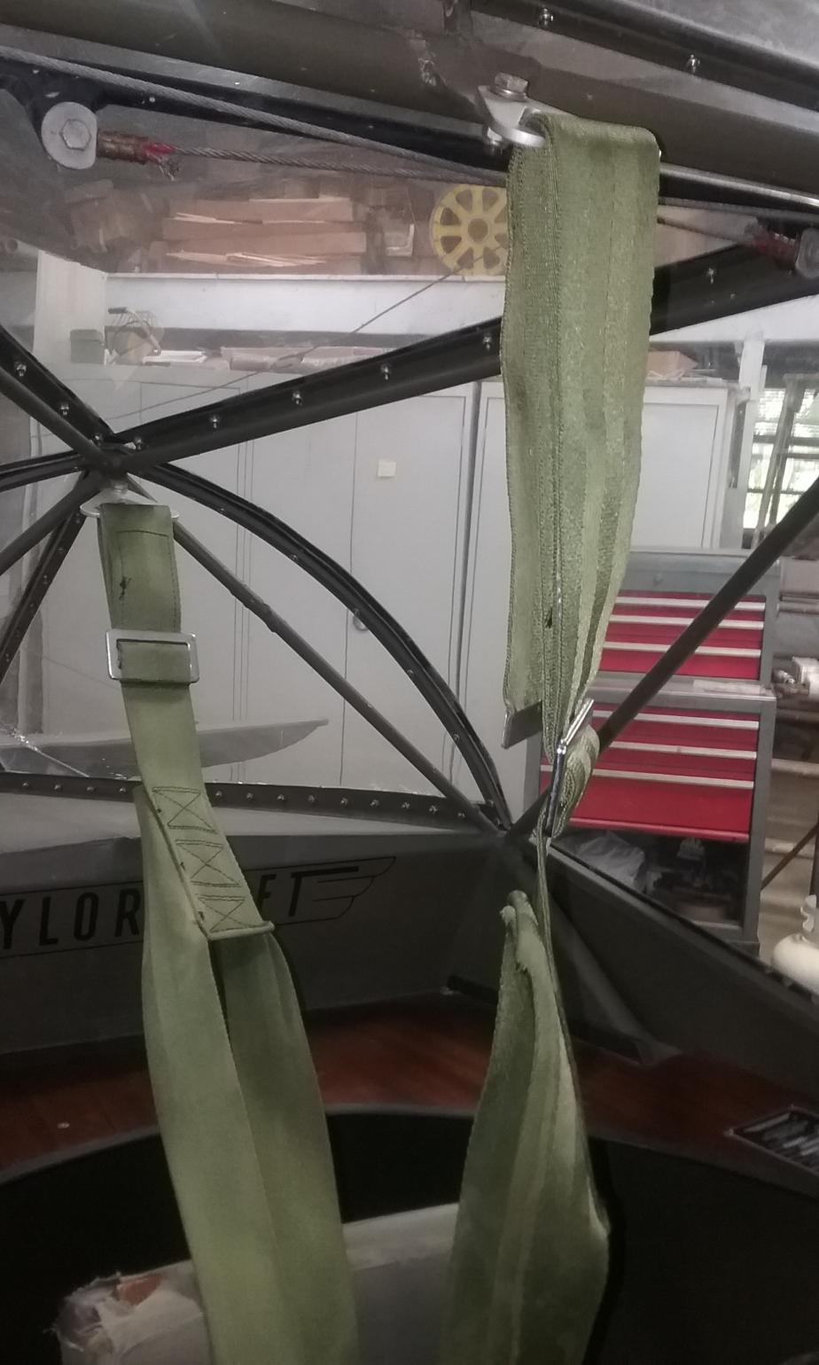

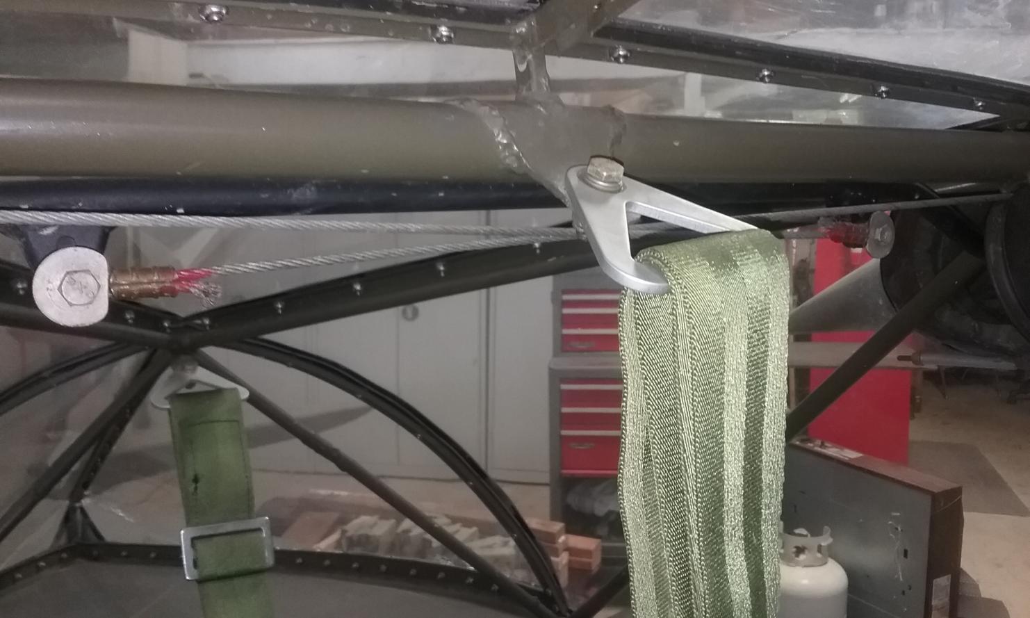

                  Attached to a welded tab on upper structure.
                  Click image for larger version  Name:	20190513_132015.jpg Views:	2 Size:	123.1 KB ID:	182677Click image for larger version  Name:	20190513_131958.jpg Views:	3 Size:	131.6 KB ID:	182678
                  Sully
                    that welded tap would have to have a 337, if you just wrap the harness around the tube, its a logbook. that depends on if that tab is original, if not, it needs paperwork because it was welded.
                      Isn't there something about not putting the load in the center of the tube also, I know on mine I was told to put it at one corner of the other, I put it at both ends

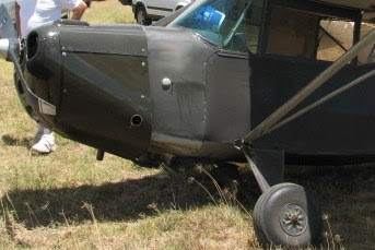

                              Originally posted by RyanShort1 View Post
                              Can we agree to disagree??? This was about a decade ago and was why a certain aircraft I used to fly had them installed. I wasn't on board when this happened.
                              Eek, that, hurt (referring to the picture).
                              Seems like the system would have been designed to handle the load when the bungee broke.
                              Makes one wonder about the condition of the slides and if they ever got inspected for damage, wear or proper assembly.
                              Certainly a safety cable would have been a nice thing to have.
                              I have landing gear snare cables on my Champ, not required but a good idea.
