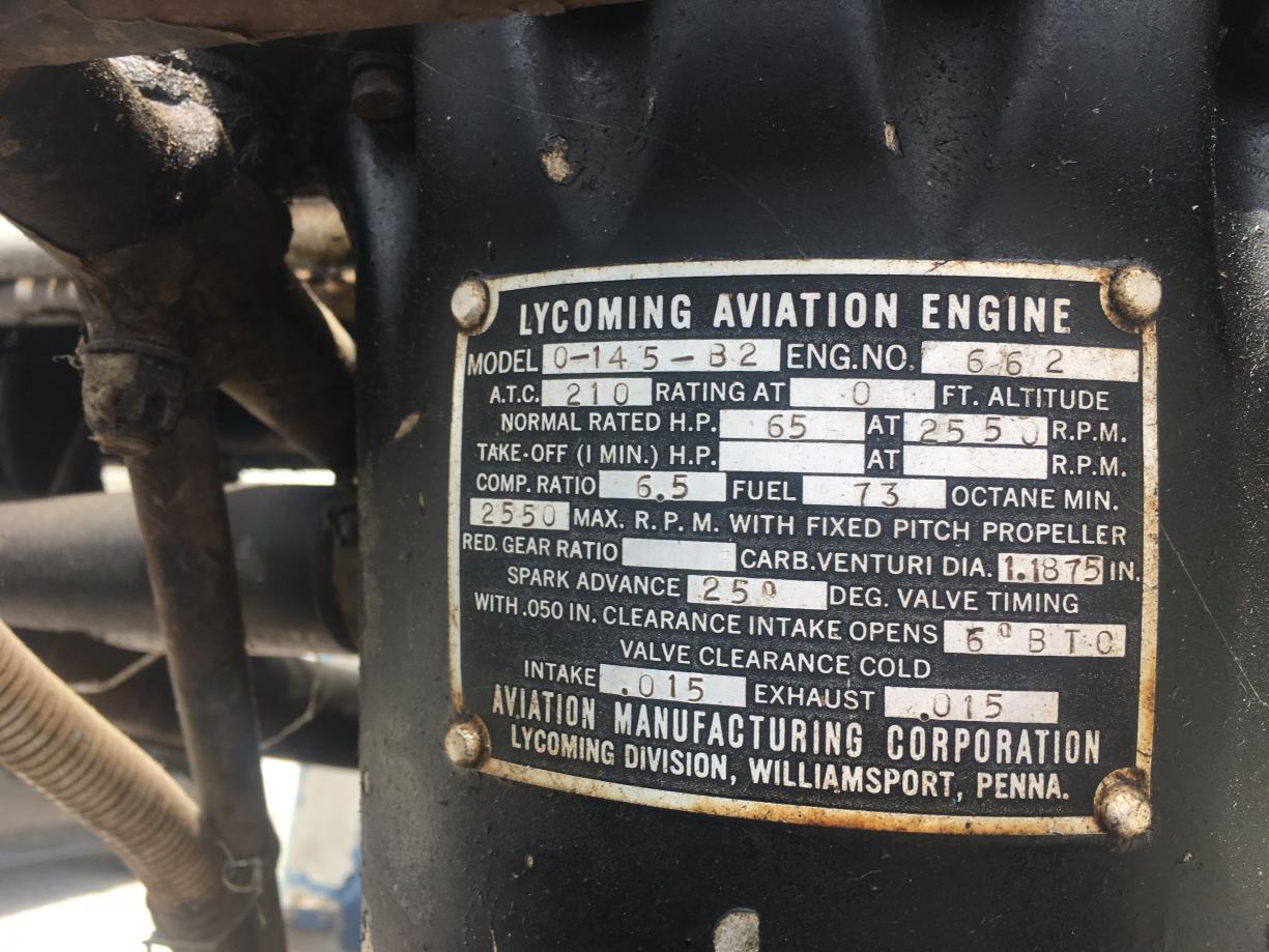

    The motor is a O-145 and we were debating to replace with a Continental. Upon further inspection of the aircraft as a whole, it is not missing any of the original pieces... it even has the original Corwin bubble compass which still works, though slightly fogged.. but still readable if it were to fly. All of the gauges are still intact, unsure of their functioning condition. The craft hasn't flown since '76 and has been well taken care of. Inspection of the tubes will take place in a couple weeks and we'll start replacing corrosion, if any.
    So, after all of that, until we are able to inspect the motor, we were told by a few people that we should keep the O-145 since it's a complete craft and try and restore it complete original.We are leaning that way at this time. I did make a call to 2 shops in our area and both have never worked on that type of motor (cast in cylinders). Question: does anyone have any recommendations for a affordable shop to rebuild the motor? We're located in Illinois and are willing to drive to the neighboring states. Poplar Grove is slightly expensive for our budget since it's being done through a 501c3 and limited donations.

    I restored a 1941 BL-65 back in the 1990's. https://issuu.com/vintageeaa/docs/va...no-10-oct-1994 It had been converted to a continental engine sometime early in life. I chose to go back to original, because I also had all of the original instrumentation. I am an A&P, and did my own engine overhaul. Even back then some engine parts were hard to find. My old airplane now resides at Brodhead.
    For the engine, parts are hard to come by and they can be expensive. Finding a shop that even knows what the engine is might be difficult. JP Hackenburg is the TC holder, and they have some parts and perform maintenance on the engines. Not sure if they can help you out or not. Any A&P mechanic can perform the overhaul. With a little luck, and parts searching you might not need much help from an overhaul shop.
    If you decide to keep the Lycoming talk with me before you buy a prop. if you decide to go Continental I can offer guidance there as well. My son or I might be able to help with 5 tuck spliced control cables too.

          You need to post some pics...I would put on a continental to fly it and display the o-145-2, less chance of crashing from an engine failure. There is a reason the continentals were used more than the lycomings and franklins...they were just more reliable IMHO
          Send me a pic of the header tank valve gas valve, if the one I make works, I will donate one. Also don't sacrifice safety over originality...a few modern non visible enhancements goes a long way towards safety.

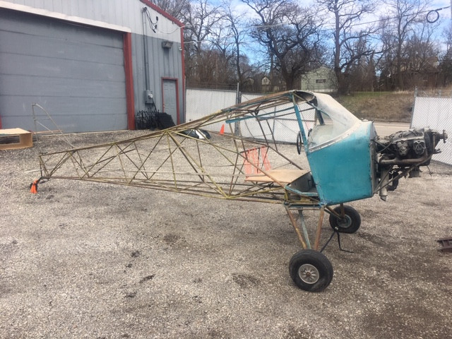

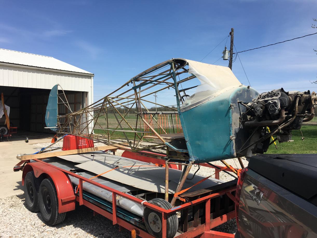

            Sorry I've been a way for a bit. I've had some personal thing to attend to. I'll take some better pics but this is what I have from the day we picked it up. I'll post some pics when we start looking at it later this week.. The wings are at the airport while the fuselage is located at my building. Fuselage I'll pull out and snap a couple. I'll post what I have now... let me know if there's a particular picture you would like to see.

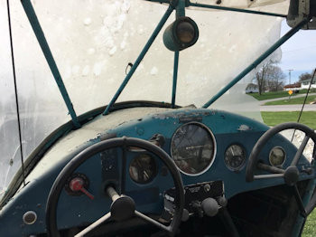

                  Looking at your pictures it looks like the panel has had some stuff added to it along the way. The control wheels have had a section cut out of them. Also the exhaust is not right for the open cowl. It might even be a Piper J3L exhaust.
                    Not sure where Romeoville is in IL, but know there are some other owners in the state and nearby. Once the word gets out I am sure you will get some Forum and Facebook owners who will come out of the woodwork. Wish you were closer to SE Virginia so I could be there! Keep us up with a blog or continued postings! The big problem you will have with parts is SHIPPING! Parts can be very inexpensive (CAN be) but transport can often exceed the part cost! Investment in a trailer or car top carrier combined with students who travel across country to homes in other areas can really save you money moving parts.
                        I'll take a look at the wheels and check for cuts. As for the panel, I'm waiting for pictures of the plane dating back to 1960 when it was purchased. She has quite a few to send us.
                        Hank: I do have a friend that runs LTL trucks and he may be able to help with shipping but that depends on what part of the country we may get things from. Like I said, struts are the question and we have one of the kids from the school that will check out the 'ultra sound' machine and bring it to my shop and test the tubes.
                          The wheels should be a complete circle. one segment has been cut out. This is not the first set I've seen this done to.
                            I'm new to T-Crafts and was doing a picture research before we picked it up and saw both types. When I sat in this... I can see why they cut them, more leg room. You know them better than I do and will take any advice since you restored the '41. I read the whole article. I've been in contact with Dave Leiting at EAA and we discussed your write-up. He wants to do the same thing with this one since it has a little different story behind it. They love they fact that we're incorporating the college and high school kids on this project and trying to complete it as cheaply as possible (donations) but still be a professional looking restore. They also like the idea it might be a training plane (Tail Wheel) for the students involved.
