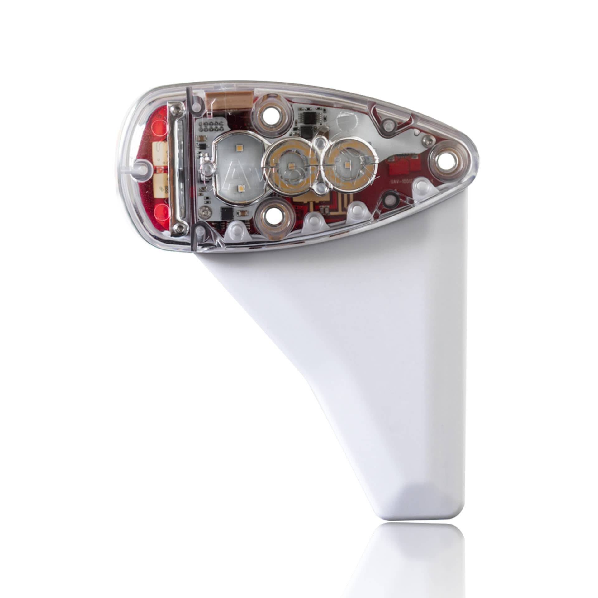

                  With uAvionix skyBeacon there is no pairing because they are both contained in the unit.
                  That might make skyBeacon easier in some cases.

                        I am going with the SkyBeacon because I have a strobe on the rudder and I don't want to loose that- thinking possibly keeping me from getting run over, see where a Cessna 150 landing in California and a T-28 didn't see or hear him and landed on the 150 killing the guys in the 150, hardly marked the T-28

                              I installed the TQ KTX2 transponder and already had the skyBeacon wingtip unit.
                              Did my flight test on Tuesday July 2. Everything went well.
                              Sent in for my rebate.
                              The TQ KTX2 was $1300 plus cost of antenna and coax of about $150.
                              Skybeacon was $1870.
                              Probably spent $30 on circuit breakers & wire.
                              About $3350 total.
                              I picked these two unit because of ease of installation. Easy mount and no wiring needed between transponder and skyBeacon, I liked that.
                              Very happy with them.
