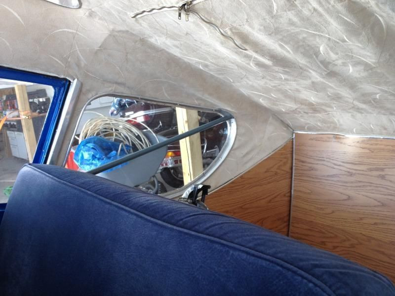

ID:	181176 Since I bought a wrecked F19 a few years ago, I plan to install the F19 windows in my BC12D., The only thing is the fuselage on the BC12D has a diagonal brace that will run through the window but it is easy to make a notch in the F19 window frame to accommodate this and it is not too distracting. I have some photos of BC12Ds that had been modified to the F19 window and will try to attach one. Larry Wheelock

              I was looking through my 2018 Taylorcraft calendar today and found that the October 2018 page shows a BC12D that has the F19 rear windows. Shows the owner as Darrin Kenny register lists him in New York state.. Looks like N95938.

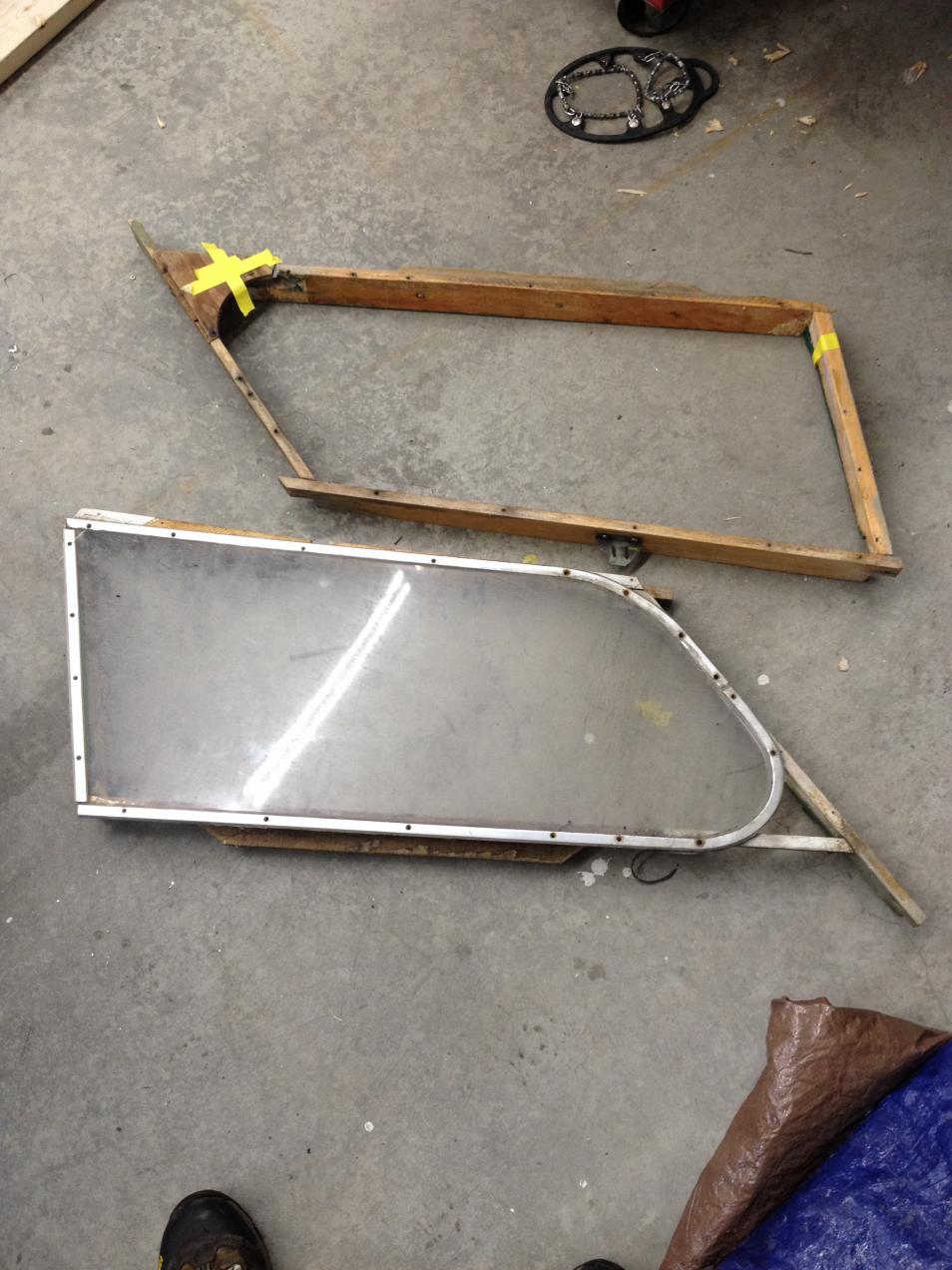

ID:	181420When we added our large window frames I was fortunate enough to get a set from the factory (was a miracle). They were Pma’d for all side by side Tcraft including Model A’s.

                          I all ready have large windows on it. They have these wooden frames. I'm getting ready to refabric and was thinking of using f19 Windows thinking the frames would look a bit cleaner. I just haven't tracked a pair down yet. Thanks for all the info.
