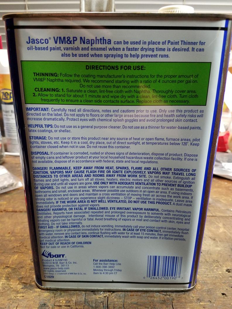

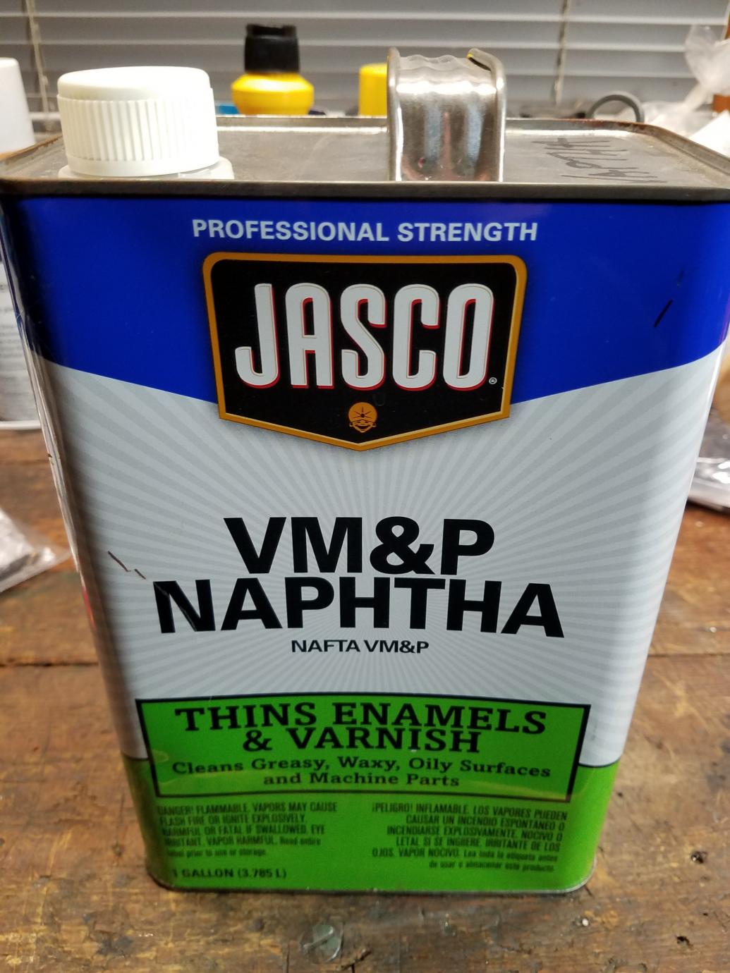

            I have a can of VM&P Naptha that I use with contact cement and so on. Never tried it on the windows nut will soon, the Aeronca has some over spray.
            VM&P is Varnish Maker's & Painter's not sure how different that is from what you have Marty.
              David, sounds like the same stuff I use. There is another Naptha but it seems to have an oily film. The Naptha in the photos is the one I use and is the same as lighter fluid.
