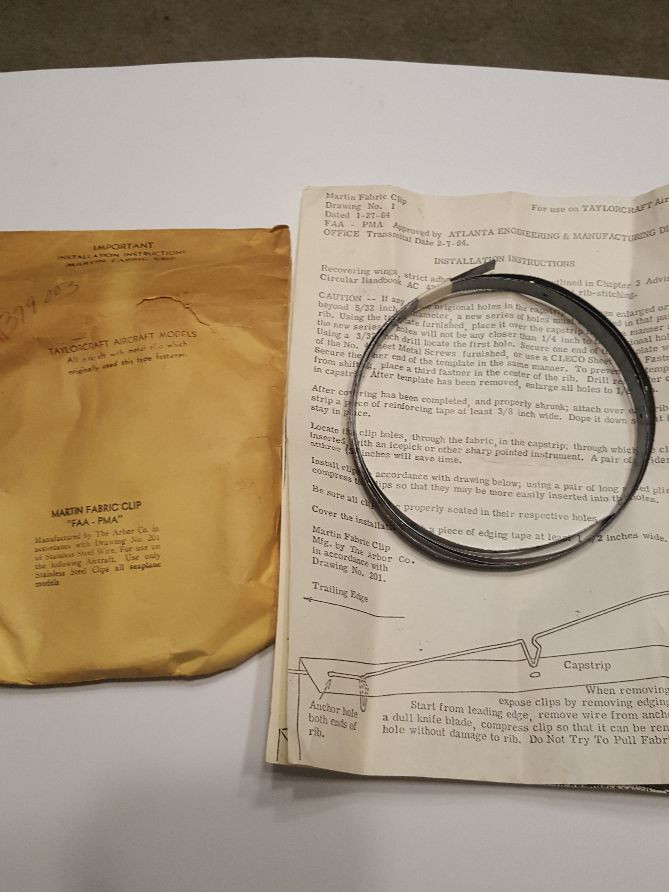

                              I'm deep into a major hangar cleanup and came across an envelope containing a couple of pages concerning Martin fabric clips and a template for drilling a series of new holes: Click image for larger version

                                I sure appreciate all of your help! Still not sure what to do though. I can't find the 337 in the tech section but I haven't gone through all 15 pages. Thanks again!
                                Bruce
