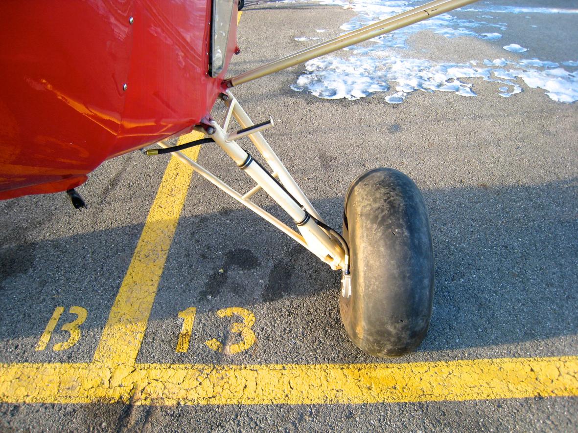

        Hi Steve, just saw on the FAA website where a Taylorcraft had a gear collapse, could you tell us what happened?, thank you, gary, I only bring it up in case it was from rust inside the gear leg, would like to know
          Re: Bc12d info
          I've seen a Taylorcraft L-2M landing gear collapse before. Rust is a SERIOUS issue.

                  I would be surprised if a cross wind was more than a contributing factor.
                  I suspect there are still a significant number of gear legs out there with no or plugged drain holes and to quote my bud Neil... rust never sleeps!
                  A worthwhile and easy additional step is to squirt some line oil or Acf50 into the strut through the clear and rust free drain hole. Surface tension and action of the gear leg will coat the inside of the tube and displace any moisture.

                      The diagonal tubing is open at the top near the bungee cord contact or tubing weld cluster, and at the bottom if the drain hole is free of debris. Air pressure applied at the lower hole might drive corrosion particles out the top for an inspection of internal problems. If off the plane for inspection tapping the diagonal tube while upside down may do the same.
                      Preservative oil can be blown in top or bottom. But that begs the question how much is the tubing compromised from pervious corrosion? I'm not for an AD but it's worth periodically having a look at the gear for internal and external wear and tear.
