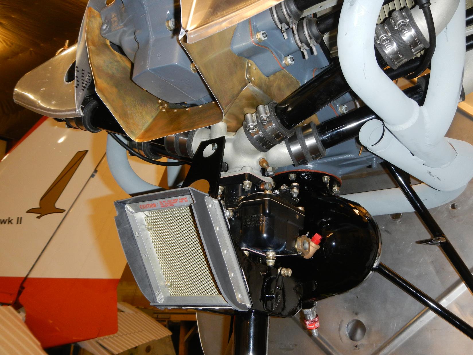

    I have a major problem with high oil temps, so we pulled the cowling and started to look at the baffling, its a mix of engine baffles.com and original baffles pieces. I had a major problem with the copiolots front baffle not sealing correctly, so we pulled it and I did some modifications to get it to seal better. While that piece was off, I also did the breather mod. Note: the brass tube that I was using is no longer available, the company that made it went out of business.
    With the baffling back together, I still have a few more seals that I have to make and install along with some silicone, but it was off to rebuilding the fuel lines. I used -6 hose when I put the airplane back together in 2001. Well one of them developed a leak so I decided to use hard line from the header to the gascolator and then a new braided Teflon hose with fire sleeve from the gascolator to the carb. Forming stainless tube is not fun and after 5-6 attempts to get the bends right, I was able to get the line made and clear everything with a nice gentle down slope. Here is a pic of the hard line. The original hoses that I installed had the fittings real close to the kidney tank, now problem is much better with double the clearance that I had before. I also now have lifetime hoses with fire sleeve!

        What's the status of your crankcase baffle, the one between the case and intake? Mine was missing completely and without it the underside of the engine gets air pressure from the "scoop" under the prop (reducing engine cooling). With the crankcase baffle in place, most of that air gets channeled up behind the prop to the top side of the engine and through the cooling fins, but the important thing is the pressure above the engine is higher than below (so you have airflow past the cylinders).
        The relatively small airflow that does go below the engine (with the crankcase baffle in place) is channeled along the crankcase where the oil is flowing back to the tank.

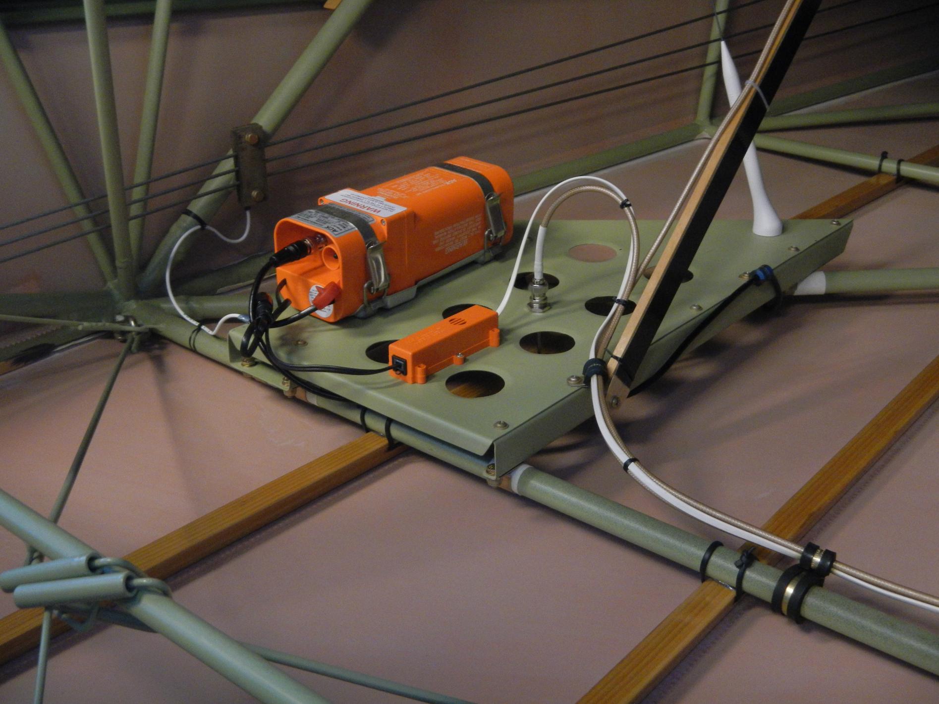

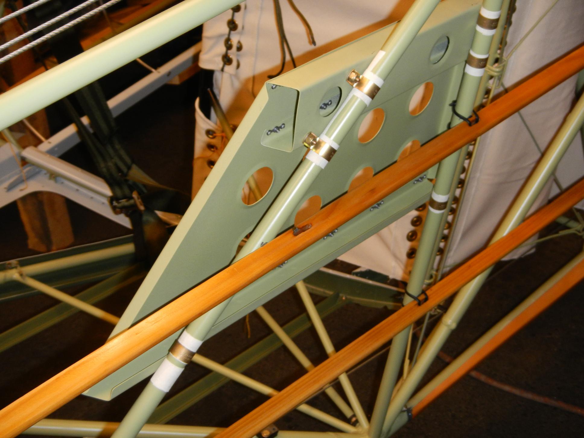

        ps. Here's an alternative ELT/equipment shelf if a machine shop is not available.
        The clamps are AN742 Steel , AN3 bolts, and shelf and channel material is 2024T3 .032", plus 6-32 structural screws and nutplates.

          Scott, will that elt mount take 109# of force and not move more than .100? and you cannot use any cushion around the clamps, it interferes with the shock loading that the 406 elt's require.
          I have the baffle between the spider and case, beat up but its there. I eventually will try to get a mold built to make that baffle, but its still a long time off. Tim

            Scott, will that elt mount take 109# of force and not move more than .100 in the down and forward axis? and you cannot use any cushion around the clamps, not meeting these requirements interferes with the shock loading that the 406 elt's require.

              Well no official testing of course but the mount can't move relative to the main structure it's attached to. There is no cushioning, only a single layer of anti-chafe to protect surface corrosion protection. According to Aircraft Spruce the clamp material is rated at 50,000psi, An3 bolts at 125,000psi. There are 4 clamps effectively directly attaching the ELT which weighs about a pound, and two additional clamps for the remainder of the shelf. 45G forward is the maximum of the required forces that the mount must withstand, which translates to less than 50#.
              I believe the whole thing is considerably over built such that the limiting factor is the fuselage structure, not the shelf or its attaching hardware.
              As always I'm interested in engineering analysis beyond my capabilities, but based on comparison with other certified aircraft installations, and the four 6-32 screws that are specified by the ELT manufacturer, I'm confident the shelf is more than adequate.

                            Scot, that mount will fold over because it only had support on 2 of the 3 axis, it will just fold over.....at least by what I am seeing. There is only an equivalent of 3 sheets of metal, lets assume .032, with a sideways push or force applied against those pieces for a total of .096, it will bend which reduces the shock load that the ELT needs to activate. Strength is not the only thing needed to be calculated, a cable is strong and stiff in only 1 direction (tension) an elt mount needs to be strong and stiff in at least down and forward to trigger the alarm. That is why I built the one I did the way I did, I had to create a structure where it was able to flex and prevent it from flexing. oh and as an afterthought, the ACK 450 has an AD on it because ACK didn't follow their own quality control manual when manufacturing.
                            Don't get me wrong Scot, I think your fabrication skills are superb but I would not sign off on that mount on an annual based on what I am seeing because there is not lateral bracing. Tim
