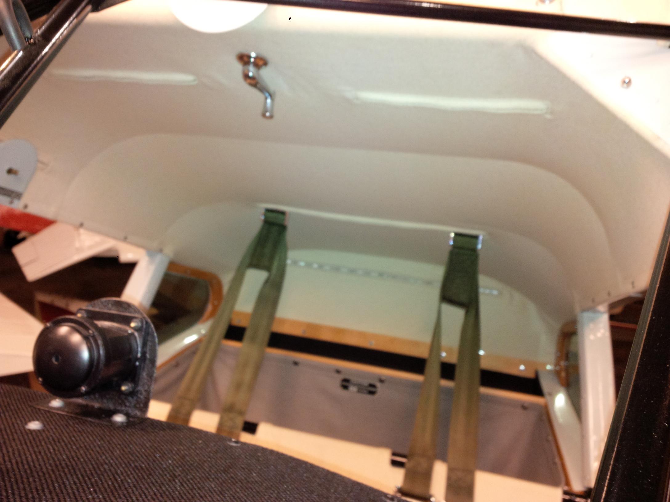

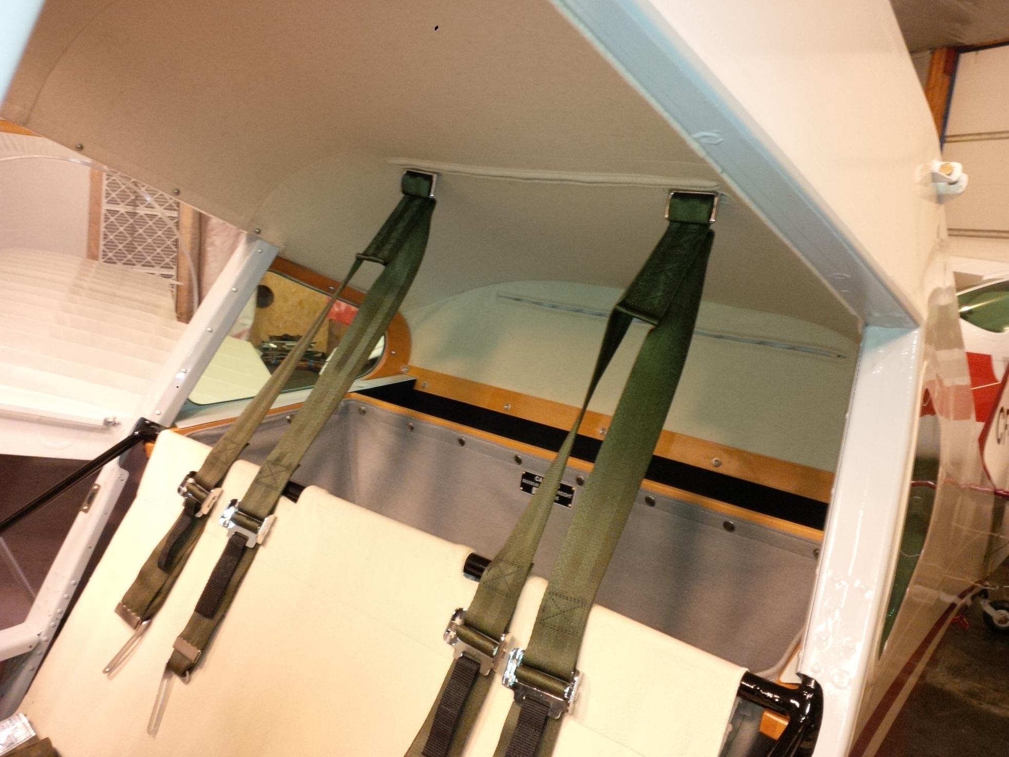

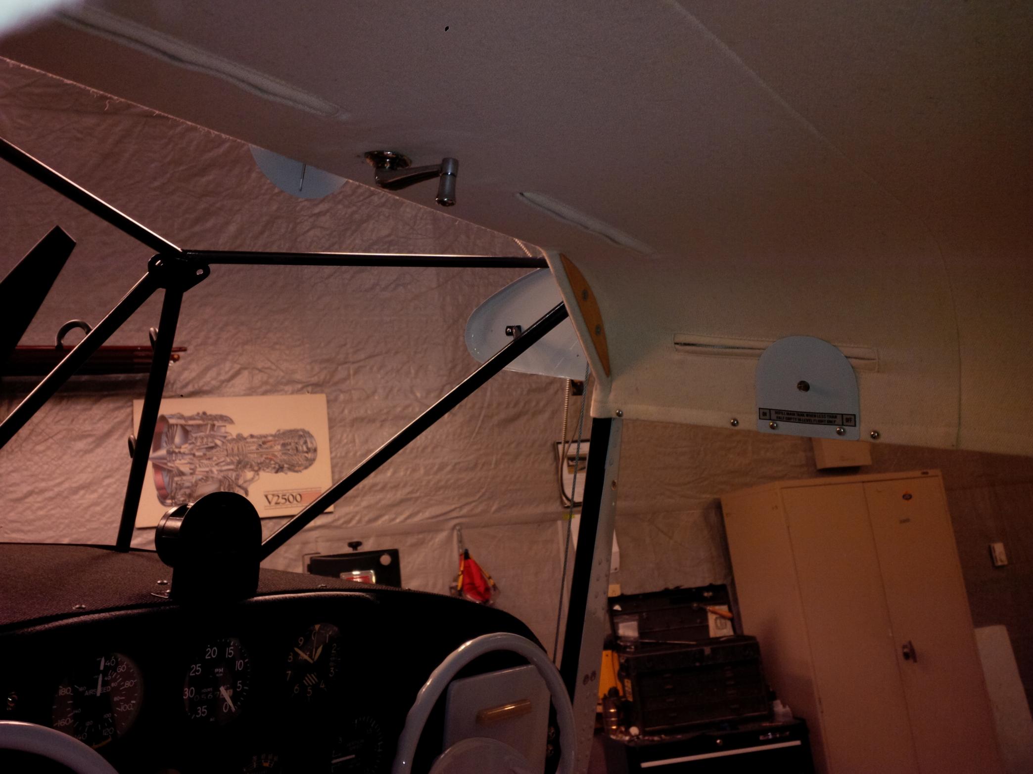

          Put another long dreaded step behind me today... the headliner! I can't even begin to tally the number of hours that went into that project. Starting with the wrong model headliner, then making a pattern out of an old sheet, then fit trim remove stitch x4 and finally the last three days for final installation.
          Anyway... ta dah:

            Scott, headliner looks great and progress is outstanding as well!
            Your blog is as well done as your work on CLR, please keep it up as it is quite a valuable resource to all Tcraft owners/future restoration projects as is Rob Lee's blog.
            I would suggest when you are done to some how collect it and the photos into an file or ebook and I would be happy to pay for a copy of your "book". Such well documented info really needs to find a method to be preserved as it helps us all.

              Thanks Mark
              Yes I was toying with the thought of turning it into some kind of reference book, perhaps combined with my 172 restoration so it's not such a narrow focus. All that will need to wait until I've caught up on my fishing!
