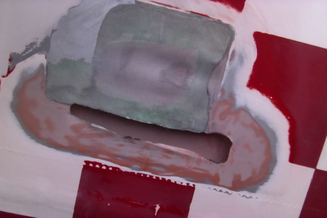

Well I got to the bottom of the tear in the rudder fabric. A patch had been previously applied, but the patch was not pinked, and a tear developed again along the patch edge when it came in hard contact with the elevator. It also appears as if the patch was a different type of material than the underlying Poly-Fiber covering. It's green.
So two questions.
1) How "clean" does the area need to be before applying Poly-Tac and putting on a Poly-fiber patch. Can small remnants of the aerothane live under the new patch, especially where the patch covers a tape edge? It's difficult to sand out some of the aerothane in the pinked edges without fraying or cutting the underlying fabric.
2) Is it just me, or when MEK'ing down to the pink Poly-fiber covering does it seem like you are working on a corpse, what with the pinkish flesh tone and strong embalming fluid smell?
