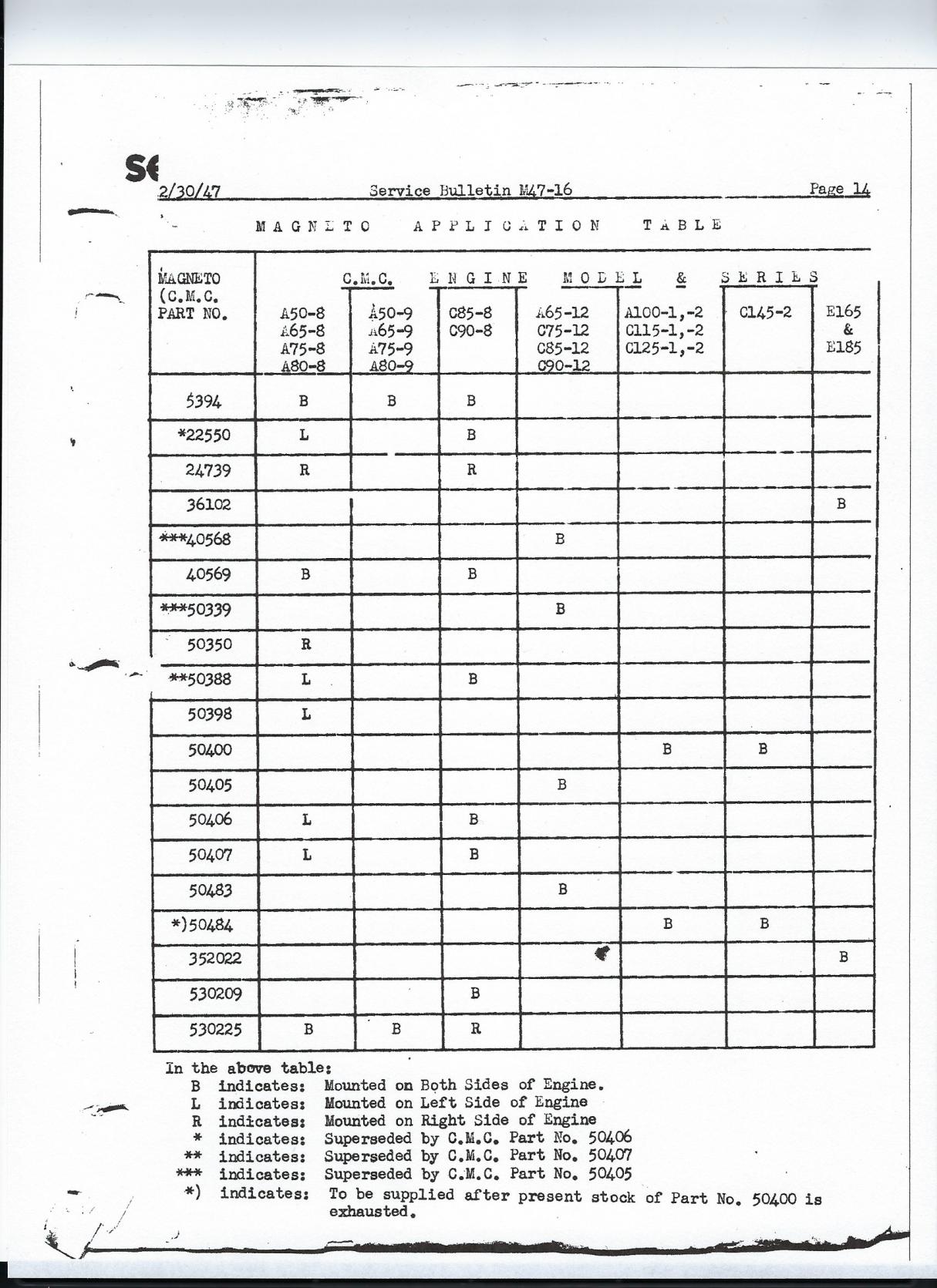

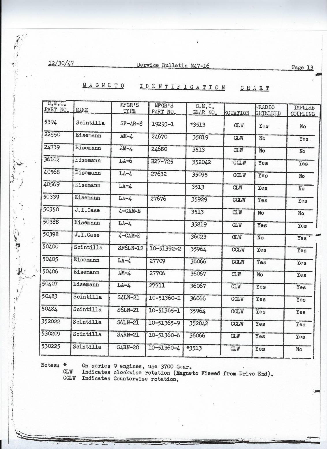

SF4RN-8 mags were non-impulse mags. S4RN-20 mags were non-impulse and S4RN-21 mags had an impulse. Both types of mags are approved on the A65-8 engines. Early accessory cases were made to accept impulse mags on the left side only. Late style accessory cases were made to handle impulse mags on both sides.

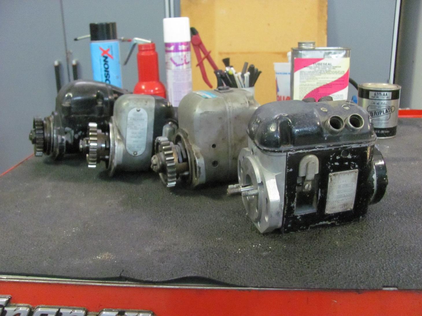

The SF4 magnetos are the little lunch box mags and the S4RN are the standard cased mag we use now days.

Picture of 4 mags approved on an A-65: left to right Case 47, Eiseman AM-4, Bendix S4RN-21, Bendix SF4RN-8Attached FilesLast edited by Garry Crookham; 03-04-2018, 16:02.
