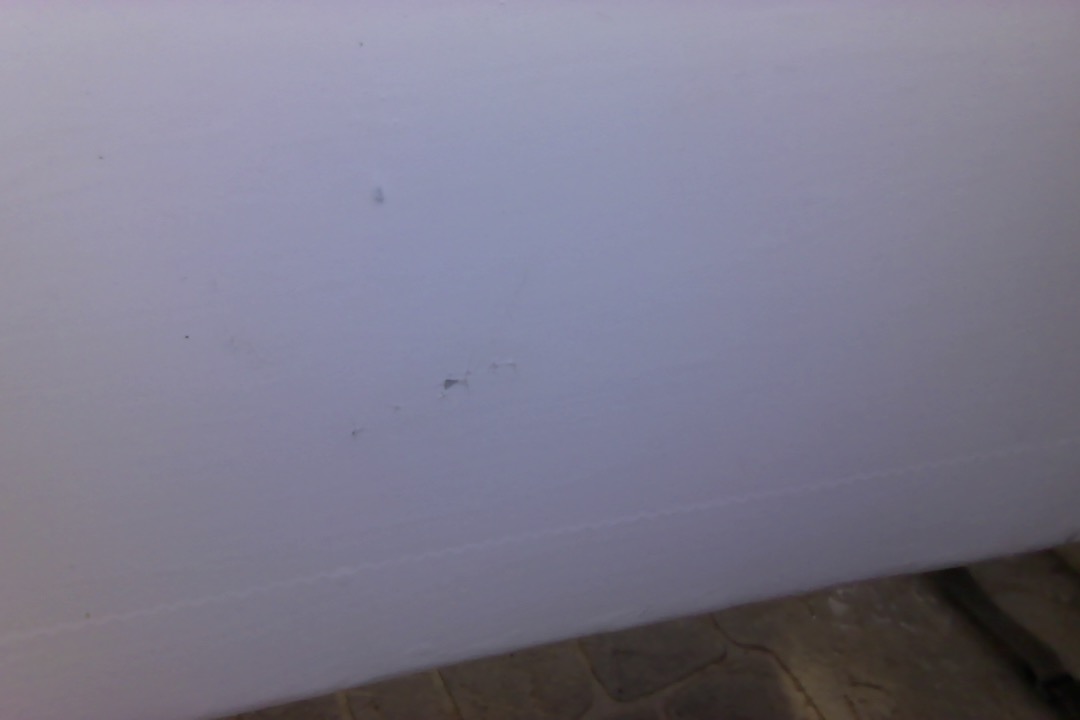

          Happy Old Year. I'll need to get some extra chemicals to see if it's Polytone or Aerothane. I would like to touch up some small prop wash chips in the fuse like the one pictured.

            I have used AC&S Exoxy super fill the blue one to fill in cracks in fabric and then sand it smooth then paint.
            I don't think this is legal but it worked for years.

              Perhaps in attempt to ensure we're on the same page.... the top coat is only for appearance as opposed to the silver which is critical. Most of this has been covered but I'll try to summarize the contrast.
              The objective from an airworthiness perspective, is to protect the fabric from UV exposure. Polyester fabric will last indefinitely as long as it's not exposed to UV. If not protected it deteriorates very quickly. With this in mind, the question is whether or not the "silver" aka poly spray (aluminized) coating is intack? This is where the UV protection comes from and is therefore the critical airworthiness element. If the silver is compromised in anyway, it needs to be put right ie 6 coats. Enough top coat needs to be removed to facilitate this silver repair.
              A secondary (non-airworthiness) consideration is appearance, small cracks and blemishes in the top coat only may be ignored and may actually be preferable over some touch up attempts! Generally non-urathane topcoats can be touched up and "blended" using solvents/rejuvenators. Urathanes need to be sanded. In both cases it's necessary to ensure the surrounding topcoat is firmly adhered to the silver and the edges need to be feathered if your going to spray.
              A very small area, with firmly attached edges can be touched up by building up topcoat with a small brush in several layers, then wet sanding it flush. Then it's like removing a scratch from a windshield.... use progressively finer grade wet paper until the tiny sanding marks can be buffed out with a fine polish. Larger repair areas can be blended in the same way. One technique, after the topcoat is sprayed, empty the paint gun and add half a cup of reducer to clean the gun but spray this mixture over the repair area and the surrounding areas. The reducer will help blend in the repair on non-urethane finishes. No effect on urethanes however.
              The repairs are pretty much always going to show, because colours change with UV exposure, batch numbers, and time, and urethanes don't buff well, but an adequate result can be obtained if you're willing to put in the time. Unfortunately cracks often appear over ribs which makes for very difficult work to ensure no damage occurs to lacing, fabric and tapes.
