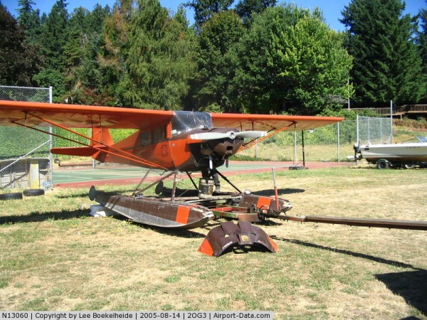

              actually it was an experimental on floats and the strut attach fitting is what failed, not the struts..
                Re: tapered axle landing gear inspection
                There were several who called it an "experimental" but that is an insult to experimental airplanes. It was several Taylorcrafts grafted together and from what some one with FAA and NTSB contacts said it was out of annual and had some REALLY screwed up paperwork. I think it was an instructor and student, both of whom were killed when the struts pulled out and a wing folded over the top.
                Nothing wrong with the safety of many of the "Frankensteins" out there (planes with mixed parts), but you can't mix un-airworthy parts from several planes and try to create a new one, then not properly maintain or inspect it. From what I heard, this plane had so many problems beyond the corroded out longerons and fittings I wouldn't have sat in it while chained to the ground.

                  Is this the individual who is being discussed? http://vb.taylorcraft.org/showthread...1344#post31344
                  There's a lesson here if so.
                      A picture of the plane involved.

                                If you saw pics of that airplane, it should have never been flying to begin with.
