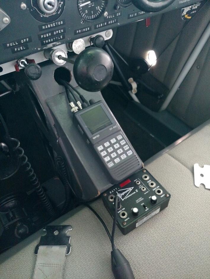

          I'm using a Sportys SP400 I upgraded to from an SP200 a year ago, it's excellent. I get 20-25 hours of battery life per module pack. Sigtronics intercom is 15 years old now, squelch performance is a balancing act but works ok. Very pleased with radio performance. Push to talk switch is on yoke.

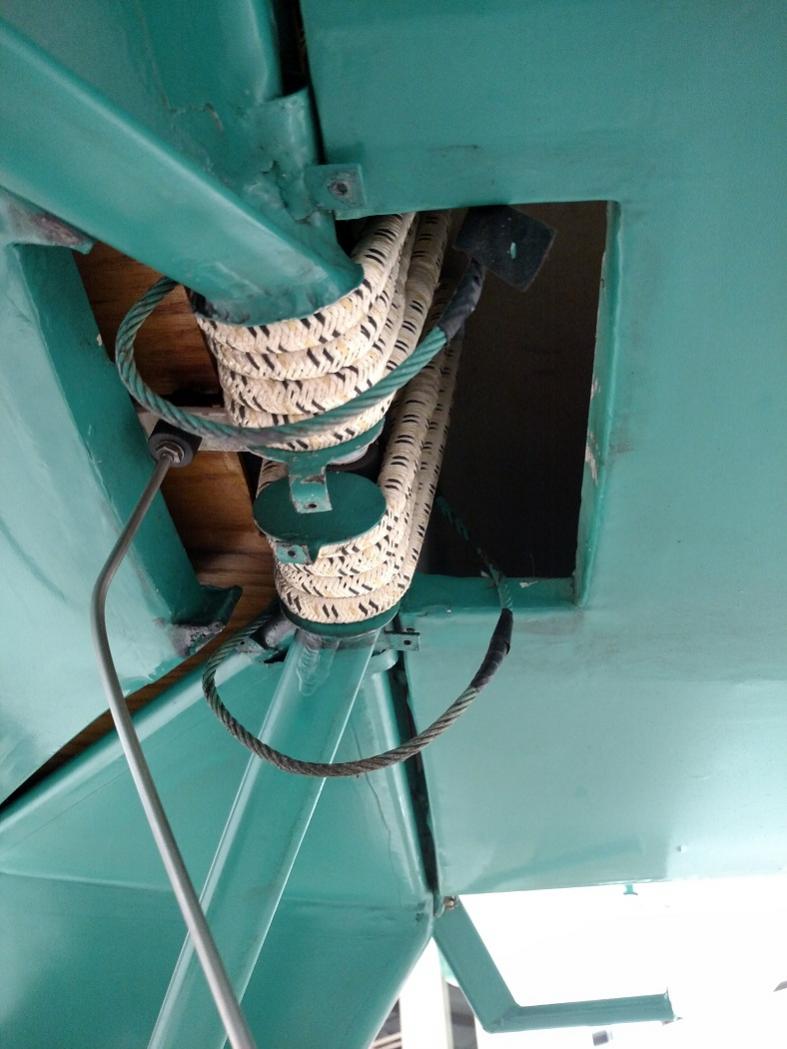

          Installed is an external antenna on a simple strap below the floor board with coax running up into the cockpit to the center console. The antenna hangs down at front of and between the shock cord fairings.
          In the flat Midwest at 2500' AGL I get loud and clear Unicom traffic (not the FBO) reception from 100 miles away and more, even though the antenna mount strap doesn't follow any ground plane design guidelines.
          Typically at 2500' AGL I'll get ATIS/AWOS 20 miles out. Tower RX is better.

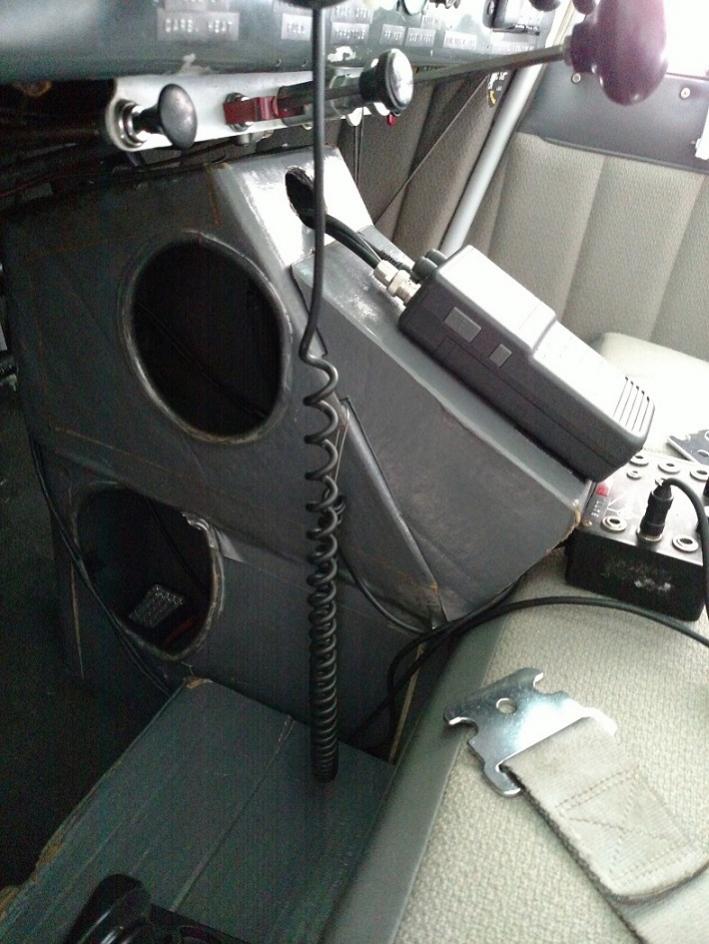

          For mounting when Dad had the aircraft he made a center console from out of cardboard painted grey. It has proven to be durable and weighs about a pound (it too is about 15 years old). He used 3 boxes and the lower is sized in width to hold a quart of oil sideways. It provides two storage compartments of ample room, it's as affordable and light as a console can be. It takes up space but is pretty handy.
          Radio has Velcro on back of the battery module and is held to Velcro on console. Spare battery module has matching Velcro. You don't have to undo the cables to swap battery packs.
          Hope it helps, Mark

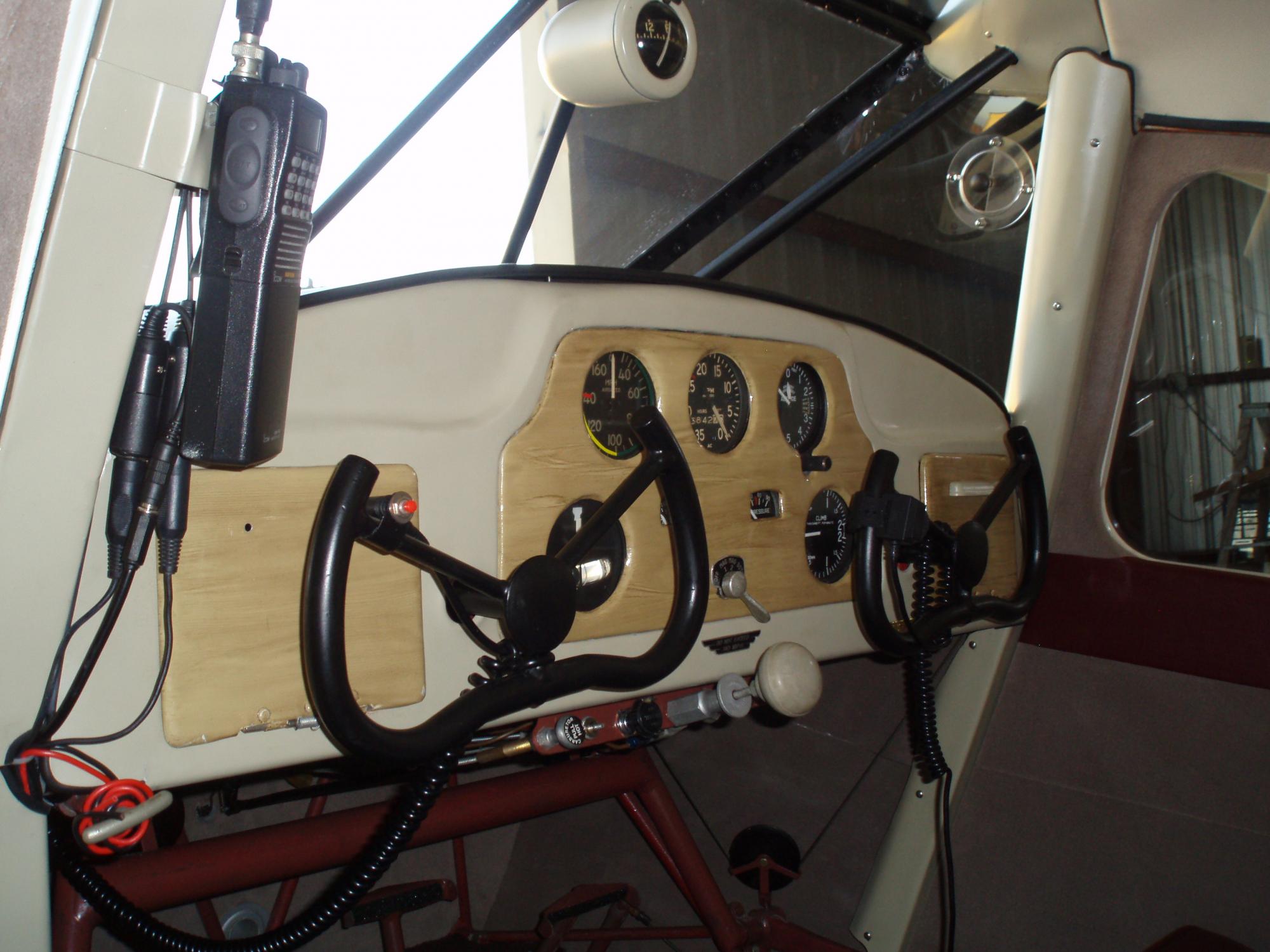

              I mounted my iCOM on the A Pillar with an aluminum bracket. With the A Pillar right behind it it doesn't impact visibility at all. I used an antenna extension cable to a whip antenna on the top of the fuselage close to teh aileron cable area (KEEP THE CABLE CLEAR OF THE CONTROL CABLES, but DON'T coil it!). Very easy to see and use there and I usually tuck the headphone cables up on top of the glareshield, not hanging down like in the photo.
