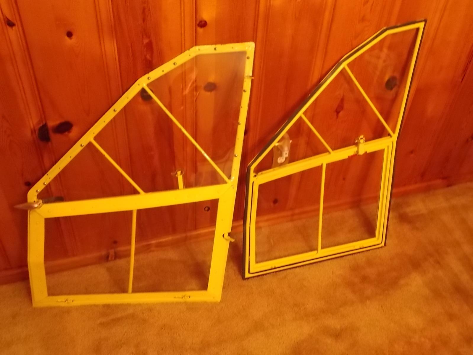

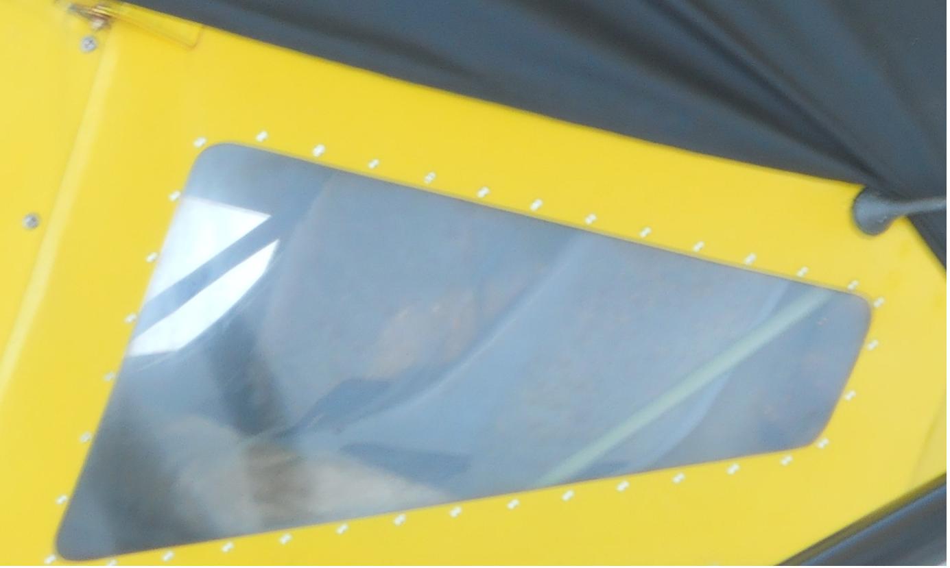

These are the doors that I want. Will B model doors fit an F19?Originally posted by Dick Smith View PostLexan is extremely tough, but it is subject to "crazing" if exposed to gasoline. I was told by the supplier that the coating on Lexan would protect it from "crazing", but when you cut it to shape and drill holes for fasteners, you create uncoated surfaces. I've replaced Lexan with Plexiglas after dealing with damage caused by gas splashing or dripping. Here in Alaska we do much of our refueling using other than hose/nozzle setups. It's easy to get gas on a skylight when using a chamois/funnel setup in windy conditions...the same on the extended side windows or door cutouts, when checking for water in the wingtanks. Lexan is super strong, but I don't use it on my plane any more. Another point...when drilling holes for screw or poprivet attachment of your choice of glazing...leave room for expansion and contraction around the fasteners...otherwise you "will" be dealing with cracking of the plastic, radiating from the holes. Also, I found that it worked best to have the plane's door closed when attaching the glazing...at least when placing the sheet against the door and determining where to drill the first holes. The original door has a built-in "form" to fit the shape of the fuselage. The factory door holds it's rigidity because of the way it's riveted together, but when you remove the portion where the plastic sheet will go, the remaining metal frame goes a little "flat". If you lay out the plastic flat and fasten it to the door with screws or poprivets...when you close the door and latch it, the plastic is stressed when adapting to the "twisted" shape. Stress equals cracking around vibration. I closed the door and held the plastic in place while attaching the plastic at one corner with a Cleco...then helped the sheet to lay where it needed to, in order to match the frame "twist". If you "help" the plastic conform to the closed-door "twist" and THEN attach it, you will reduce built-in stress. Just a few thoughts...hope they help. DickCatch the fish, to make the money, to buy the bread, to gather the strength, to catch the fish...
Re: plexiglass doors
Don't know about the later models, but on the early ones you need to "finesse" the doors to switch between planes in the same year. You should plan on putting the Lexan on while the door frame is ON the plane with the door closed. If it turns out to have been unnecessary, well, you didn't loose much time. If you do them off the plane and they don't close smoothly, you will have to start over.
Murphy says put them together using the fuselage as a fixture.

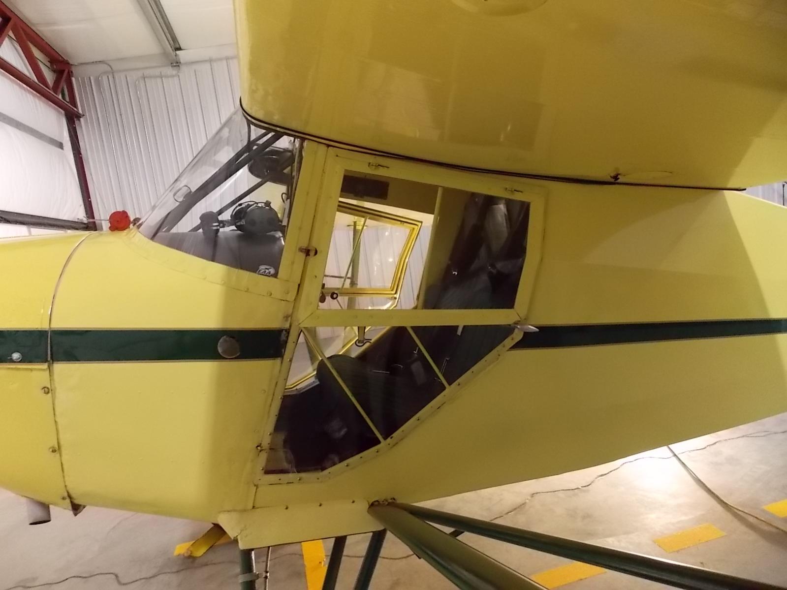

I did the tube doors on 26658 with clear plastic the tube door has a flange that is the sealing surface.My door had sheet metal covering on them that was riveted on that is why there is all the holes on the frame.I used some of them for the PK screws that hold the plastic on.IA that i use said the door should be covered but he could not find any reference to what it should be covered with only covered.Also used a bead of clear silicone to seal it to the frame and it extends up under the window.Attached FilesLast edited by cvavon; 09-05-2016, 06:03.1940 BLT/BC65 N26658 SER#2000

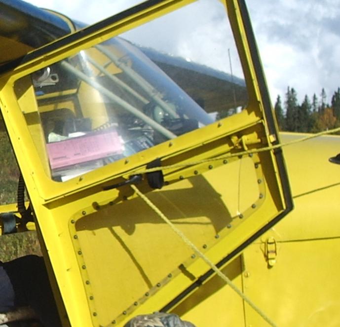

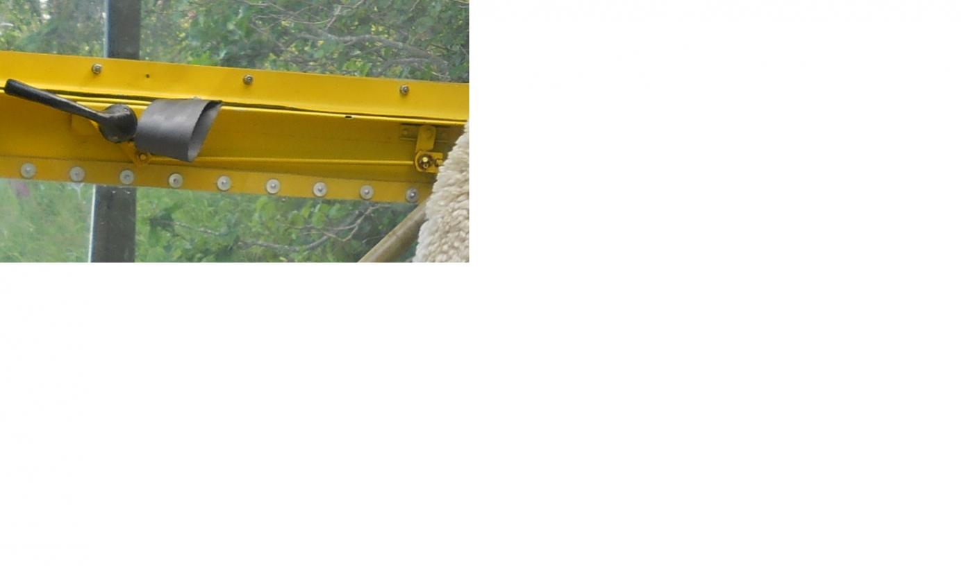

Re: Patroller Doors: I got to thinking about some of the doors I've seen up here. I've observed some that had a larger cut-out than the one on my plane. It seems to me that the door can be made a bit flimsy if you make the margins too narrow. You regain quite a bit of stiffness when you replace the Aluminum with the plexi or Lexan, but we all know a passenger can try closing (ie. "Slamming") the door three times before you can say "Stop"!! I measured my cutout this morning...the remaining aluminum is 4.25 inches wide on the top and 3.25 inches on the front, back and bottom. I turned the inside door handle around to point forward, thinking that in a crash you might slide over it a bit, rather than totally snag your arm on it. I fastened a loop made of seatbelt webbing in a gap between the upper and lower frame members with a screw. I can reach across, passenger or not, put my finger through the loop and latch the door by pulling on it "just so", easier than I can work the door handle and "feel" for the closing action. Also used the shortest poprivets that would go through the door skin, the plexiglas and a thin Aluminum washer( as used to hold down reinforcing tape on wing fabric). Here again...trying the create a method of fastening with proper set, but minimum height, to minimize the "rasping' effect in a pileup. I saw a patroller door with small screws and washer/nut fasteners that just looked and felt like it would really bite you. I've slid my arm along my own rivet type fasteners and and decided I would rather be bitten by them than by screws!
On the older style of door like Chuck Avon has, the square tubing is welded into a pretty rigid frame and seems to take a piece of plastic sheeting just fine. I've seen quite a few done like his, both one piece and two piece(with a hinged swingup window).Last edited by Dick Smith; 09-05-2016, 18:20.Dick Smith N5207M TF#159

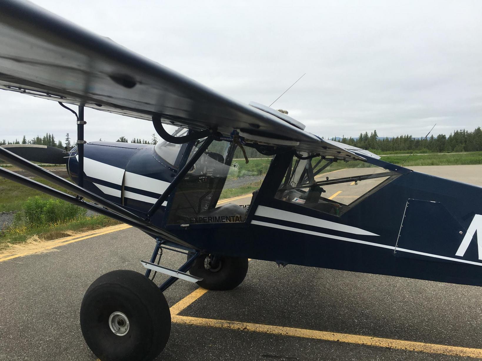

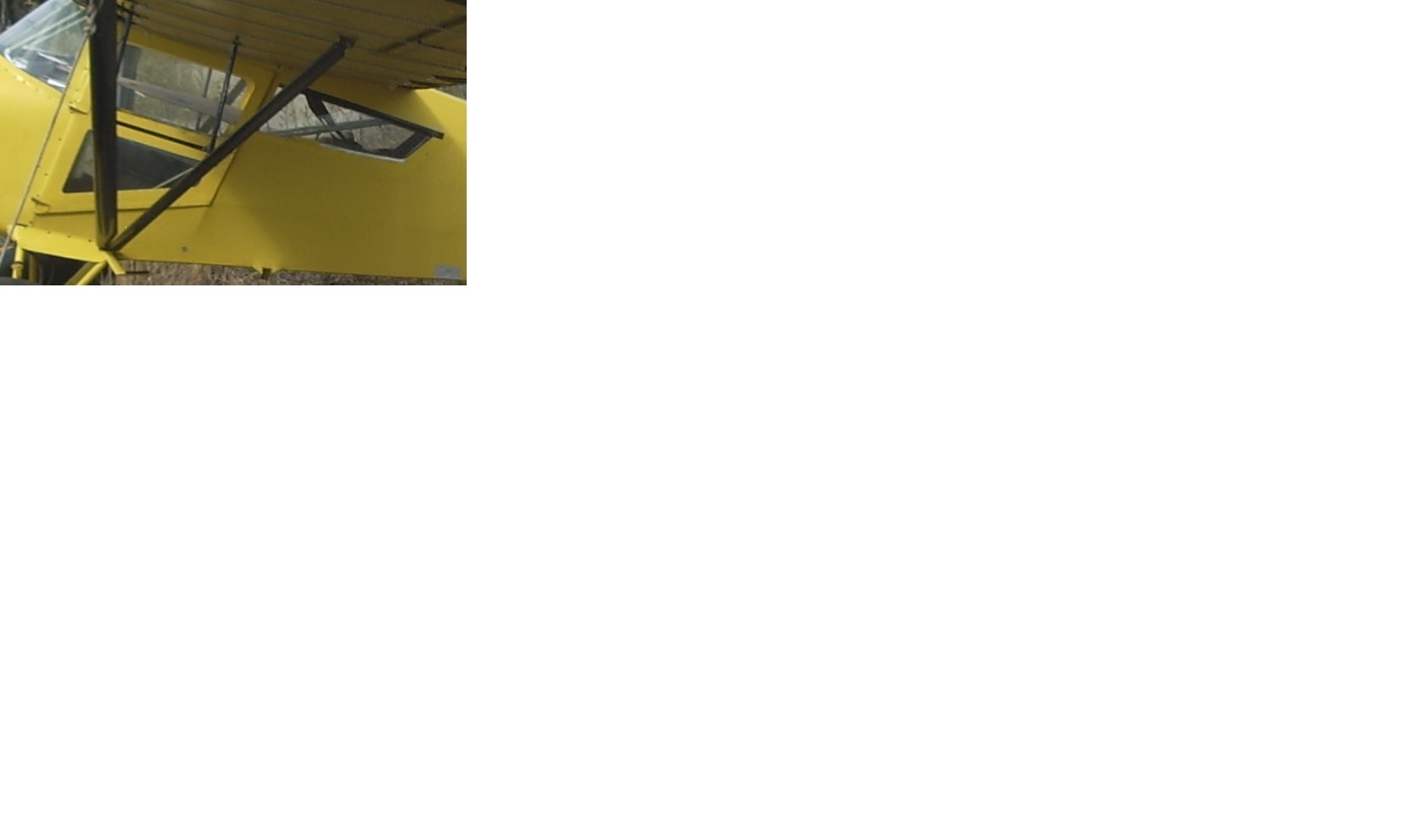

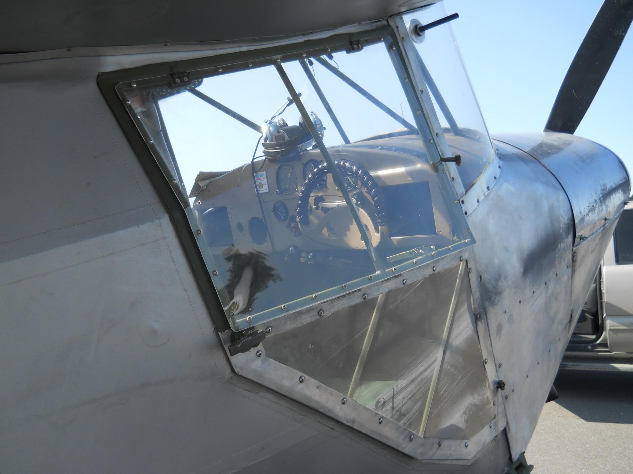

Below on the left is a picture of a Taylorcraft you CAN see out of...! Of course it's experimental! The right pix gives a sense of the "openess" that I like.Last edited by Dick Smith; 09-07-2016, 09:20.Dick Smith N5207M TF#159
