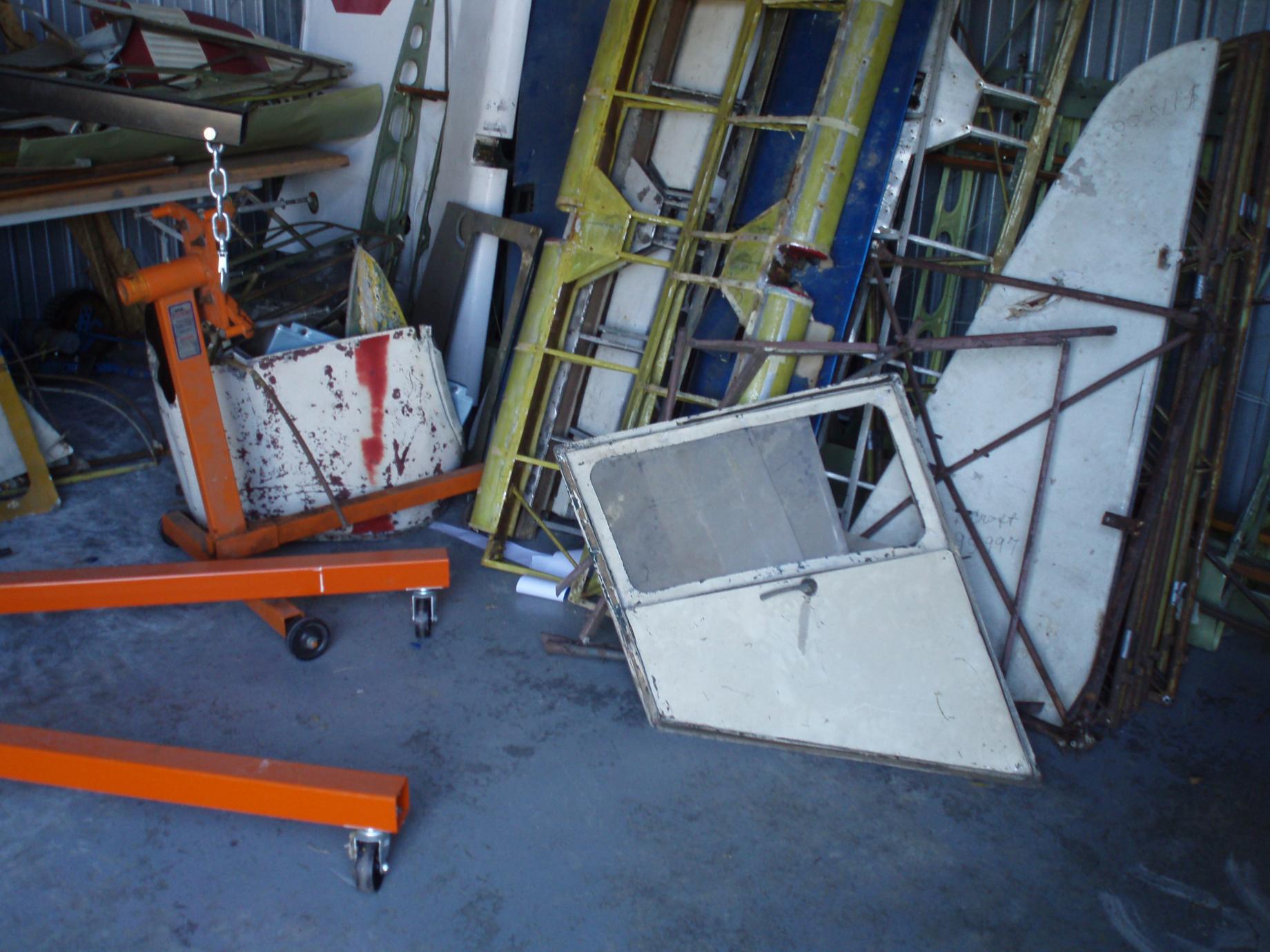

    The outer "glass" is in front and inner one is at the rear. I have lots of photos and a pile of sheet metal doors in the hangar. Several guys have used the "woolly" part of Velcro as the slide part support. One of the nicer doors I saw someone had glued a round piece of Plexi about an inch long to the lower front corner of the front glass as a handle. You can put a loop of cord on the door and hook it over the knob to hold it shut, although the Velcro felt does a pretty good job of holding it in place with light friction.
    Too bad you are so far away. You would be welcome to browse the pile all you want. Let me know any detail shots you need and I will try to find a door to get a good shot.

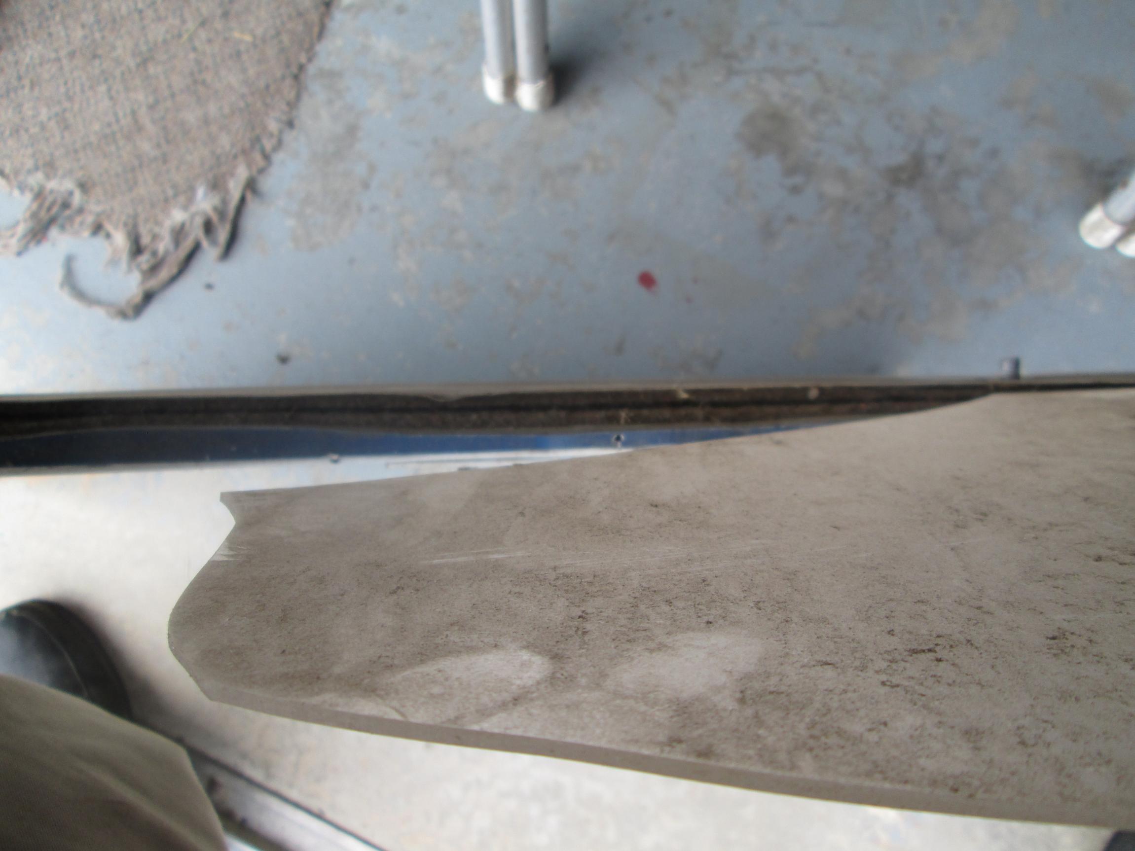

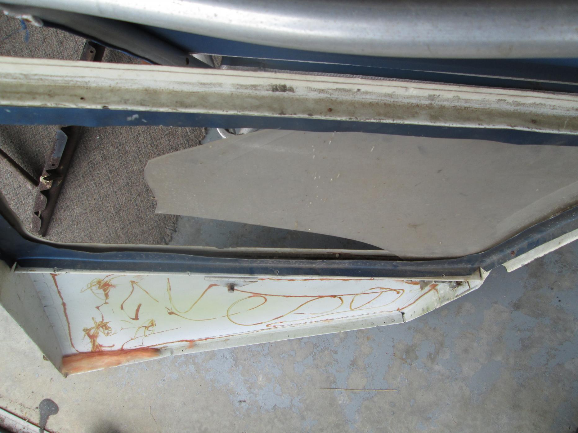

              I have seen some where both slide and I think that would be really handy. From looking at the doors I think you would want felt or Velcro "wool" between the pieces of Plexi, top and bottom, to keep one pane from scratching the other. That would cause you to have a small gap that would make for some wind noise. I think you could solve that by putting a thin vertical strip on the outside front of the rear glass and the inside rear of the front glass. When the windows are both closed they would seal against each other, but when open the thin strips wouldn't touch the other glass.
              I would NOT put felt top and bottom on both pieces of glass where they touched in the slot the glass slides in. The felt would make it REALLY HARD to move the glass if there was two layers touching except at the vertical seal between the pains.
              I will need to get some close up photos of the window slots next time out. These may not show much detail.
