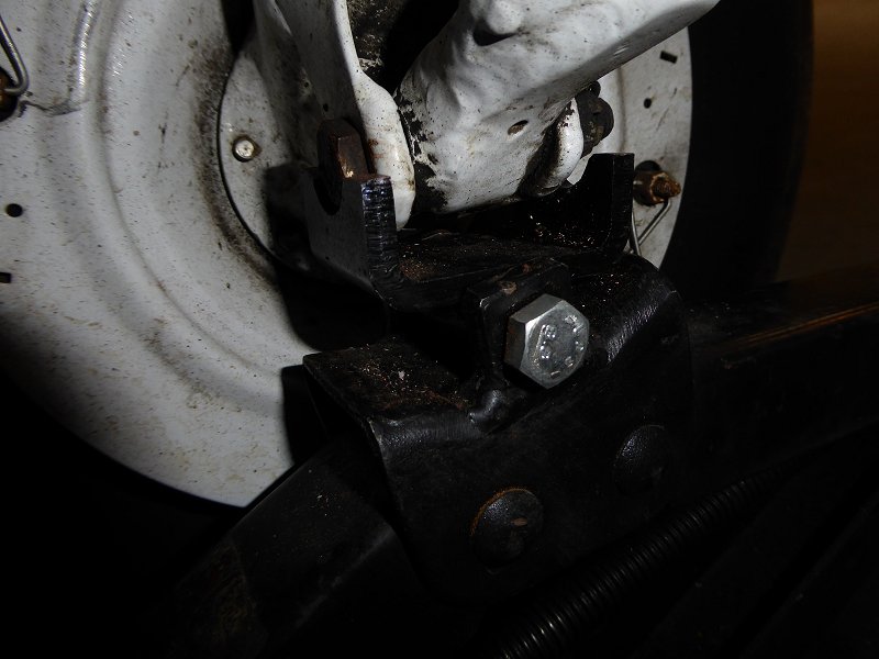

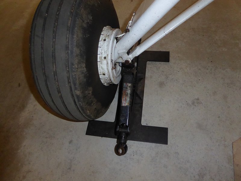

            A friend here made me a simple and safe jack from an old scissor jack. Very stable, and can also be used on Pitts Specials and other aircraft. Hopefully the photos explain themselves.

              Rob,
              I am betting that your friend is a retired mechanical engineer. Am I correct? Was I close?
              Very nice jack by the way.
                Re: Tire Change Time
                Almost..he runs a fabrication business and has owned a Taylorcraft or two.
