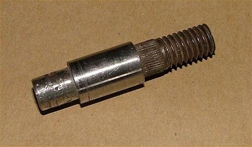

    I'm looking for parts that drives the trim system which is overhead in the cockpit. It has the crank on the bottom and pulley and tell tale on the top. All I have is the handle and pulley. What I need is the shaft and tell tale parts. Any help out there?
    Re: Shaft for trim tab system needed
    Hello Bruce:
    I have the shaft if that helps (see photo). If you'd like it, it's yours for the shipping cost from the UK, unless you can wait until May when I can ship it from the USA.
    You can see the spline where the pulley fits. The crank fits using a cotter pin or scroll pin at the left-hand end.
