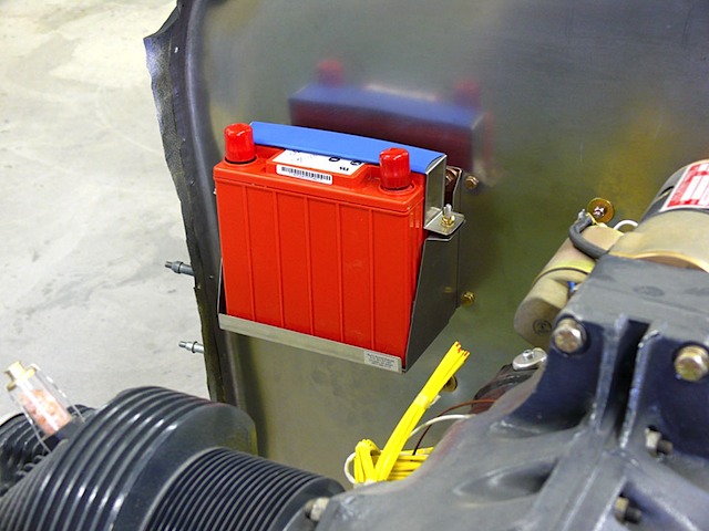

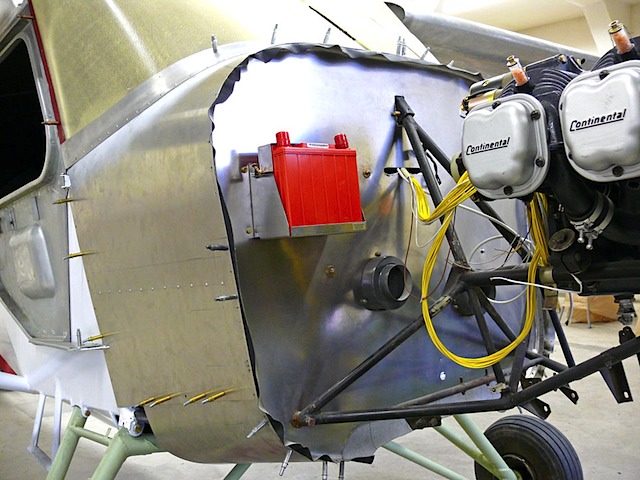

    Forward, using a burls box (from birchwood). Has a heat shield and if its good enough to mount a cessna battery on the firewall, good enough for me. Tim
    burls box on an aeronca without the heat shield.
      Re: Need an opinion from experienced engine rebuilders
      The original FWF battery boxes were enclosed by metal and probably sunk excess heat into the firewall/boot cowl. Also most were conventional heavy lead acid which took time to show a rise in temp. I've had a FWF AGM in Burl's on a PA-12-180 (Crosswinds STC) and never had an apparent (via signs of melting or shortened life) problem. The advantage was any pre-heat or flying in winter also warmed the battery some so it discharged/charged well, unlike aft mounted ones that stayed cold all winter if in a sealed box. The underseat mod or exposed AGM's will pick up some heat from the cockpit.
      Still I'd put a remote outdoor probe on the FWF battery for the fun of seeing any rise in temp above the manufacturer's rated value. But that's just me and not any specified procedure.
      Gary
