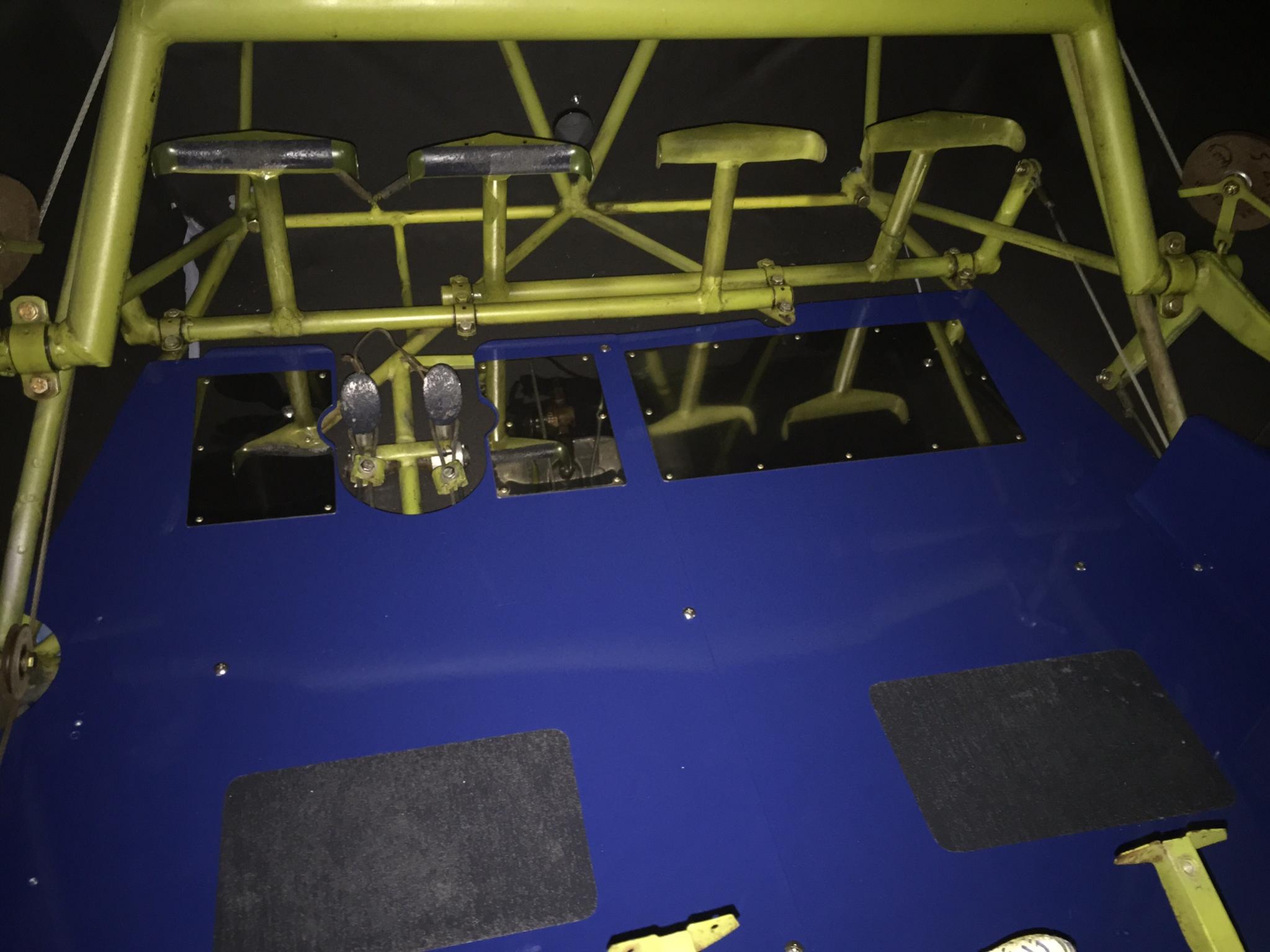

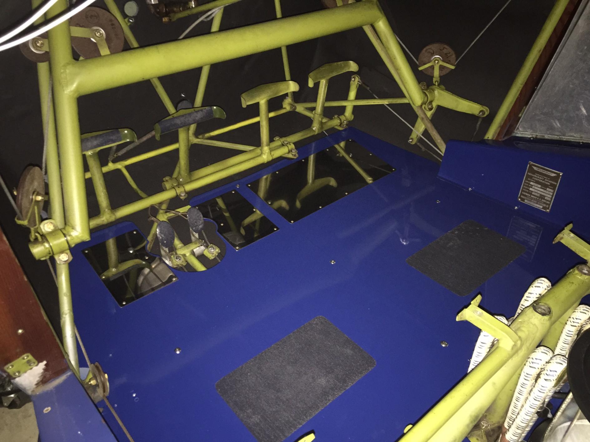

Does anyone have a drawing or photos of the parking brake installation at the firewall/brake pedals?

It looks like you may be missing the little nub that the end of the parking brake cable goes in. On the small tube that goes forward from the brake pedals there should be a 1/2-3/4" long small diameter tube welded parallel to the side of it to hold the cable end. Every place else the cable os just tied to the airframe with lacing.
