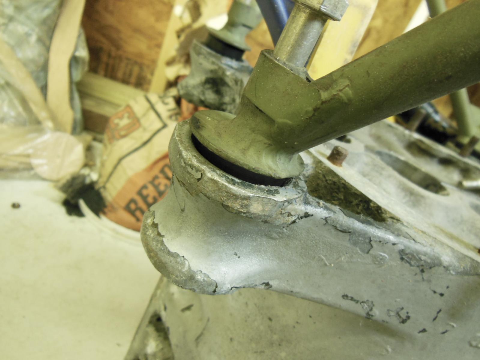

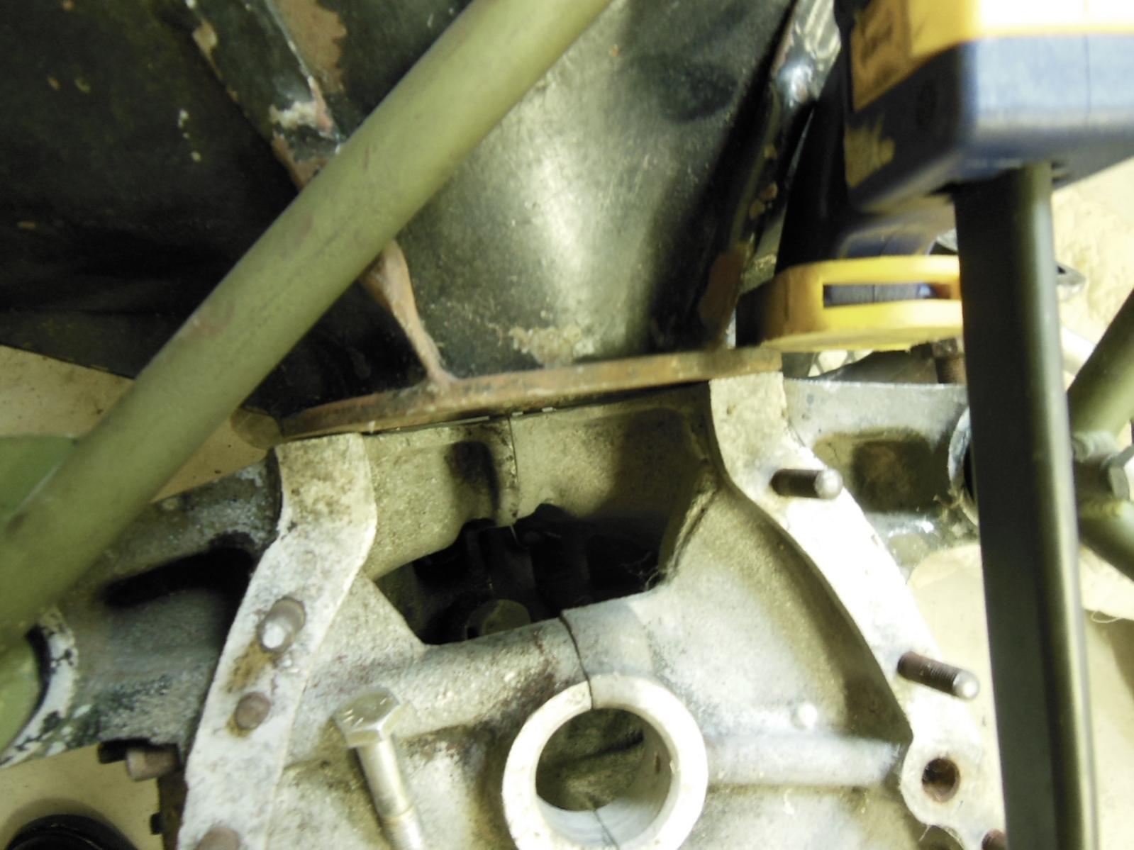

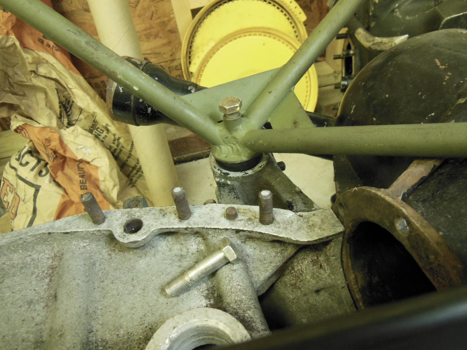

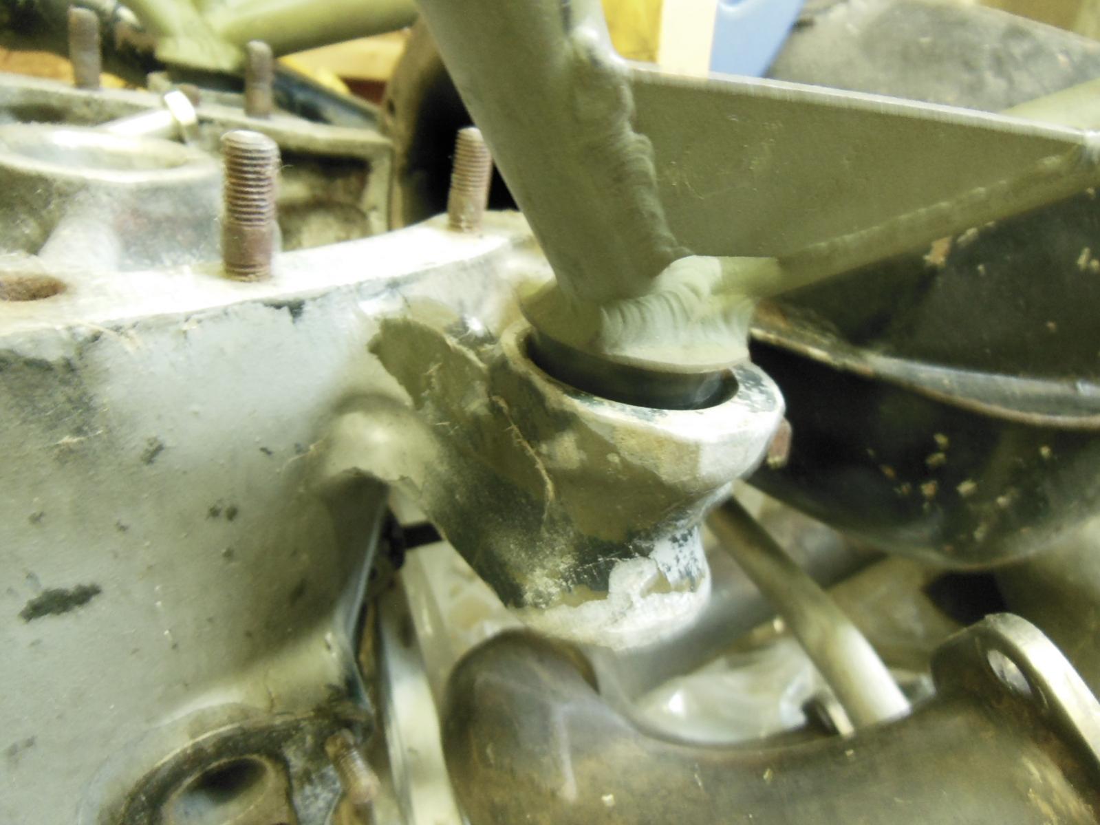

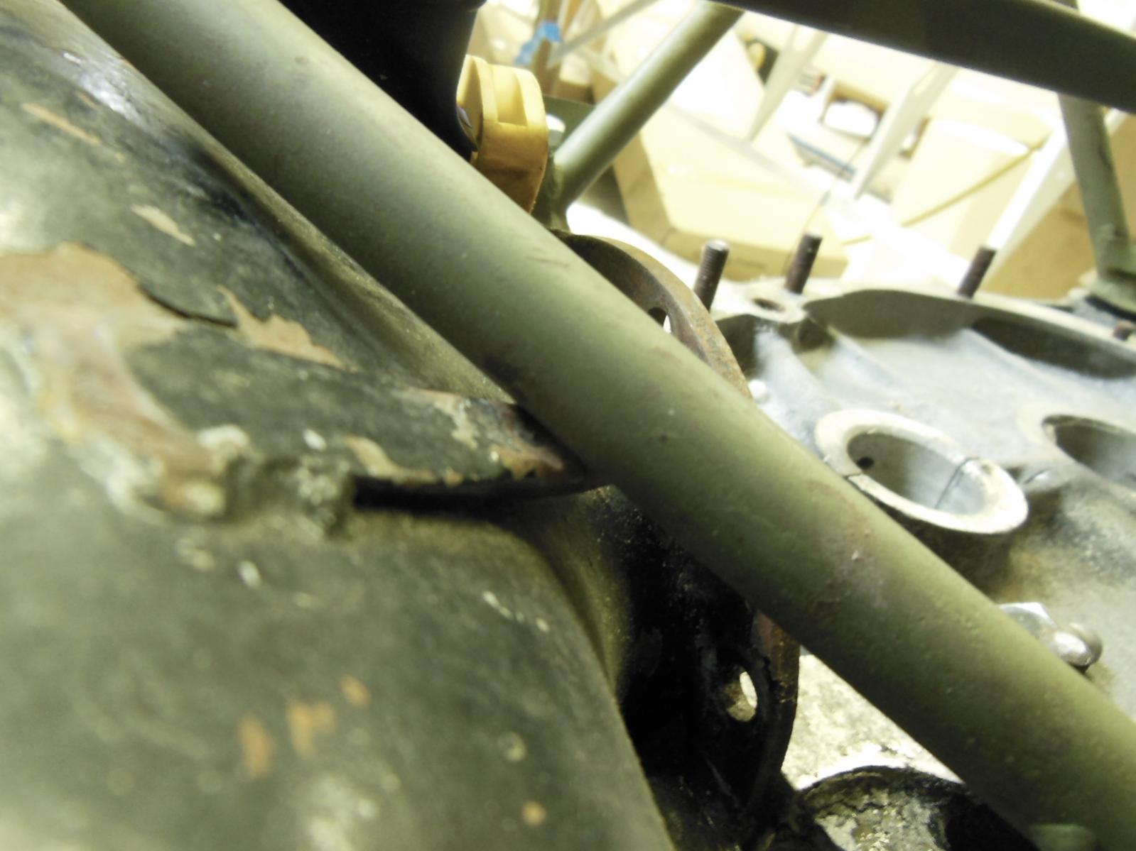

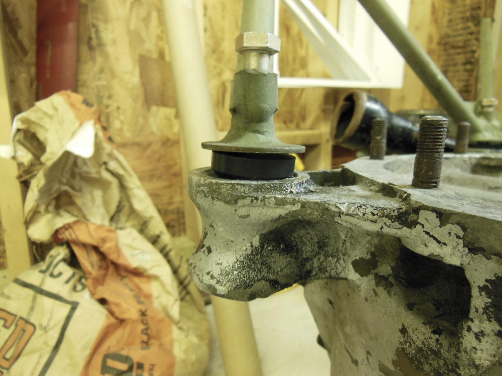

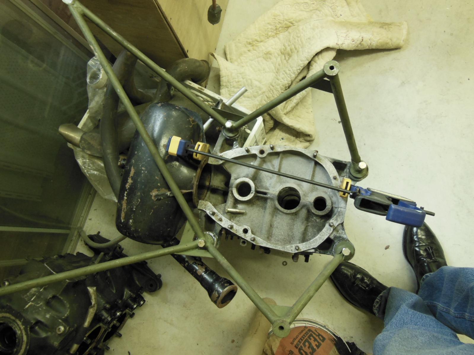

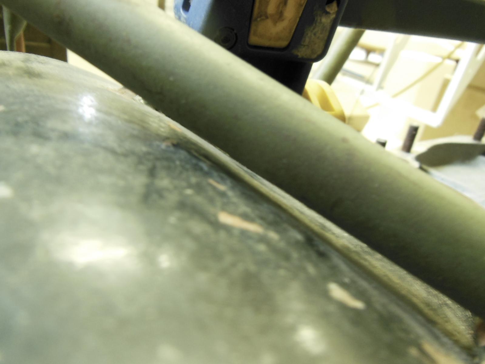

    The interference is shown in one picture with the little support arm, mount bolts are not tight, the interference would prevent tightening, tank is not tight but in correct placement.
    My other 0-200 tank does not have the little support arms at the neck so it likely does not interfere.

      Dave, since that is the 65/85 mount, the o-200 would move it 5/8" forward, it should clear, right? Tim
        Re: Oil sumps
        That makes sense and I agree. It is still set up. Later today I'll fake a 5/8" recess and verify it though.

              The 4.5 Qt tank that is on my c85-12 had the support arms off the flange and to get it to clear we cut one off and had the clearance we needed.

                Tim it has lots of clearance when you insert another 5/8" between the mount and the case.

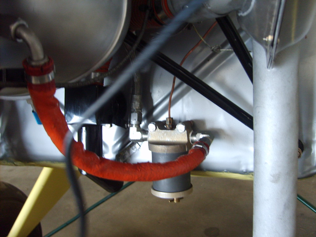

                    Tim.. Here's the installation, 0200 with short mount.
