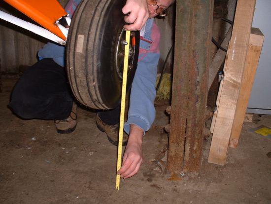

I'm sure this subject has been discussed but here's another. I was made aware in conversation of a fellow T-Crafter that recently experienced an engine stoppage after takeoff. He mentioned the fuel level in his BC12D-85 was less than half in the main tank, possibly closer to 1/4...I'm not sure and didn't check. He runs approved 29" tires and I assume a normal tailwheel. Airframes has approval for tires to 31" assuming "heavy duty" brakes are installed (http://www.airframesalaska.com/Alask...els-s/1477.htm - http://www.airframesalaska.com/v/vsp...reak%20AML.pdf).

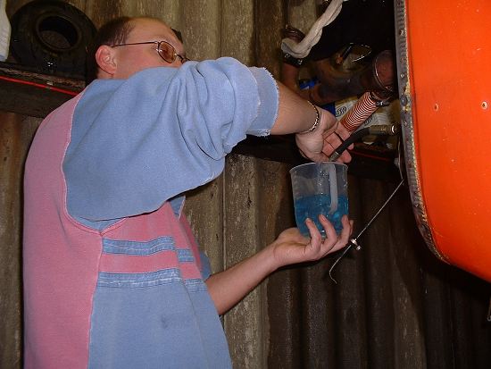

For any debris in the main tank, fuel filter, carb finger screen, or float bowl.
The internal diameter of the supply lines.
The relationship between the carb inlet and fuel level in the tank at that time on the large diameter tires, and after take-off in a normal climbing attitude.
As far as I know for the C-85 and 0-200 1A9 TCDS notes a limit of useable fuel (9 gallons; which implies 3 are unusable in certain condx), and that only applies to model 19's and F-19's, which are to be placarded accordingly. A-696 or others don't mention a fuel minimum. However the AOA versus fuel head pressure and flow availability may have been compromised prior to the actual takeoff (my suggestion only).
