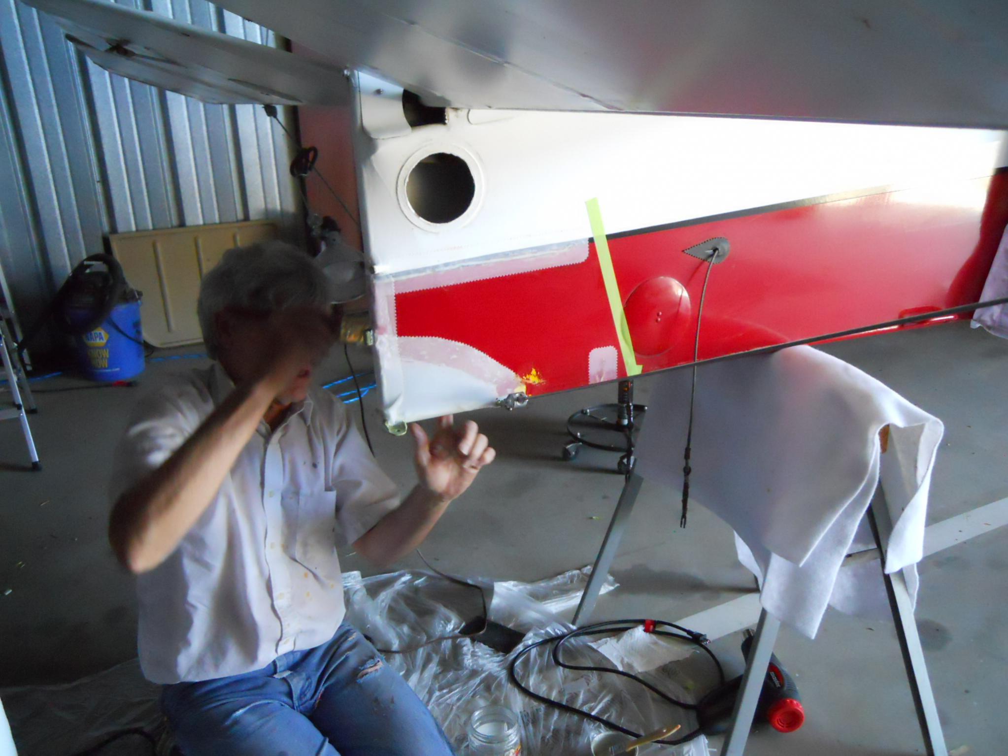

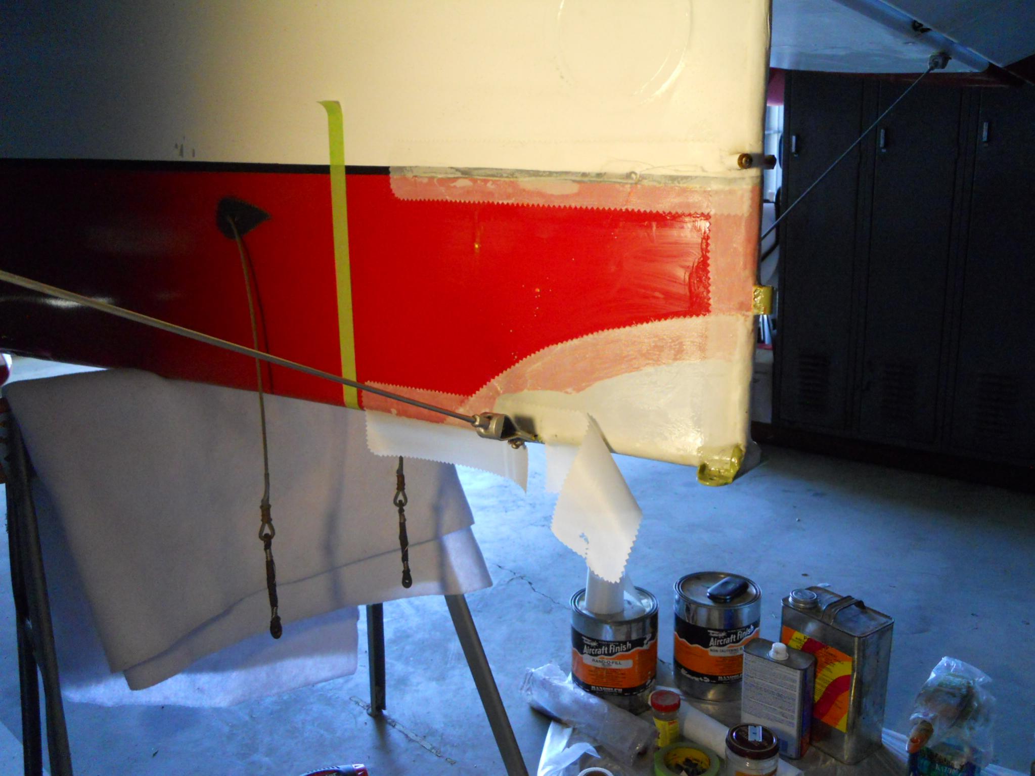

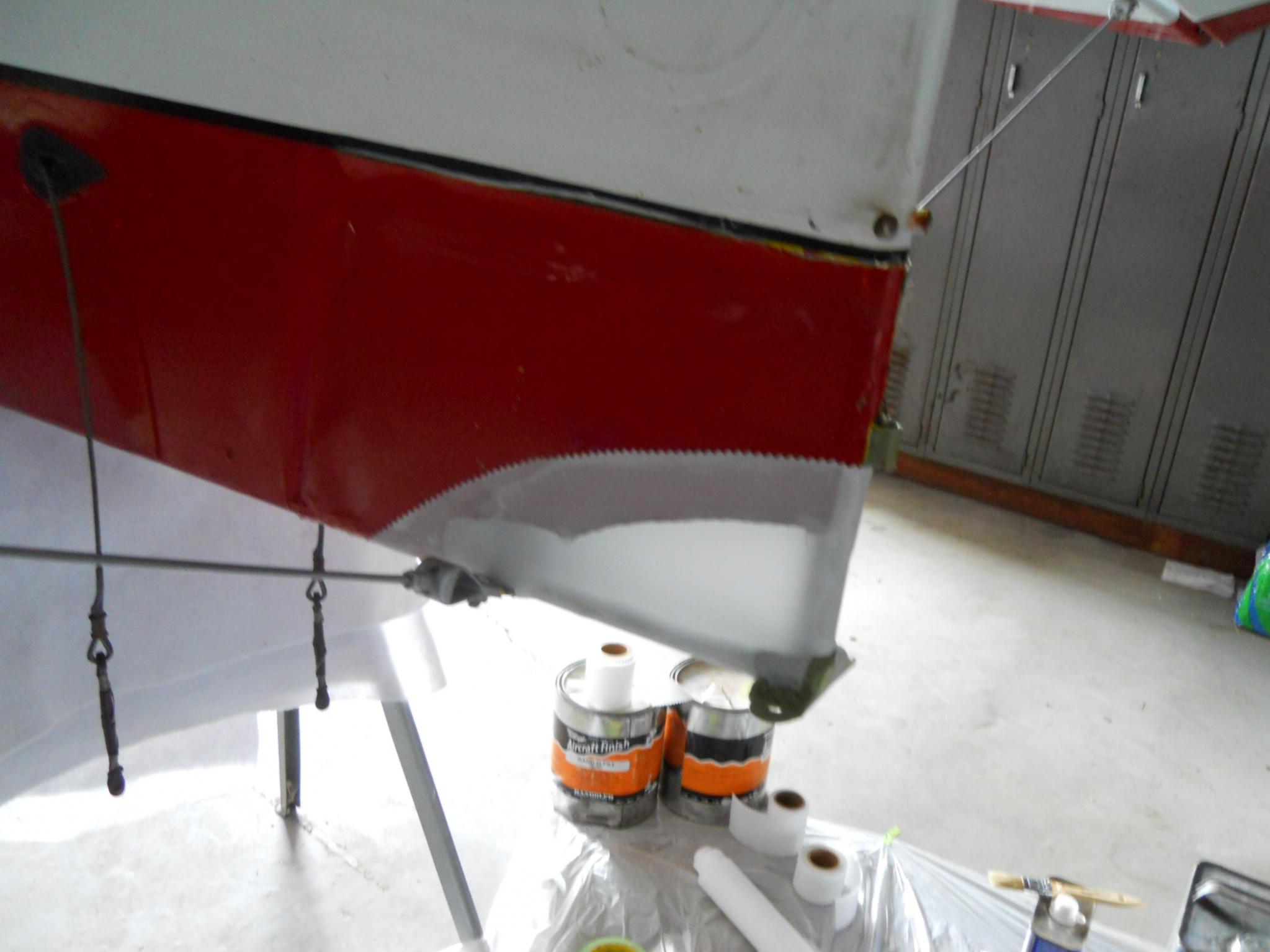

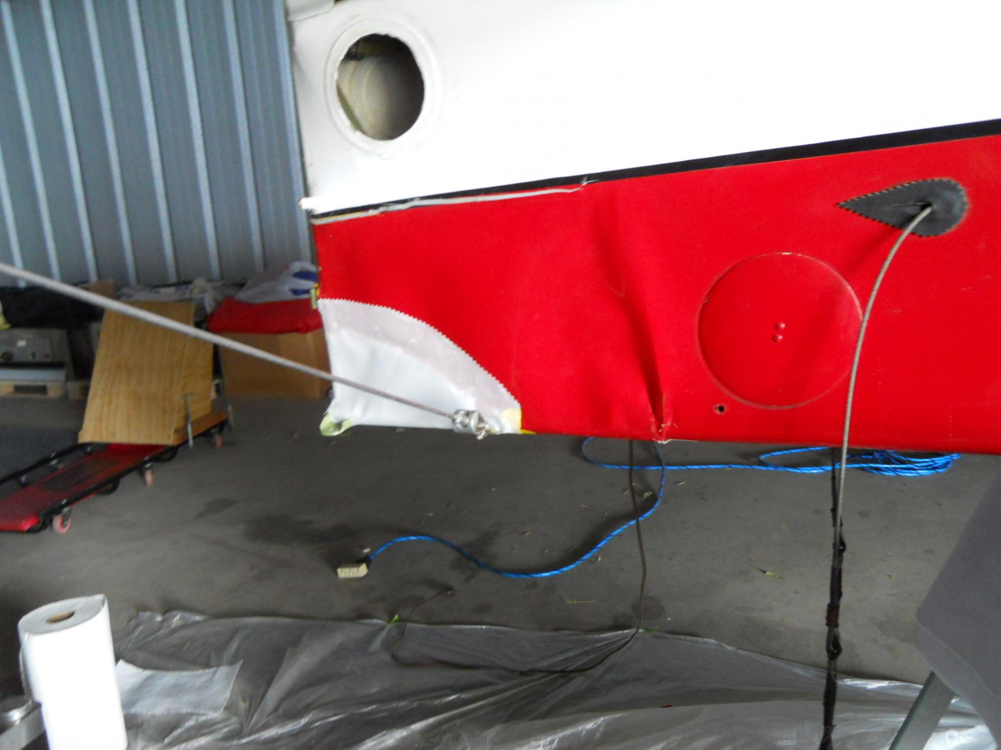

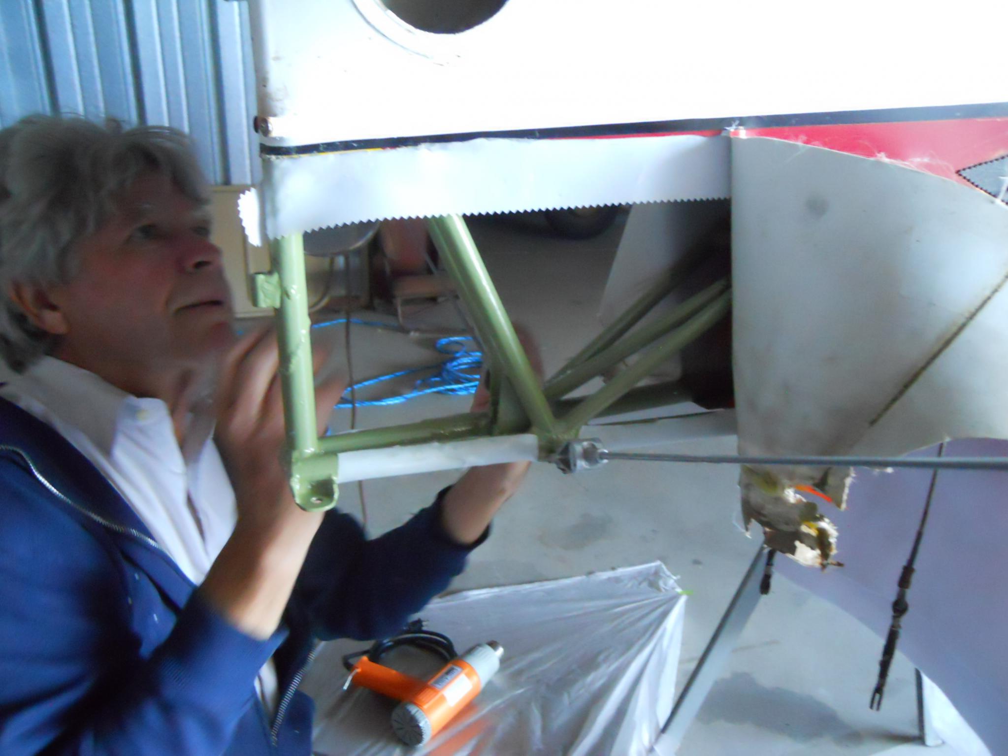

                    Here is a up-date on the fabric repair. First photo shows adding a 3" tape behind the cut line and new fabric on the belly area. The other photos should be self explanatory.
                      Re: Tail Post Damage

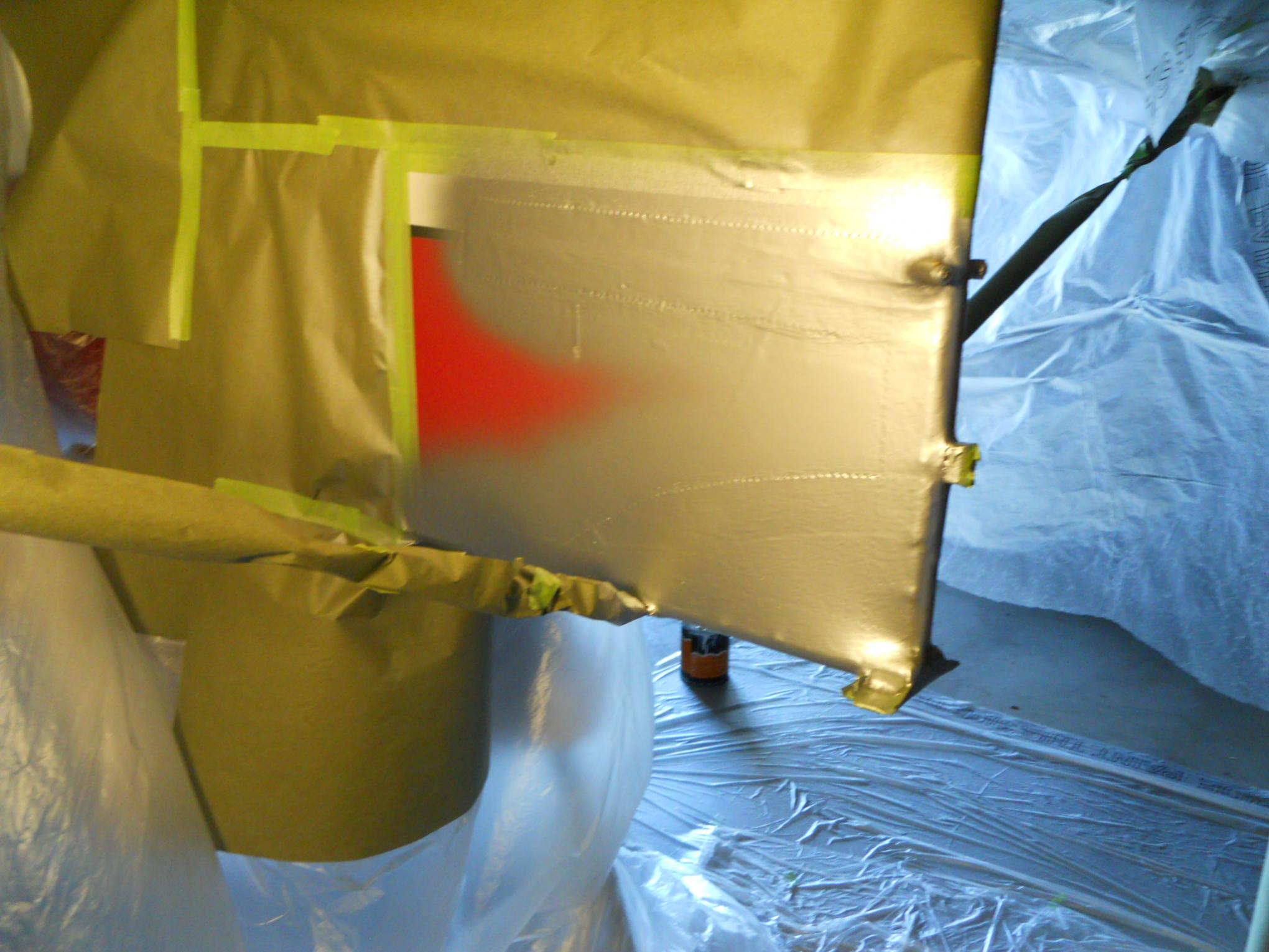

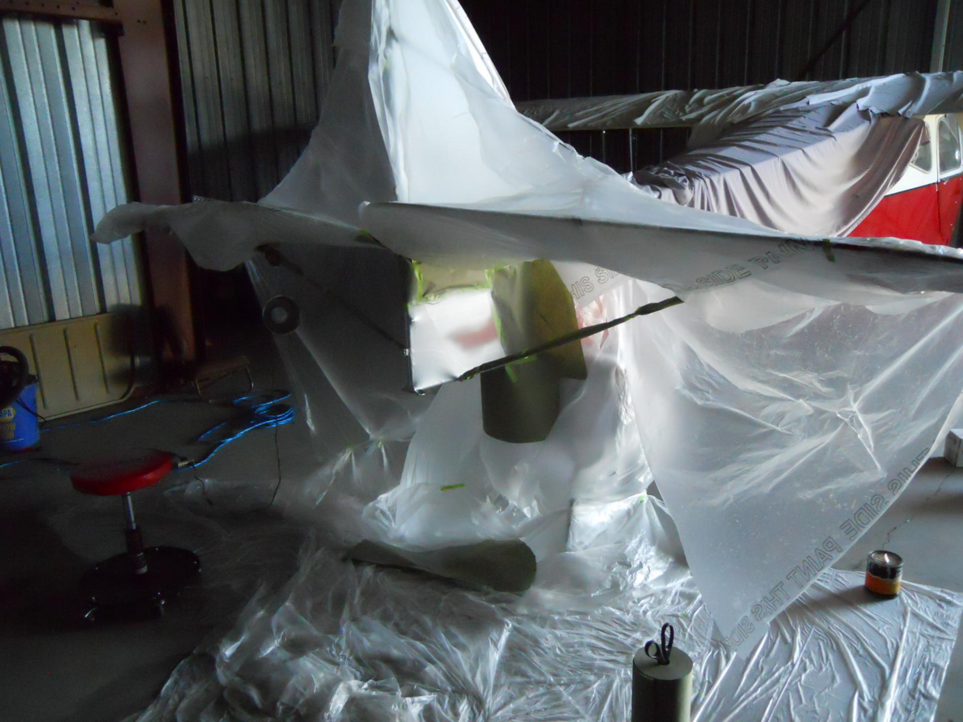

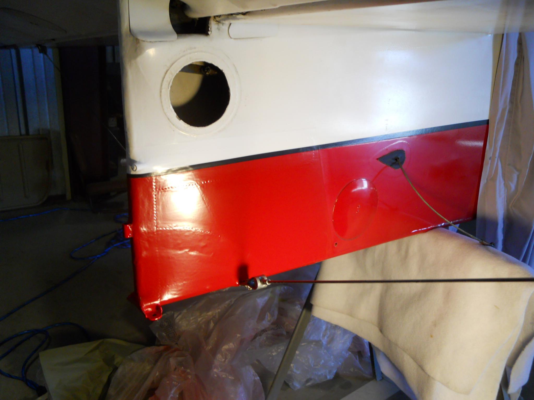

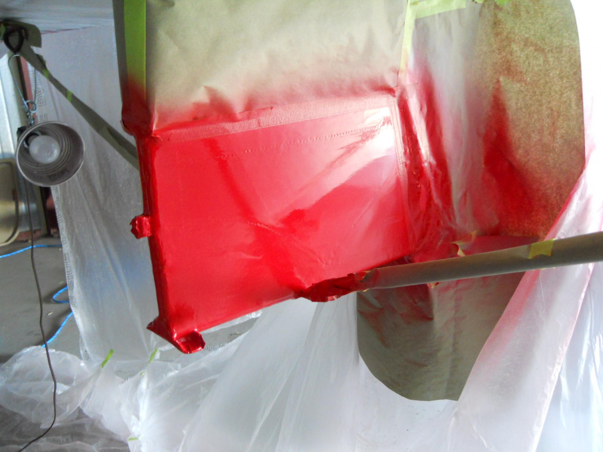

                      Here are a few more photos of the fabric repair thur silver. Next is painting white and then the red.

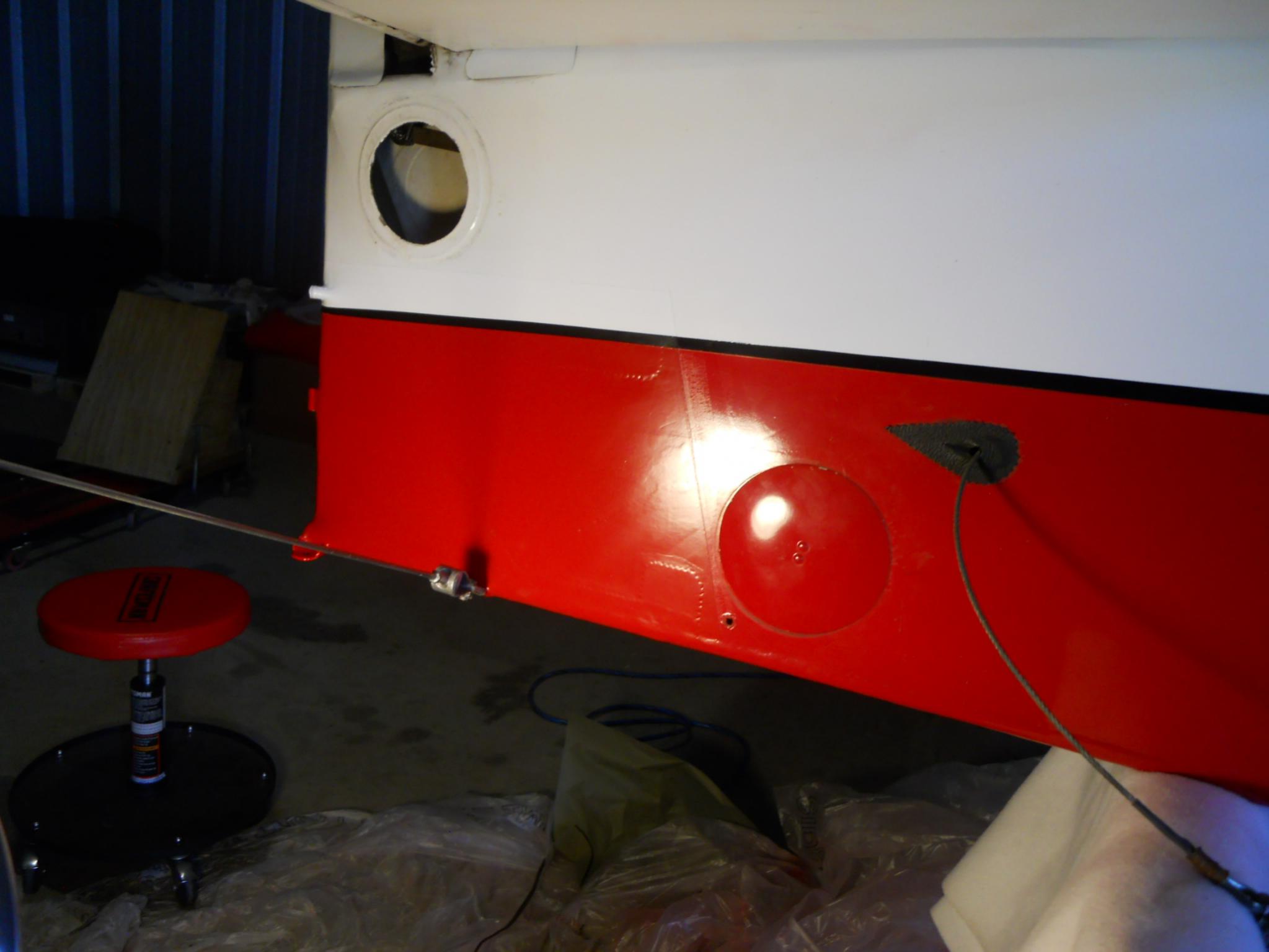

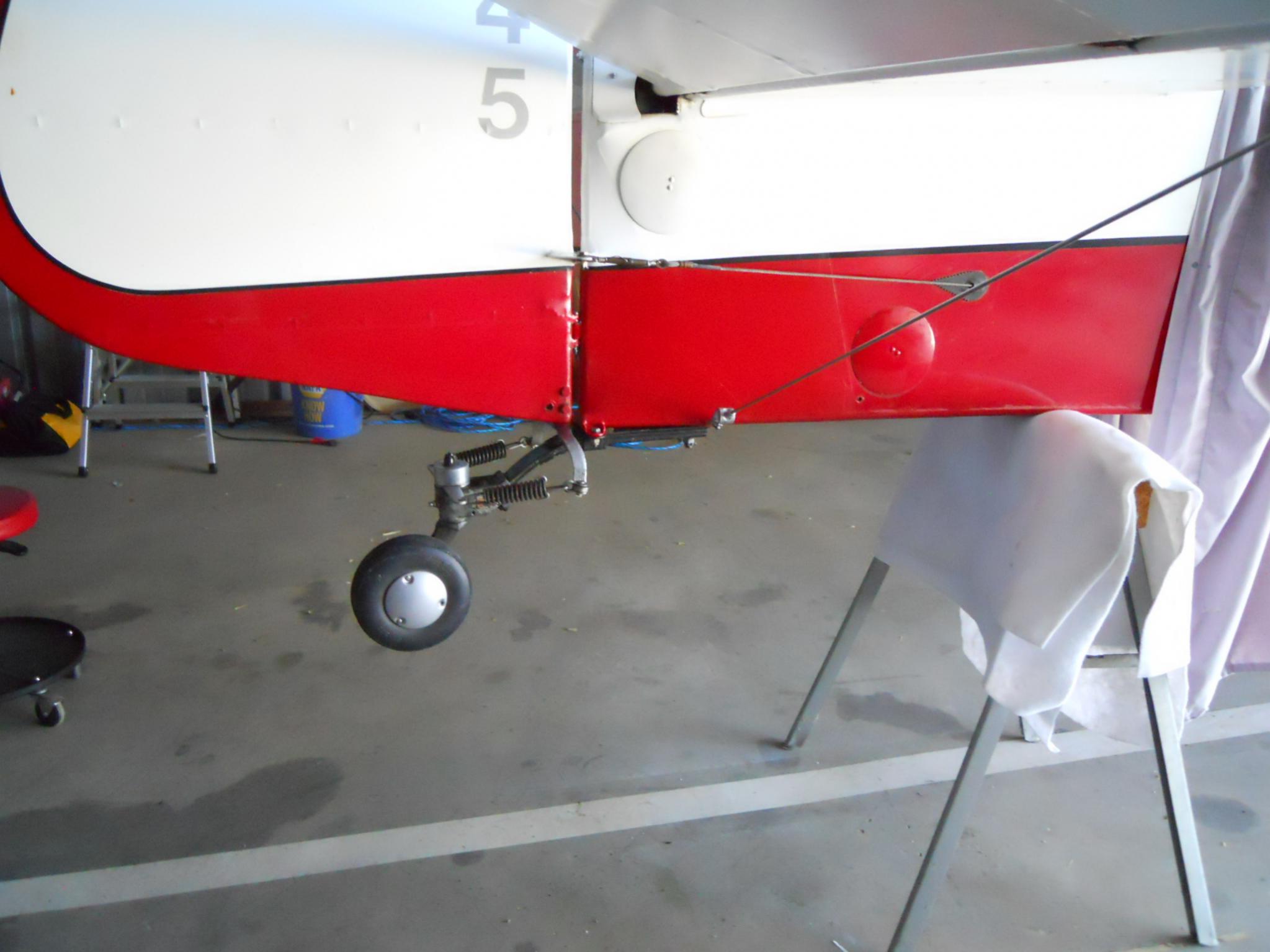

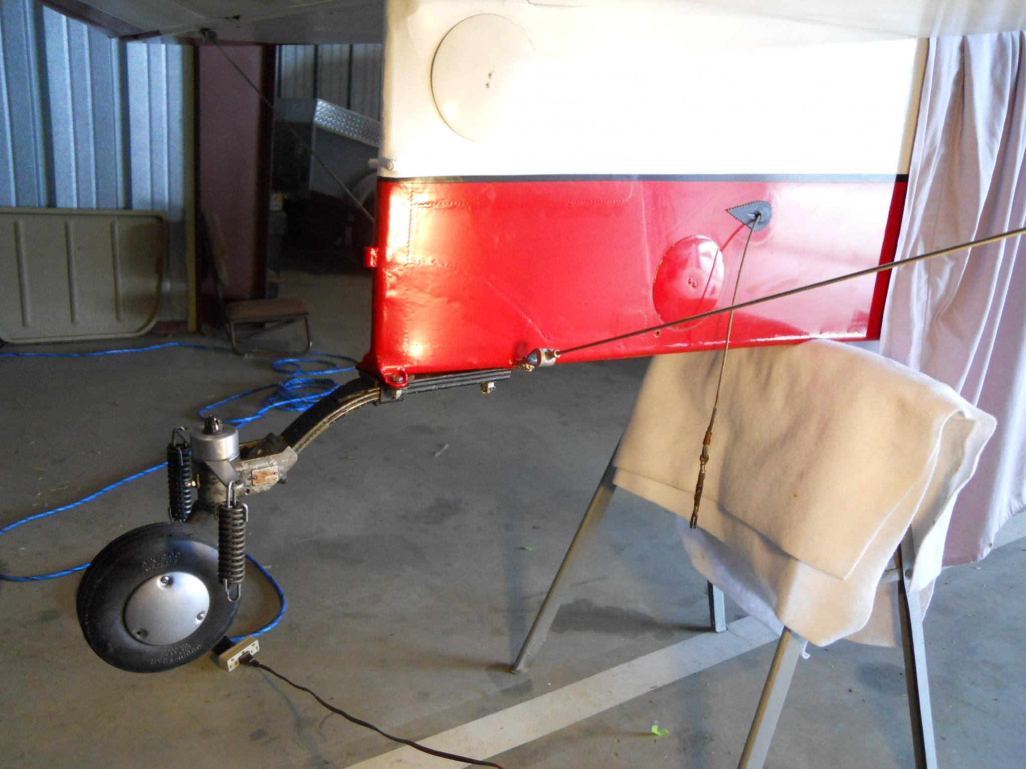

                          Here is the last report. It took three tries to get the red to match... but the third was a charm. I flew it back home today. I noticed that there is some play in the Lang tail wheel steering arm when you hold the wheel from moving.... I need to look at this. What is acceptable play??

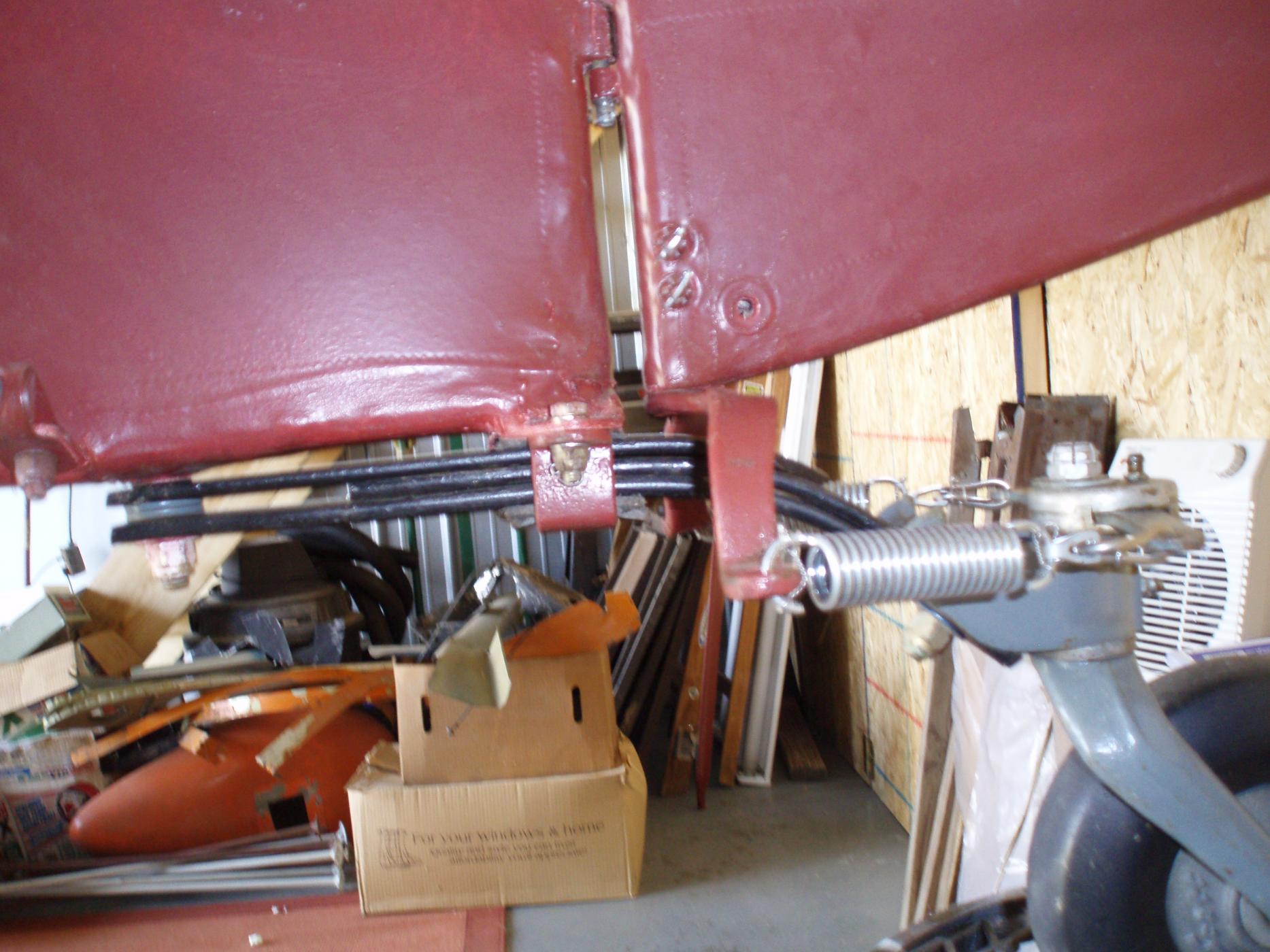

                            Its acceptable up until it begins to shimmy. Your tail spring does not look right, it looks like its missing a spacer...and the stackup is off. It may just be the picture though from the angle I am looking at it from. Tim
                              The middle spring is supposed to be shorter in the front. If the two bottom springs are full length when you drop the tail down they can't slide across each other and the front attach bolt can be sheered in two. There is supposed to be a spacer in the front between the top spring and the bottom spring.
                              This summer I saw a plane set up like yours is and when the springs were taken off and inspected the front end of the middle spring had a fore and aft slot instead of being short. I am pretty sure that is how Piper did it but that middle spring was not right for a Taylorcraft. The middle and bottom springs SHOULD NOT BOTH HAVE ROUND HOLES!
                              Don't forget to mouse the springs! REALLY exciting when one comes loose!
                                I agree that yours is set up wrong. If those two long springs both have round holes it will shear the bolts when the springs flex. That could leave you needing to do another repair.
