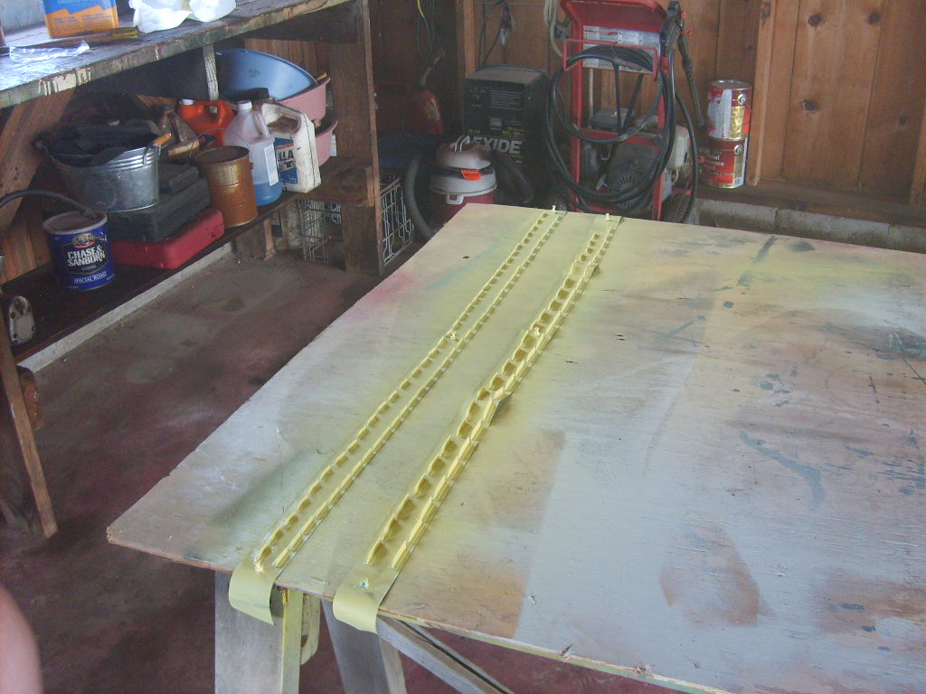

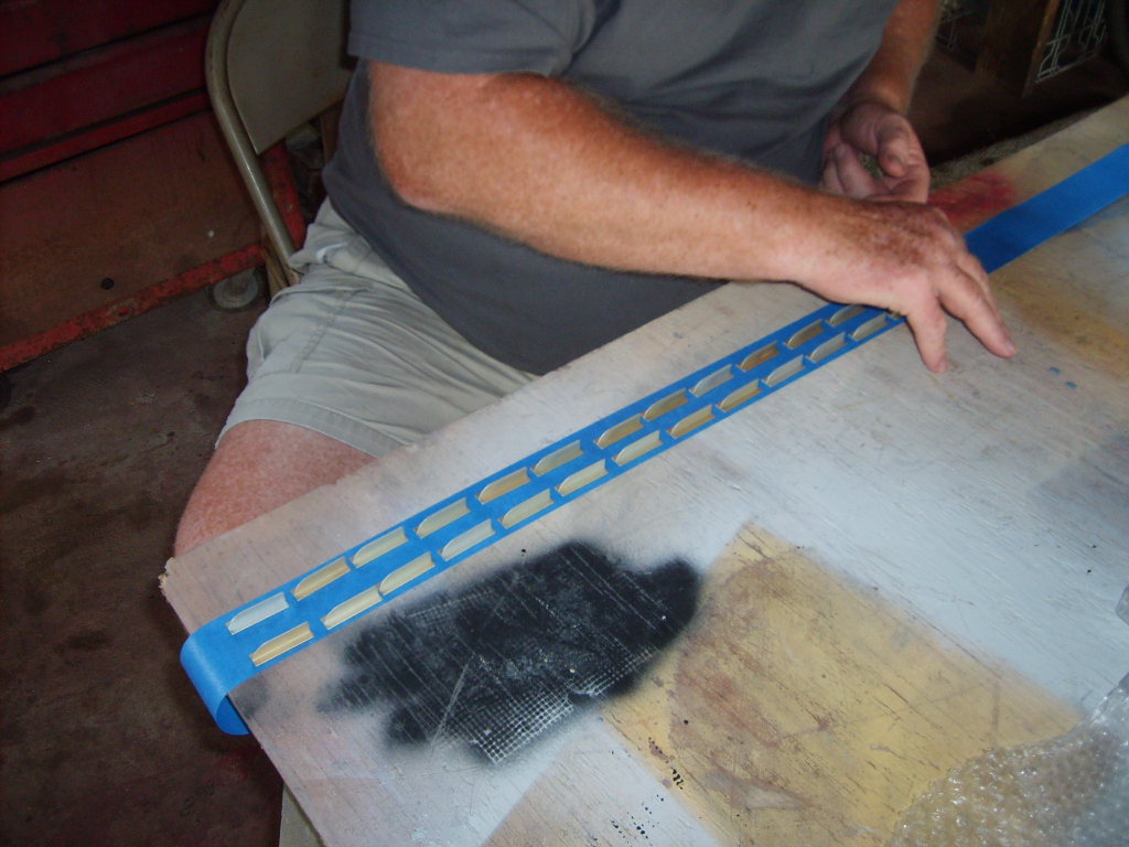

                  Robert easy to paint 2 inch masking tape stick the vg's to the tape and set on a board or card board box thumb tack of clamp the tape down and spray them let dry and glue this way no paint gets on the glue surface. my vg's have been on for two years with no problems and they do help at slow speed you will like them.
                      Hi Cvavon, Thanks for your idea only problem is I just don't understand it? can you make it more idiot proof! Thanks again.
                        Re: Vortax Generatos
                        Not sure if your joking or not, but will try and make it more clear. Take a section of 2 inch wide sticky tape and place it sticky side up and pin it to a board so it is tight. (not flapping around) Place the side of the VG that will go against the wing on the sticky tape. This will hold them in place for painting. When finished painting remove them from the sticky tape, and install them on the airplane.

                            Robert here is some photos of what i was trying to say
                            1940 BLT/BC65 N26658 SER#2000
                              Thanks both, replied in haste without thinking it through! yes I understand exactly what was meant! Now off to the market for tape and tacks! It certainly looks a good way of preventing the paint getting on the areas of the vg's to be glued.
