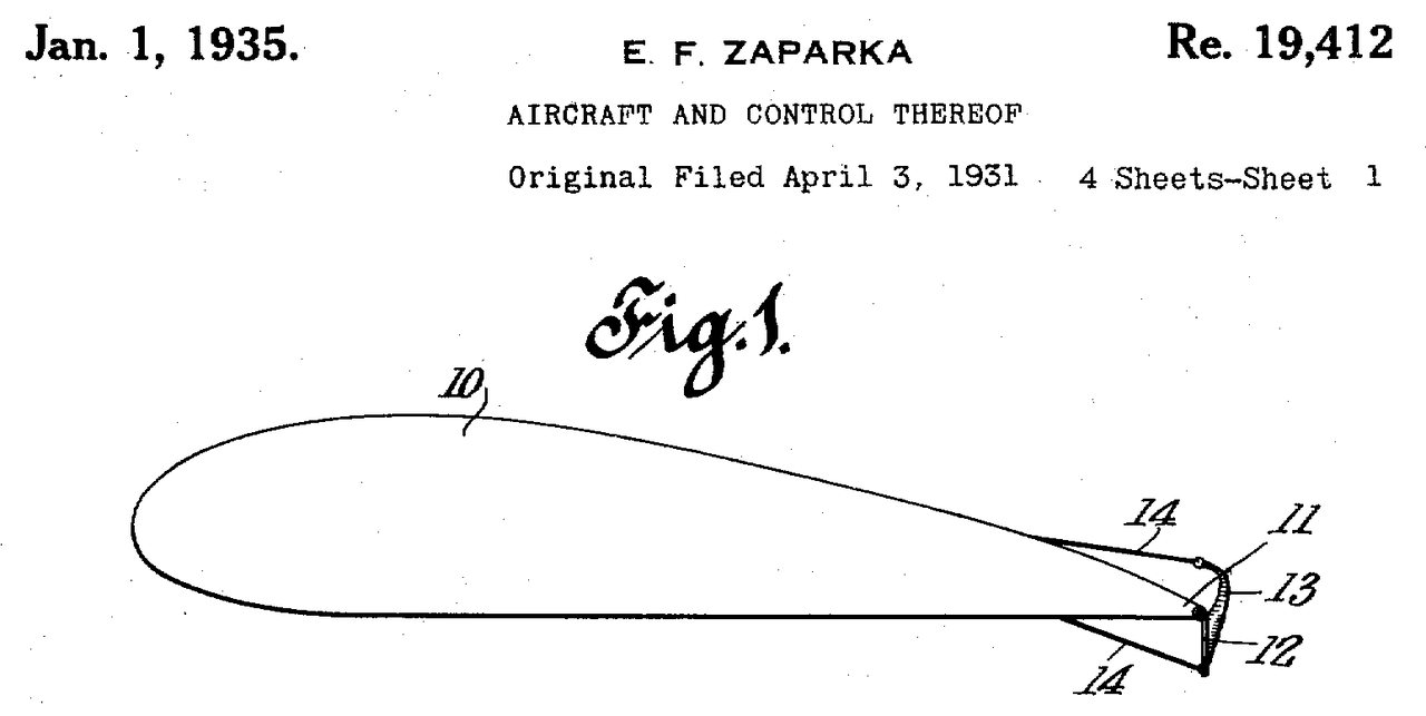

Think of the fun one could have with a fixed or even deployable GF. Maybe make them from a piano hinge and use the center pin attached/welded to one deployable side of the hinge. Run the pins inside and across the fuselage, attach to each other and add simple bell crank to rotate and deploy, and enjoy the added benefits.
