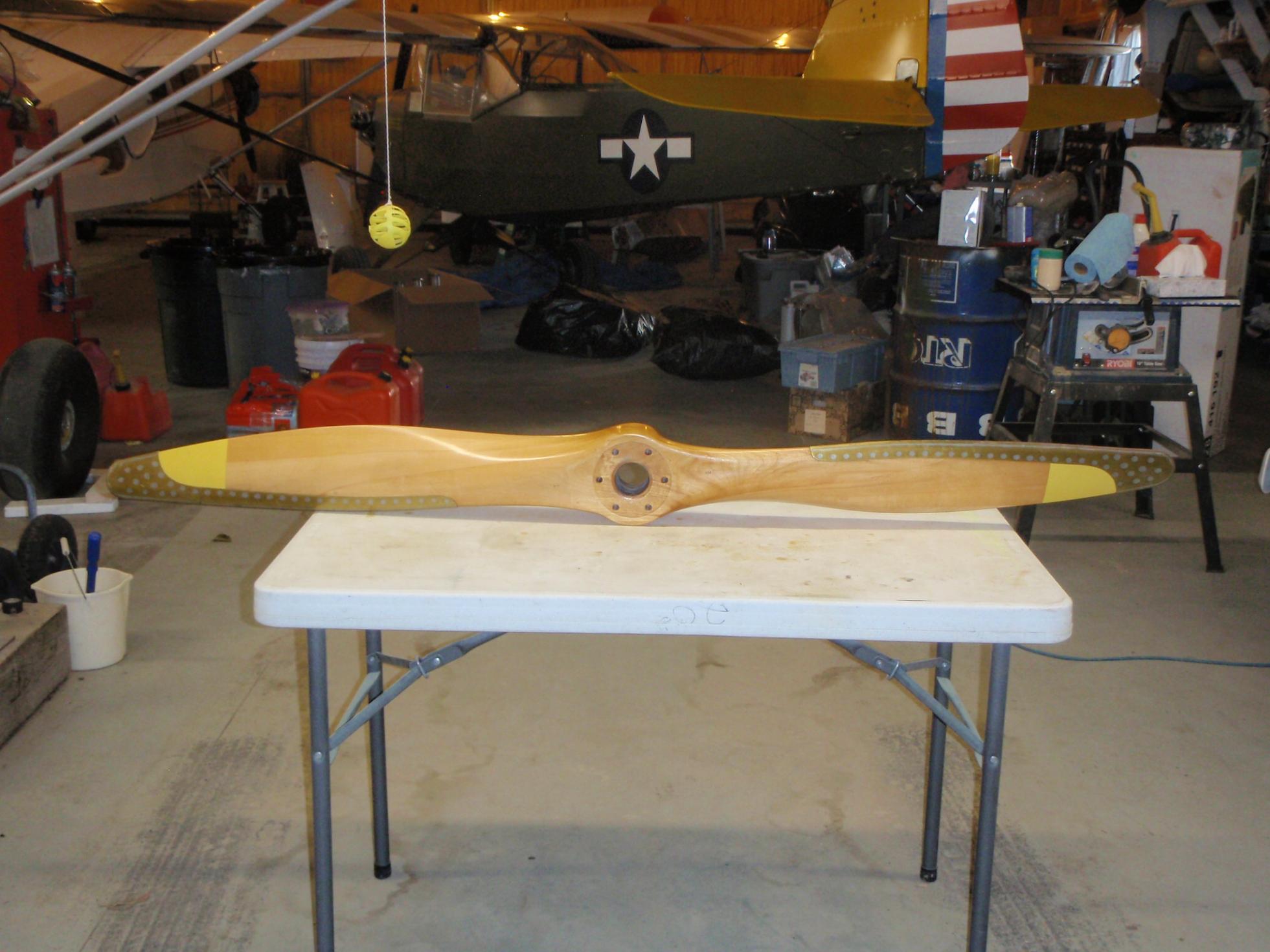

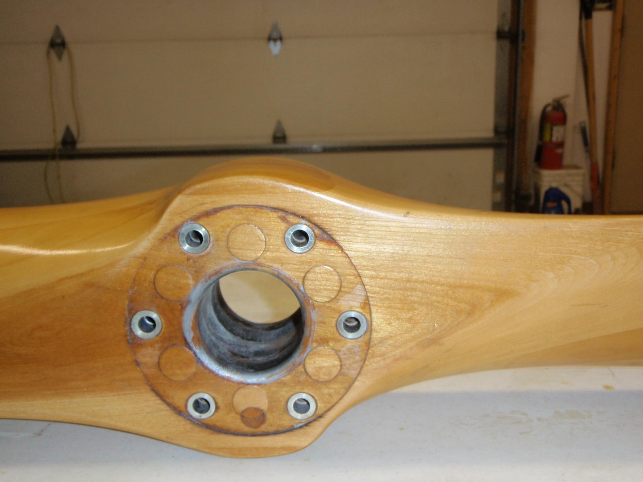

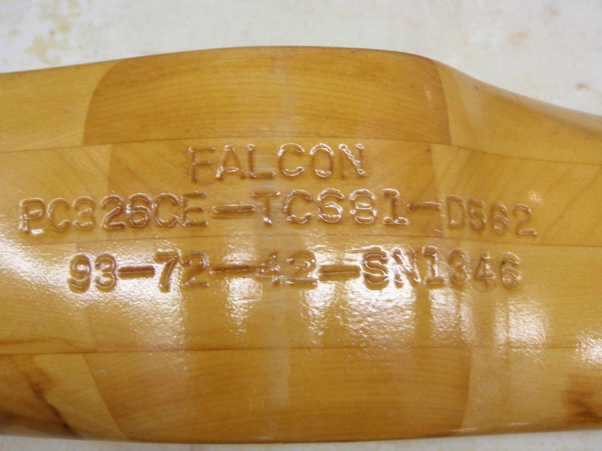

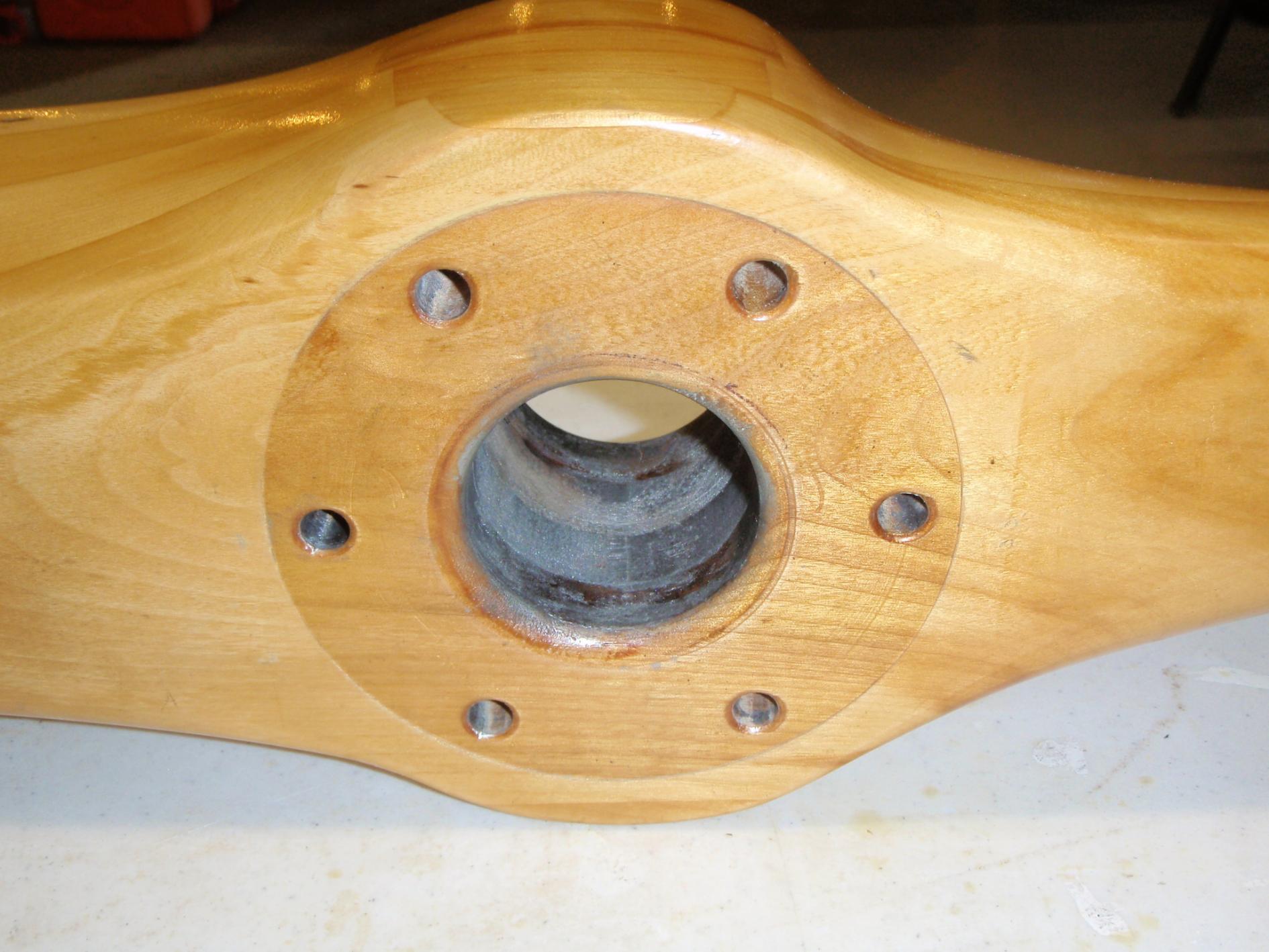

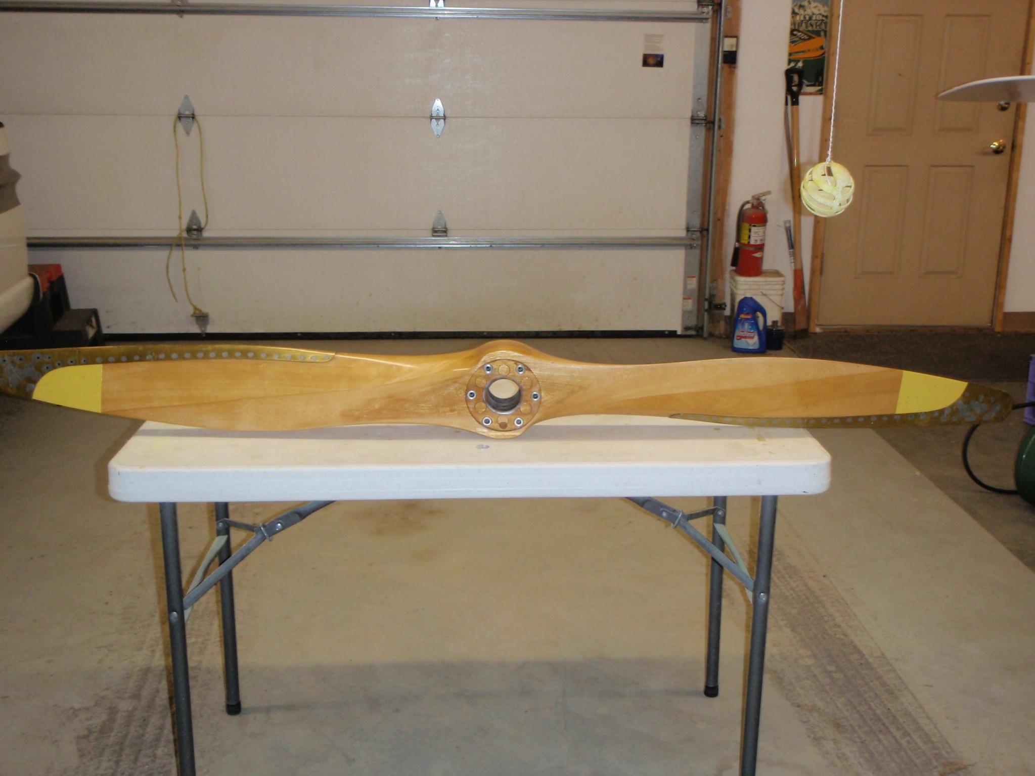

    I would attach some pictures, but I can't find the paperclip to add them to this post.
    Looks like I figured it out.

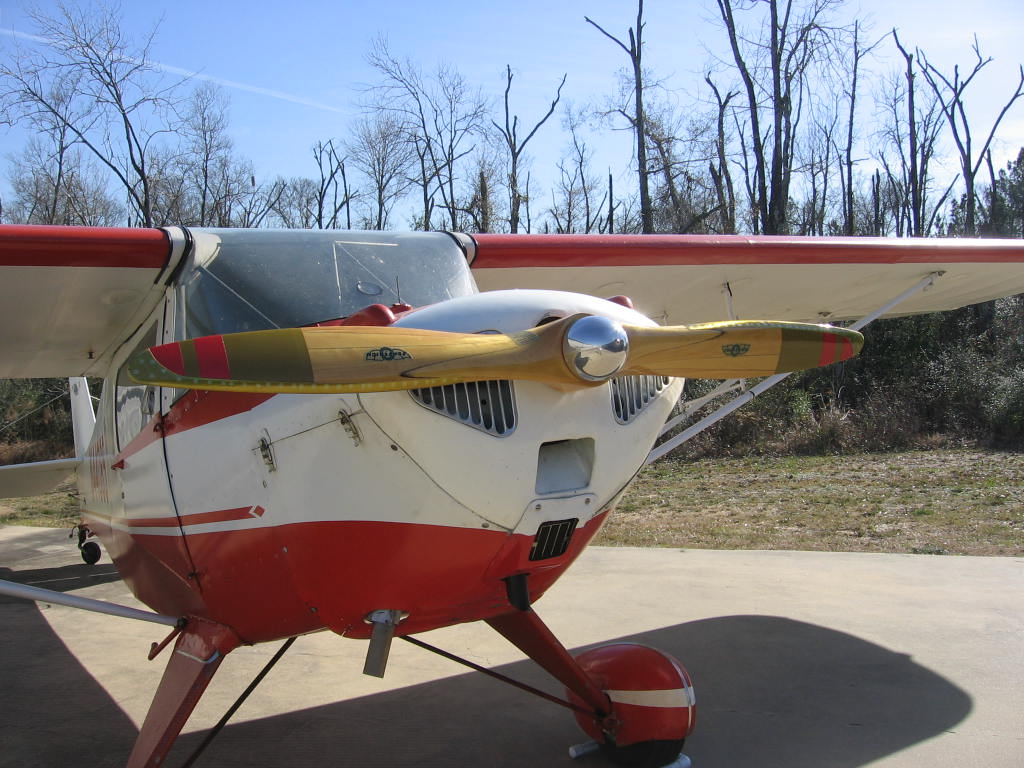

                  I can now answer my own question.
                  Hardware:
                  Sensenich W72CK42 prop
                  6 - A437 Prop Bushings
                  2 - AN6-43 Bolts
                  4 - AN6-42 Bolts
                  AN960-616 Washers
                  AN960-616L Washers
                  6 - AN310-6 Castle Nuts
                  AN380-3-3 Cotter Pins
                  Continental hub crush plate
                  Information:
                  Sensenich torque specifications
                  Article on removing prop hub from taper crankshaft and special tools listed
                  Paper by Robert Bristol, Chief Design Engineer, Sensenich Corp, on amount to compress prop wood for correct torque
                  After cleaning and painting the prop hub and crush plate, I was ready to mount hub and prop together. I used the 2 AN6-43 bolts through the bracket for the skullcap spinner. Noting the problems reported here on our forum, how tight is right? Sensenich numbers for torque using AN6 bolts are 175-225 in-lbs. or 15-19 ft-lbs. Robert Bristol's paper calls for compressing the wood, after snugging the nuts, .006" per inch of prop thickness. For this prop/bolt combination, ½ turn. I think a source of error in this method is how tight is a snug. I chose to tighten the nuts, with a wrench, until some resistance was felt. I then torqued all bolts to 12 ft-lbs, then 15 ft-lbs, and finally to 16.5 ft-lbs. As I torqued the nuts, I noted the amount of turn, which resulted in just over ½ turn, but less than ¾ turn for each bolt. I estimate the prop wood was compressed .025" vs the .02" called for.
                  Now to remove the McCauley prop/hub. After removing the skullcap spinner and bracket, and the lock pin from the hub nut, I used a small cheater tube over the 5/8 bolt thru the hub nut to remove the whole prop/hub assembly. I did not need the special tool to jar loose the hub. But the spacer used to prevent the snap ring from collapsing is a must. I would recommend that the tab inserted into the snap ring space have a slight dovetail shape. This will tend to lock the tool in when removing hub.
                  While the prop and hub were removed, I chose to replace the front crankshaft oil seal. My old one had no fresh signs of leakage, but there was some old residual staining.
                  To torque the prop hub nut when installing the new prop, I used a large socket I have for the wheel bearing nuts on my 4x4 pickup. It is large enough to fit around the hub nut and has 6 flats rather than a round surface which made drilling easier. The hub nut was torqued to 190 ft-lbs.

                    Before removing the metal prop, I wanted to get some performance numbers to compare to the new Sensenich wood prop. The yellow tag from the prop shop states that the prop was twisted to cruise configuration. The hub is stamped 7444, which is between climb and cruise.
                    I flew a square box and recorded GPS ground speed. TAS is the average of the four legs. Some simple trig computes wind speed and direction, if you care. I have data from two different flights for the metal prop.
                    Since installing the wood prop, I have data from two more flights. One at 2000 RPM to compare to the metal prop, and one at 2150 to compare power settings.
                    Prop Alt RPM OAT IAS North East South West TAS Wind W-dir
                    Metal 1800 2000 85 75 92 87 71 81.7 12.1 300
                    Metal 1800 2000 60 86 88 87 76 77 82.2 7.8 220
                    Wood 2000 2000 40 90 82 77 83 88 82.6 5.5 85
                    Wood 2300 2150 65 93 82 85 90 88 86.3 4.3 20
                    I also have a timed 1000' climb @ full throttle and 70 mph for the metal prop. 545 fpm from 2000' to 3000'. Data for the wood prop is in the future, but VSI shows that climb should be similar.
                    My interpretation of the data so far is that the metal prop is more of a climb than cruise configuration. It doesn't appear to be twisted even to a standard configuration. I have always felt the the plane was slower but climbed better than it should. The up side to all this is that the plane didn't drop any performance in going to the wood prop. It was slow before, but it's not any slower now.
                    I plan some more squares at different throttle settings. Probably 2300 and 1800 rpm.
