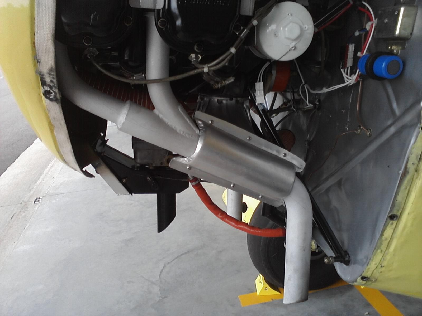

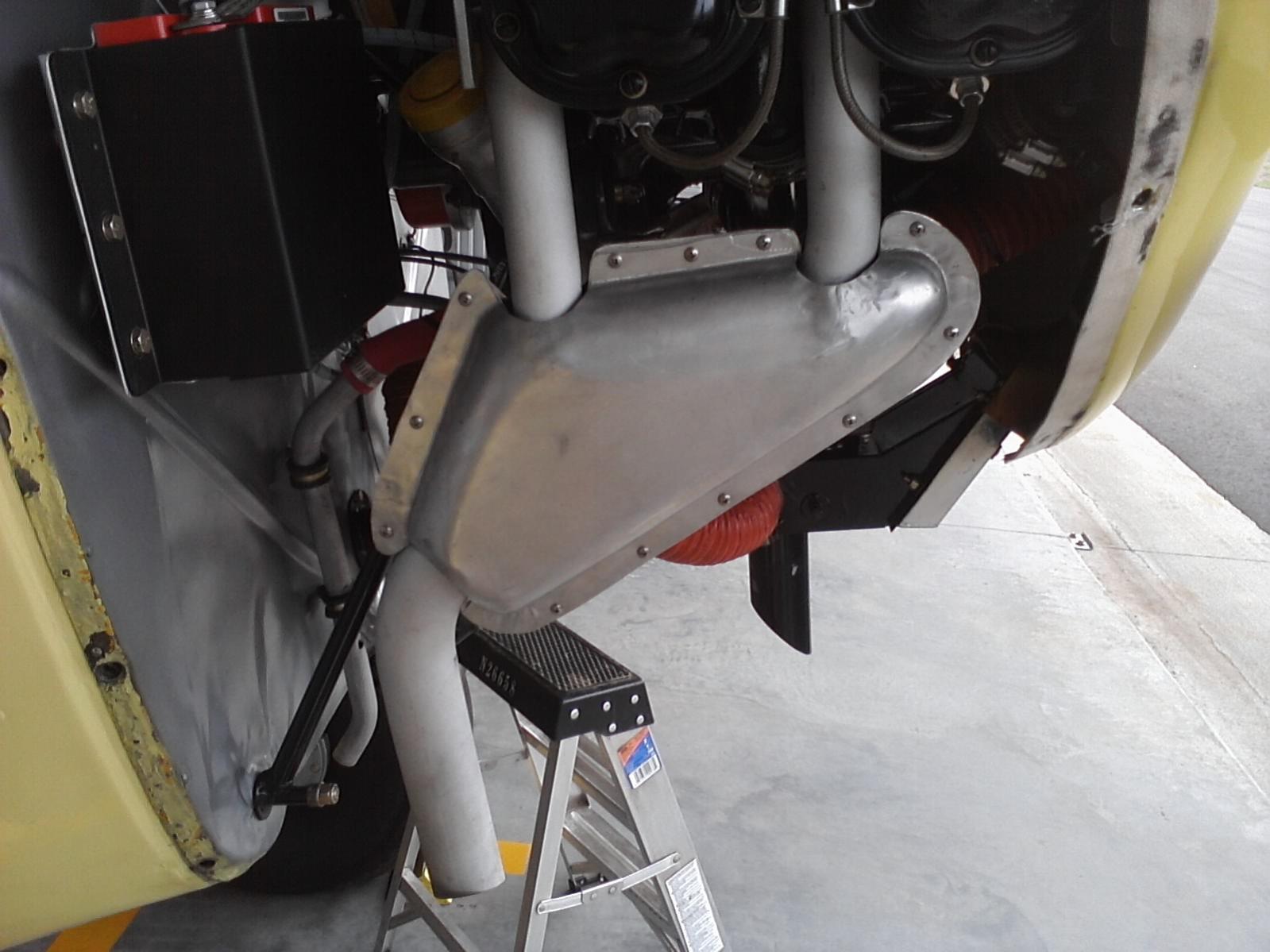

      Well do not know about the cowling stuff, but if you doing new exaust it may be worth looking at Tarry's paperworks for putting on Luscombe exaust. Saves a lot of trouble with pulling the muff at annual and you can pull the exaust without pulling the engine. If you are doing both cowl and exaust that is the way to go. I did mine a year and a half ago works grate. http://dc65stc.blogspot.com/2010/09/...onversion.html

          The exhaust do the luscomb and don't look back terry bowden has paper work also do the mods to the wings for STC 210 c85 up grade from Terry.Did this to my plane a year ago.

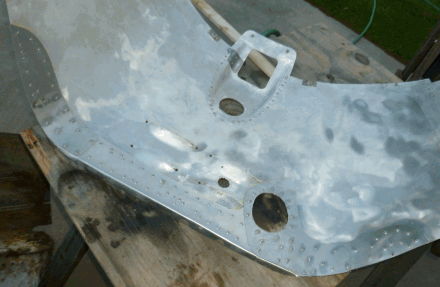

            For what it's worth, I did a bunch of repairs to my lower cowl (original) recently and I'm convinced that the original material is not 6061. It is 0.040", but it seemed to be much softer than 6061. Easier to bend, easier to drill than 6061.

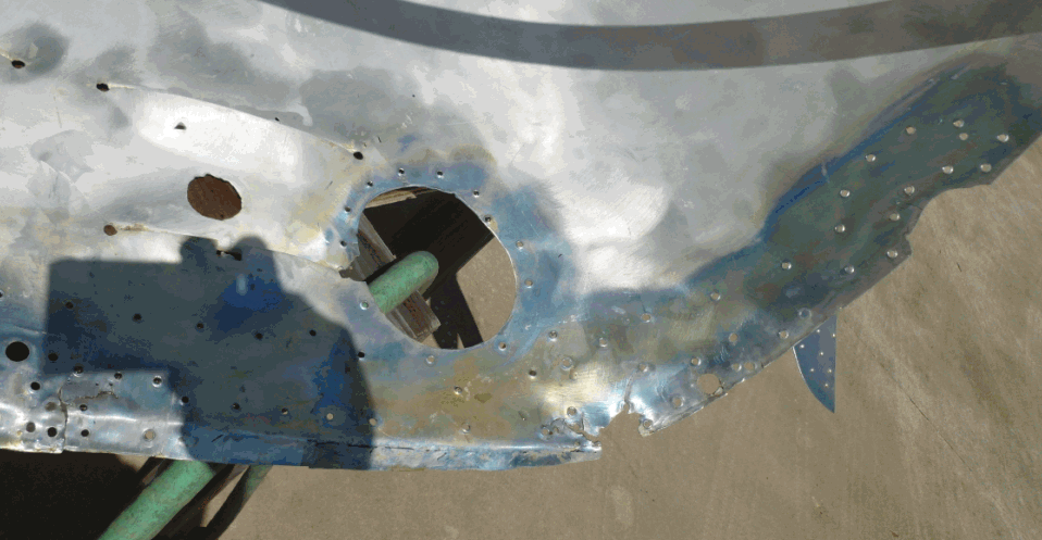

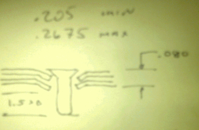

                I'm no sheetmetal guy. But I had decided to add a 0.040" 6061 doubler on parts of the cowl. So I was working with both materials (original cowl and a 6061 doubler) side by side. When I match-drilled the two materials, I could feel a difference as the drill cut through each. See the sketch below that I made when I was trying to figure out how long to cut the rivets. You can see that the total thickness of both pieces is 0.080". The dimension that is hard to read says "1.5 * D".
                I also added a 0.016" thick additional stainless steel doubler in a couple of key spots.

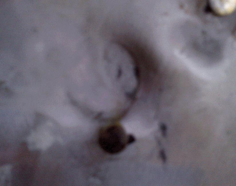

                In one of the blurry pictures, you can see where, to my horror, the flush rivet set slipped off of the rivet and put a substantial divot in the original cowl. I didn't think that it had even hit very hard. But that divot tapped out very easily with a hammer. It looks fine now.
                But these are the clues that led me to think that the original cowl was made from some aluminum that is much softer than 6061.

                    See other thread that is going on the site for grove conversion. I did this two years ago my 337 is posted in the teck section here or you can get DAR paper from Terry Bowden.
