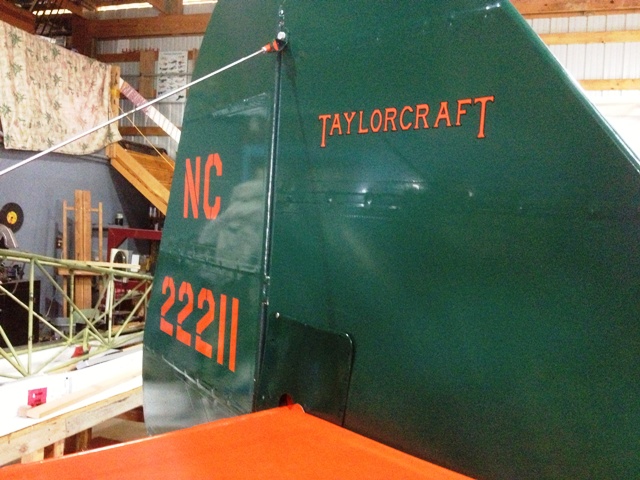

    Here are a couple of photos of NC22211 as she sits now.

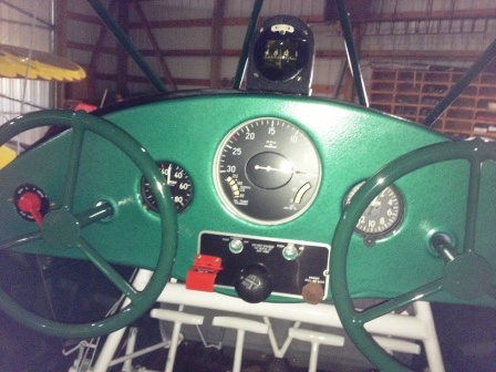

                  Hey Bob, Can we see what the instrument panel looks like? Just love those large tachs. I restored a 1940 BL 65 converted to A65 with no problems Ken

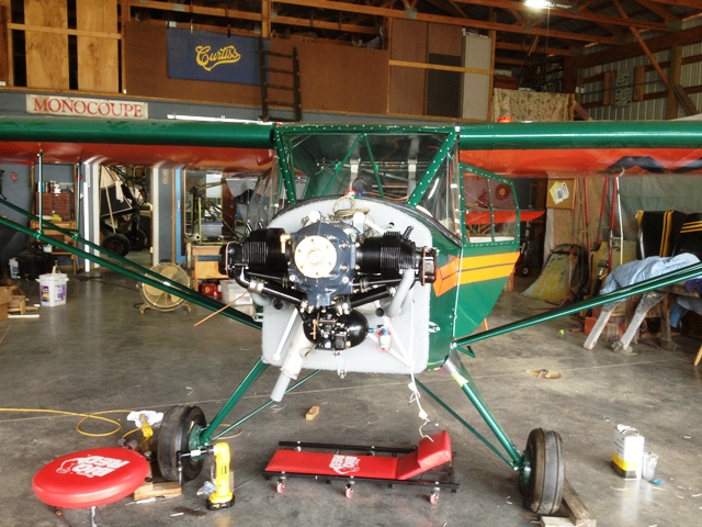

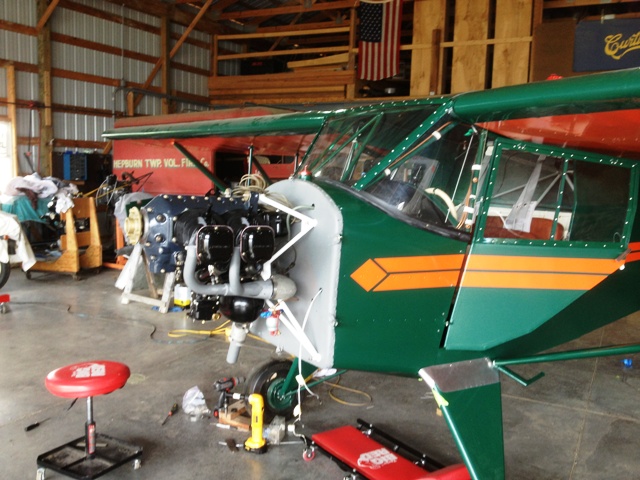

                      Ken - I'll try to post a panel photo - it's your panel overlay, by the way. Fit is superb.
                      Second photo gives a glimpse of the 4 piece windshield installation as well as a view of the engine going in place. Fitting the exhaust was a Chinese puzzle!
