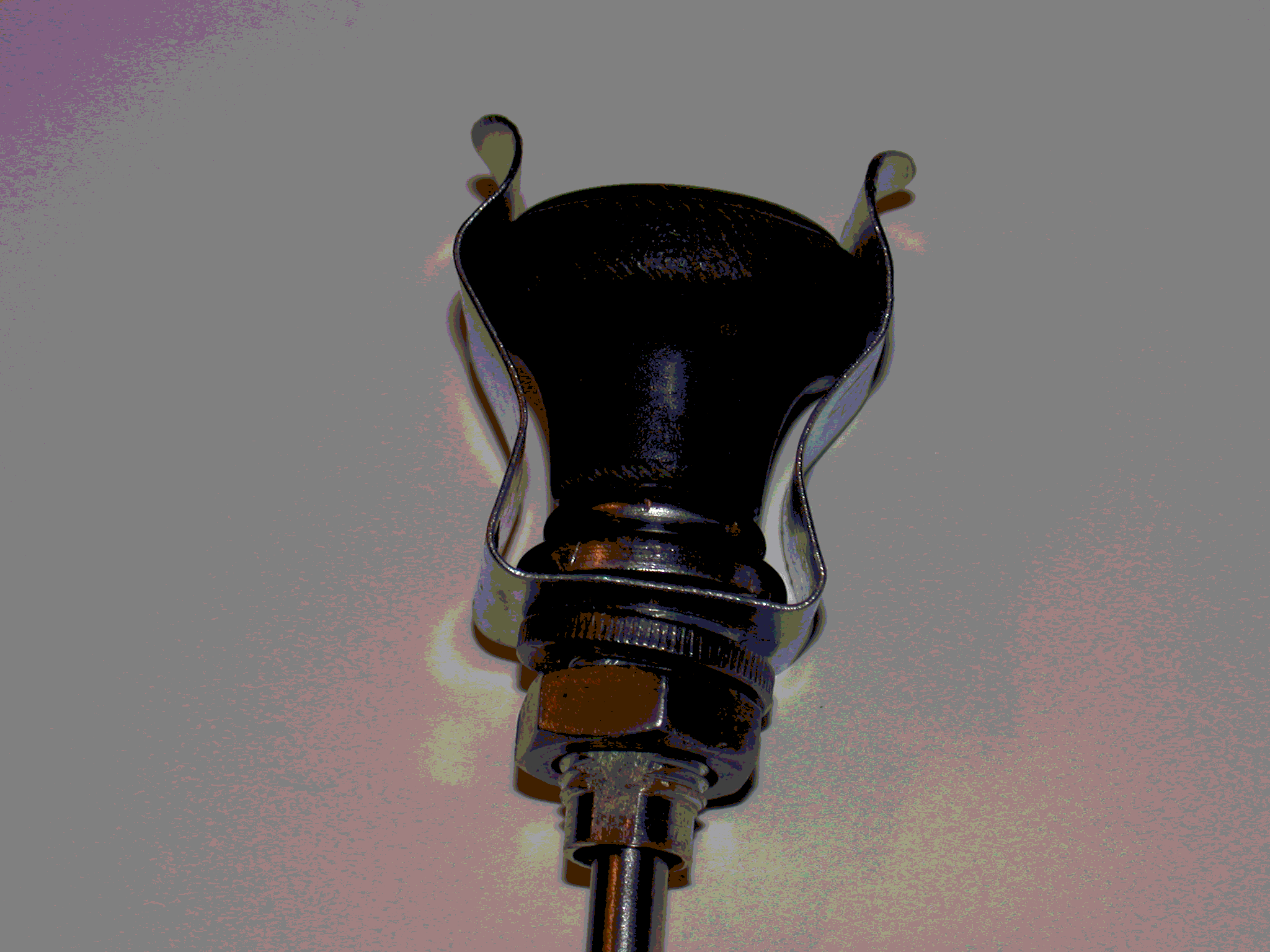

          Re: Fuel shut off valve
          The one in the picture is what they put on at the factory. I have seen a lot of planes with nothing on the knob (which I think is DANGEROUS and not very smart!....being polite here)
          The purpose of the clip or cover is to let you know your hand is on the fuel cut-off and not the cabin heat or carb heat. I don't see any reason for a two step cover being needed. You aren't jettisoning a stick of 500# bombs! You just don't want to be cold and shut the engine down instead of turning on the heat.
              The part you have is the part needed to comply with the AD. The way it should work is that you can not pull the fuel shut off without moving the clips to the side. If you can pull the knob without moving the clips then something should be done to correct that.

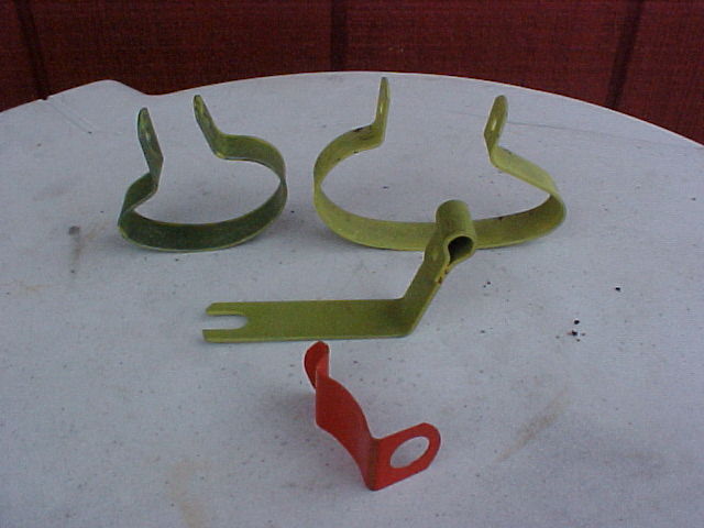

                    Here is a picture Forrest provided some time ago. The red clip is an original Taylorcraft part for the fuel valve. Show your guy this picture. That is what was originally used on the plane.
