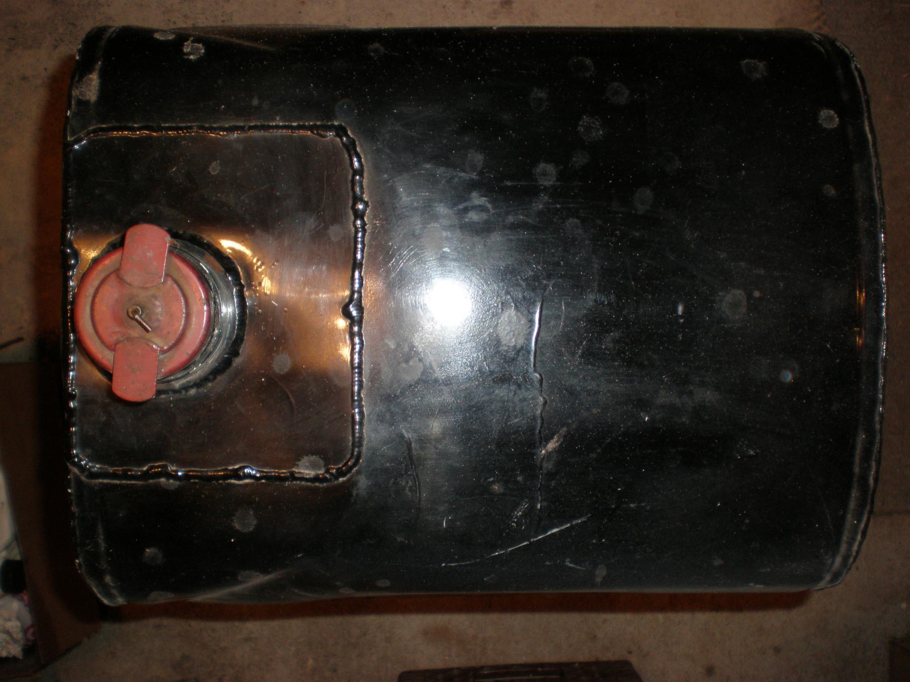

    Excellent idea, Hank. I will be talking to my friend with the plasma cutter in the next day or two to see if he can cut them out. I don't want to stamp them because they usually turn out looking like junk and non-uniform. I know the originals weren't uniform, either, but for the time I am going to be putting into these I want them to look nice.
    Can someone please provide the dimension of the main tank tube, inside and outside as well as the length above and below the cap top? A picture would also be nice. Thanks!!!

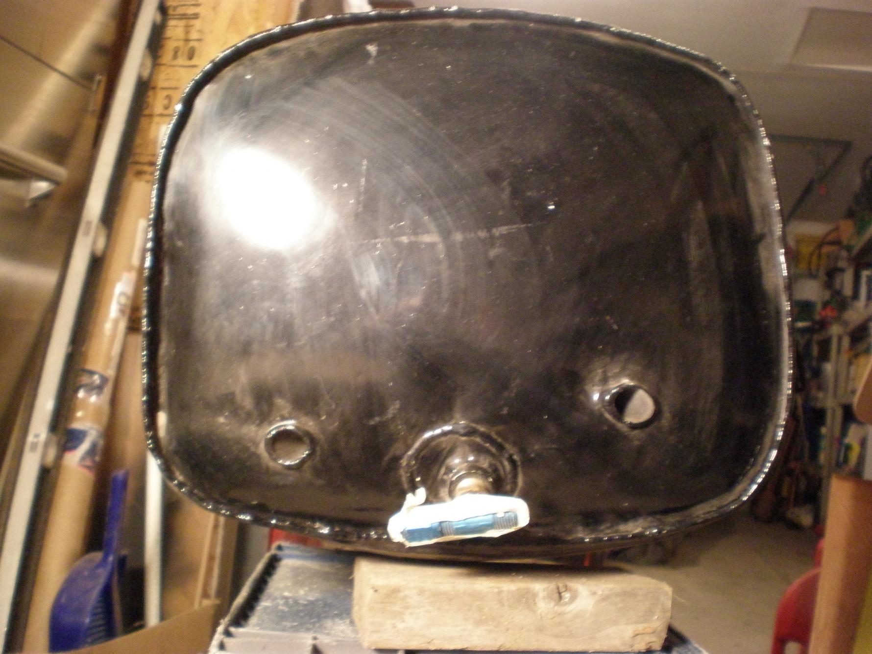

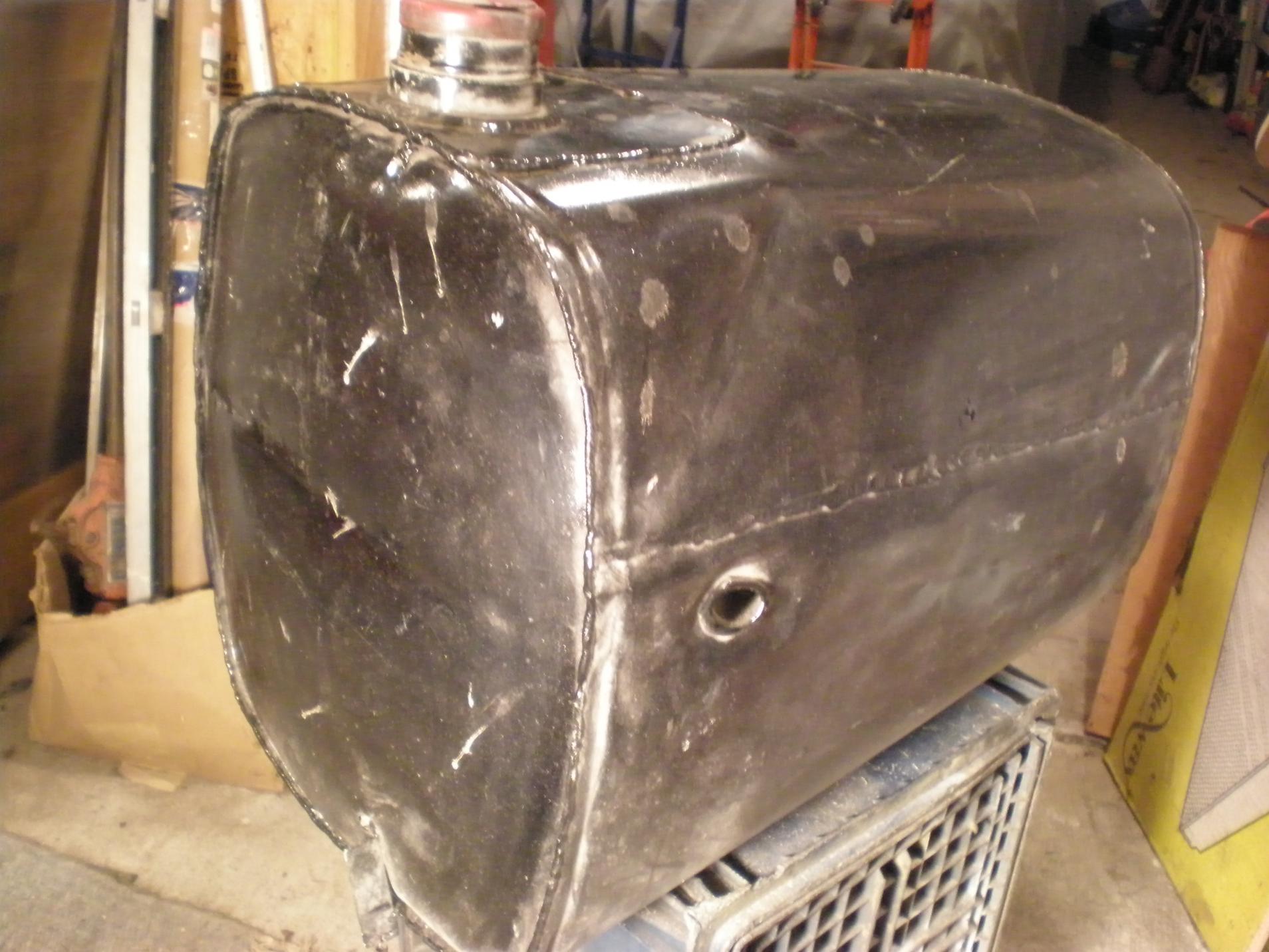

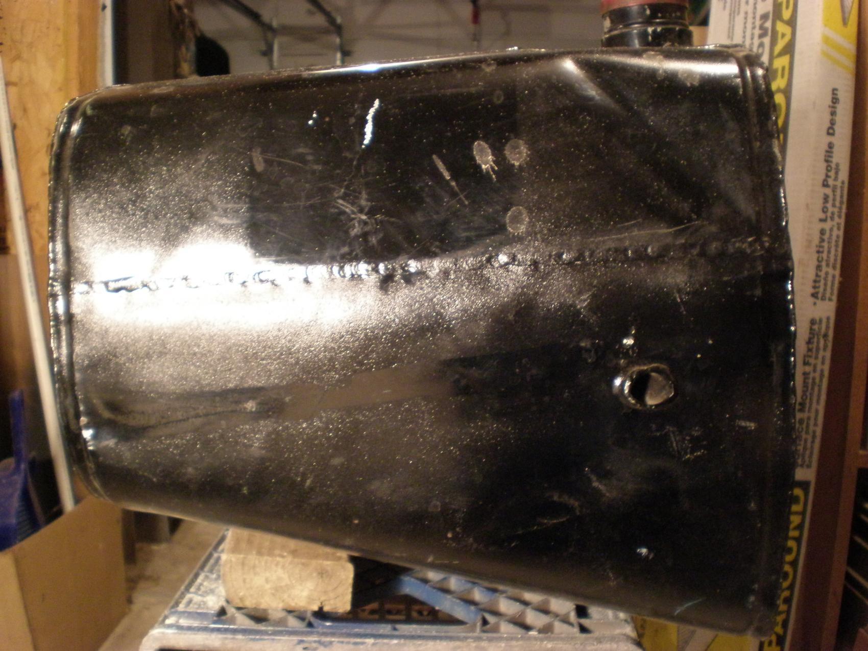

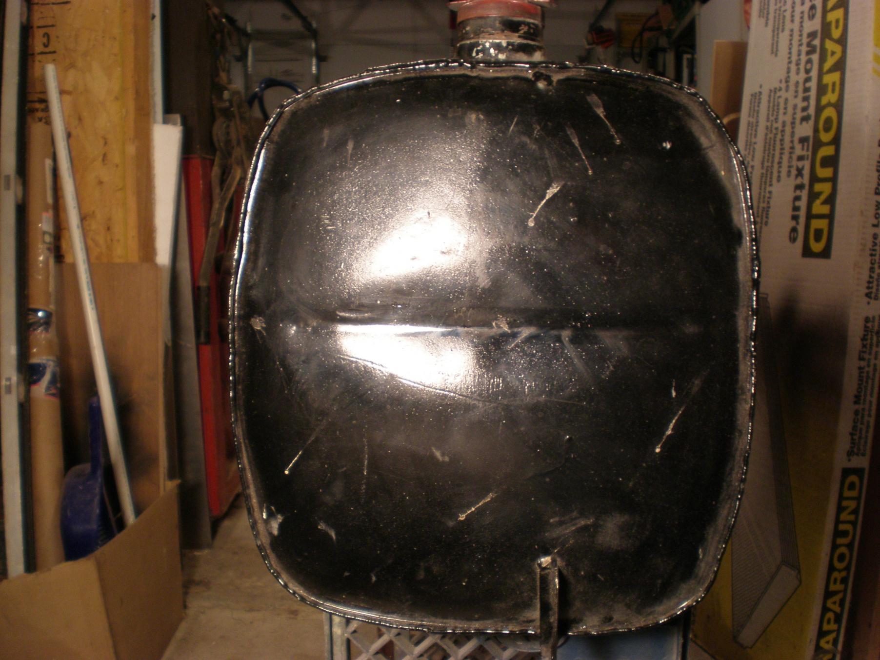

        If I can get a good clear photo, top, bottom and sideview of the main tank tank from someone I would still appreciate it.

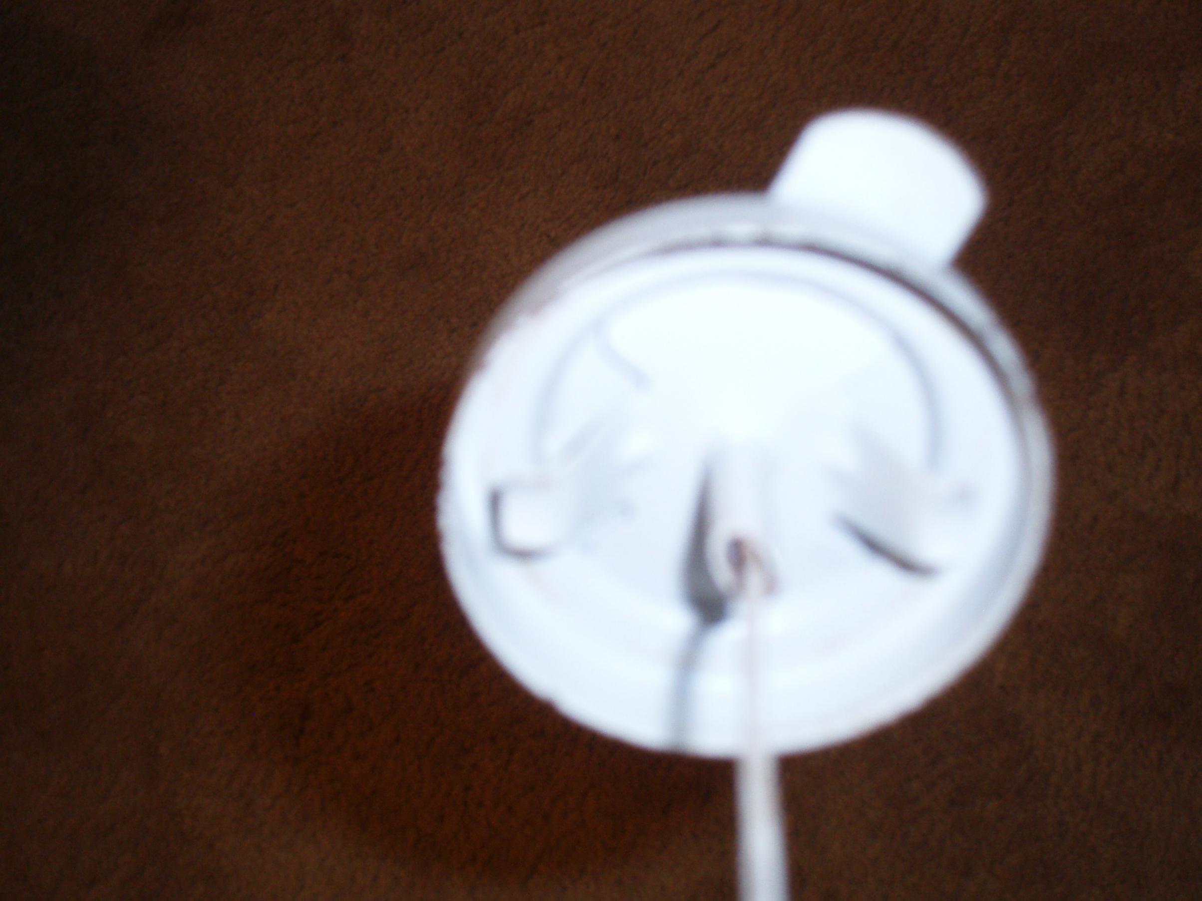

        • #34
          Re: FYI--- Gas Caps

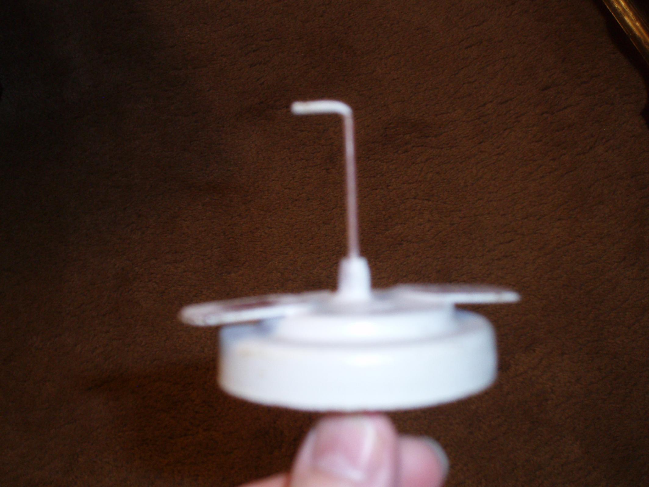

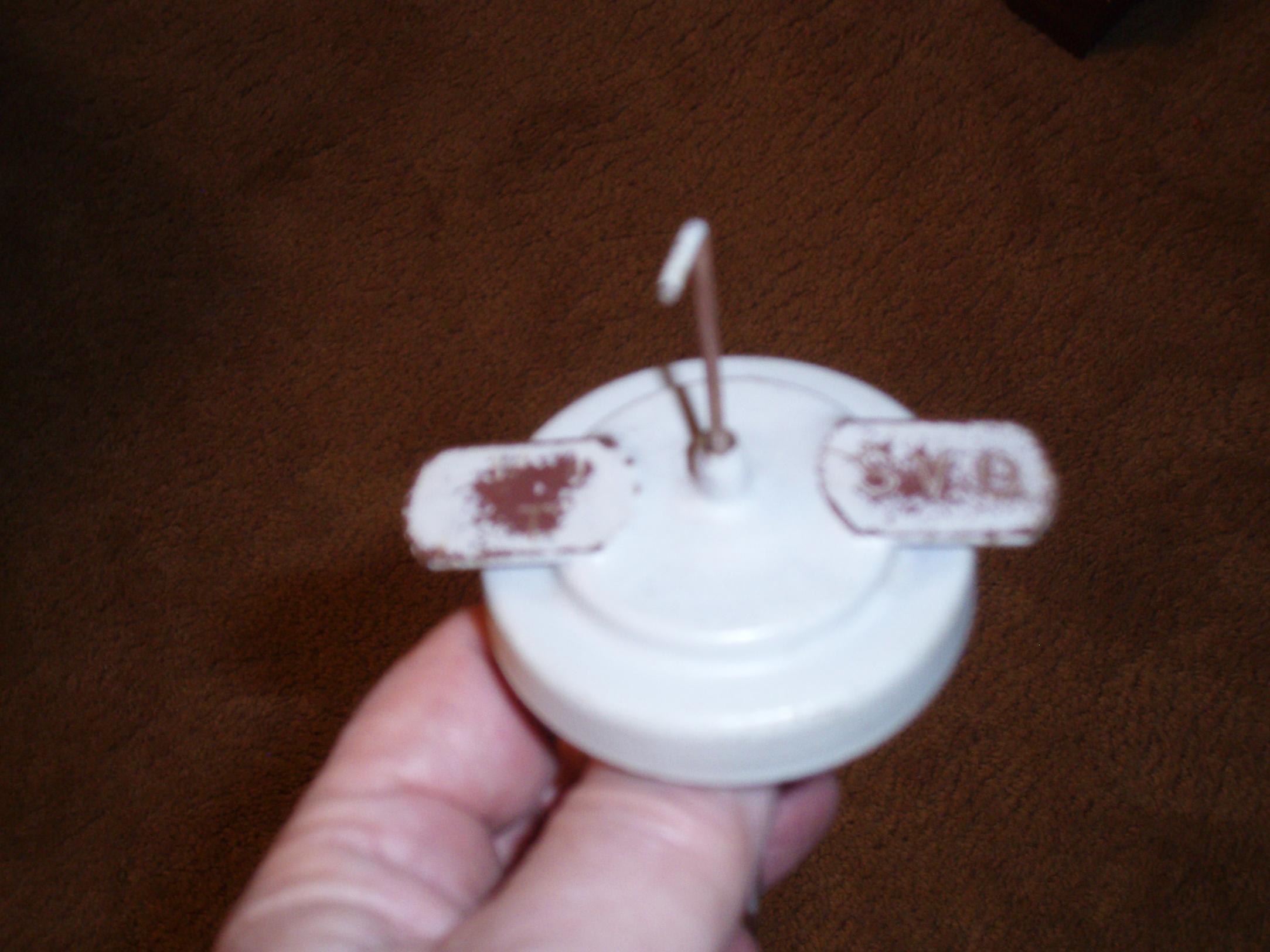

          Will these help?
          • #35
            Re: FYI--- Gas Caps
            Richard,
            Actually, I need clear closeups of the gas cap only, not the tank. But thanks for some nice shots!!!
            I should have said main tank CAP, my fault!

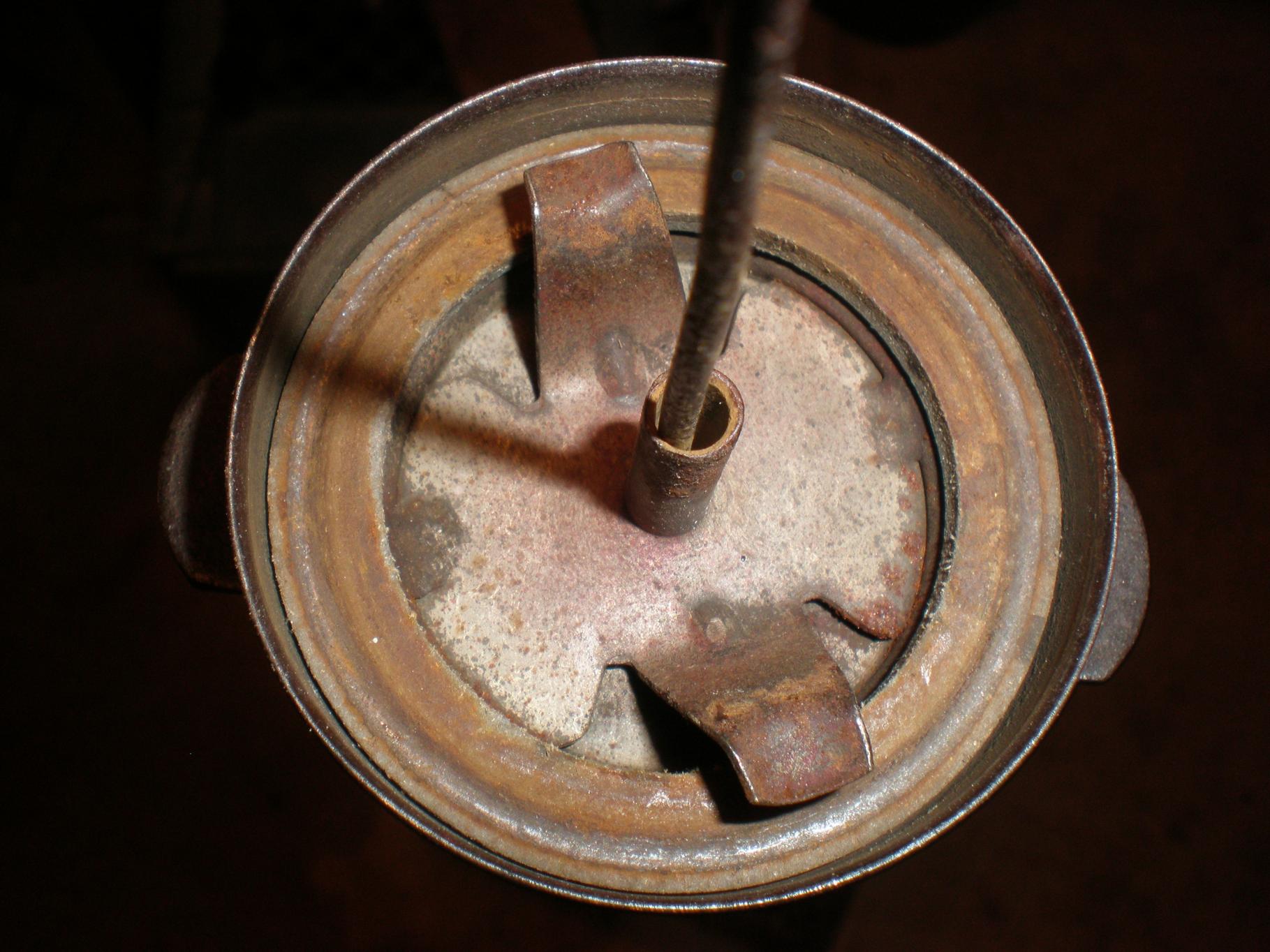

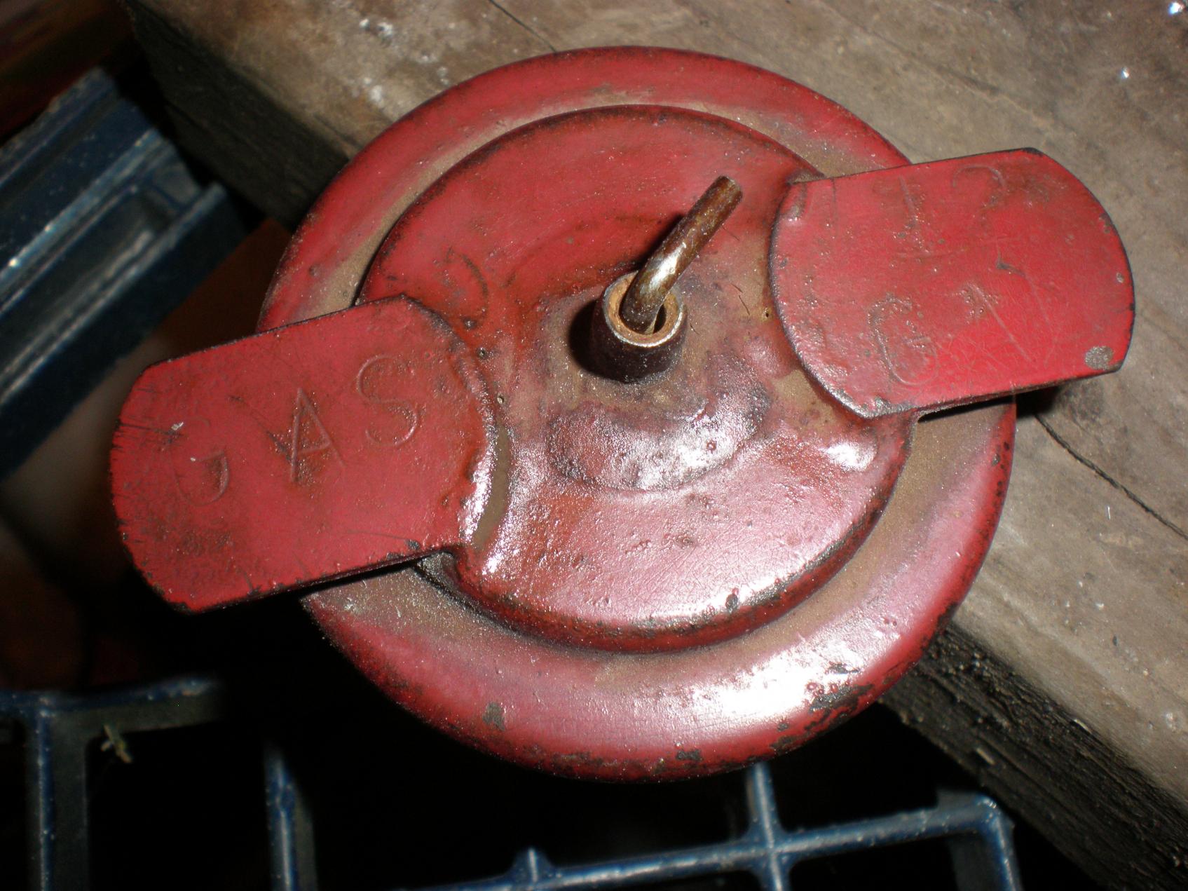

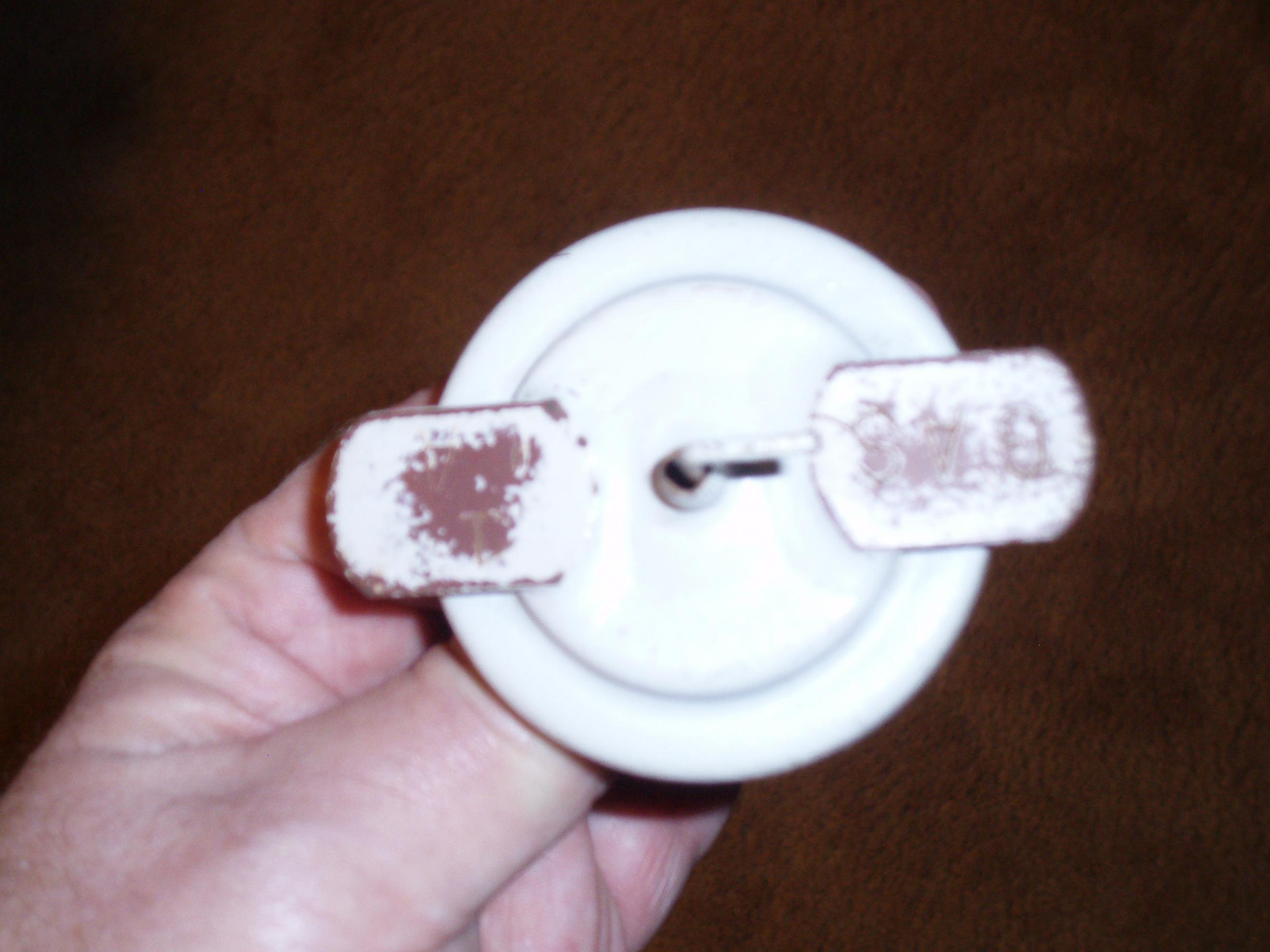

            • #36

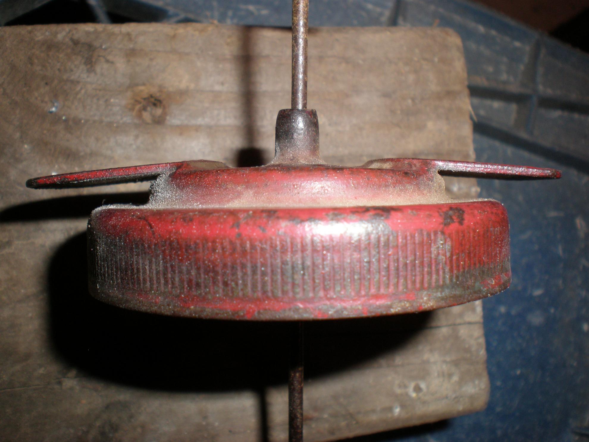

              Re: FYI--- Gas Caps

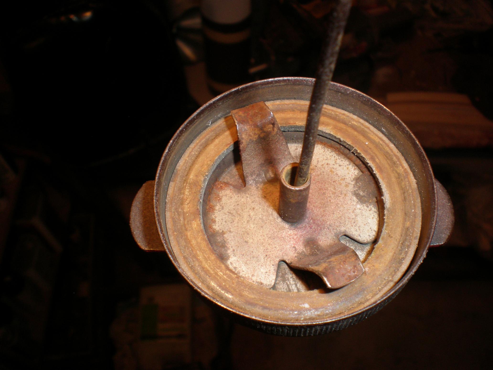

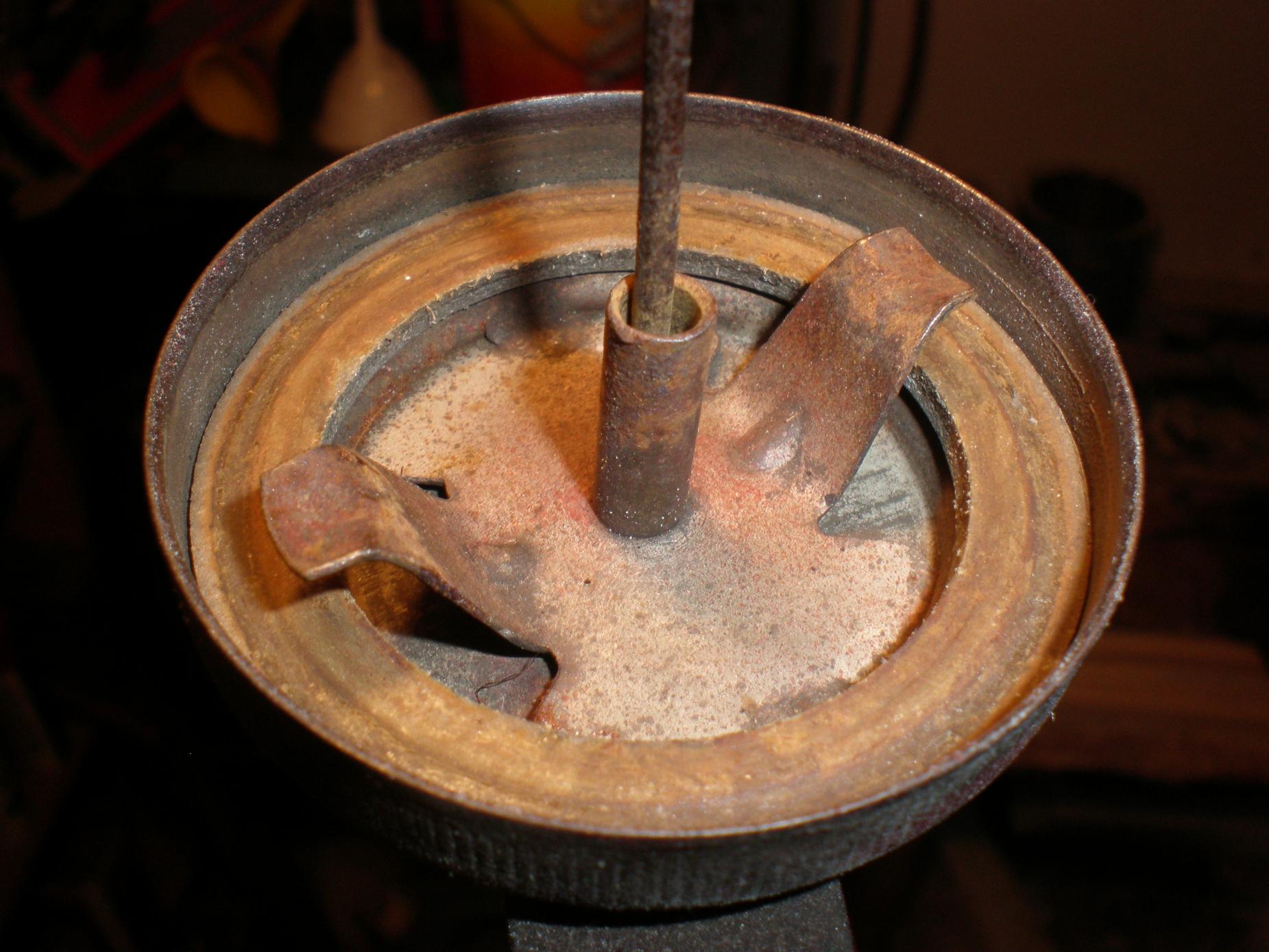

              How about these?
              • #37
                Re: FYI--- Gas Caps
                Thanks, Hank. Just what I was looking for. I want to show a couple of people how these are set up.
                Also, what is the inside and outside diameter of the tube???
                • #38
                  Re: FYI--- Gas Caps
                  Sorry, they are 35 miles from here right now in the hangar. Should be able to scale the tabs from the top view but all I know is the tube has a larger ID than the diameter of the wire. Wish I knew the diameter of the wire, :clue?::

                  • #39
                    Re: FYI--- Gas Caps
                    Well, looks like Hank beat me to it. But since I took these, I figure I might as well post them. The Tube OD is .250". The ID is harder to measure with the wire installed, but the best I could tell is .180". Those measurements are from the lower end of the tube. The upper end is swedged down to a smaller diameter on the ID and OD.
                    • #40
                      Re: FYI--- Gas Caps
                      Richard,
                      Thanks, those look good. I noticed on some of these the top of the tube looks slightly beveled. hmmmmm. Chuck had some type of bondo-like material around the top of his??? Anyway, I'm just doing a correct size tube, nothing too fancy. I also noticed yours is backwards like Chuck's when it comes to the GAS - 12 GAl. My old ones said 12 GAL then GAS. I guess it depends upon who was brazing that day...
