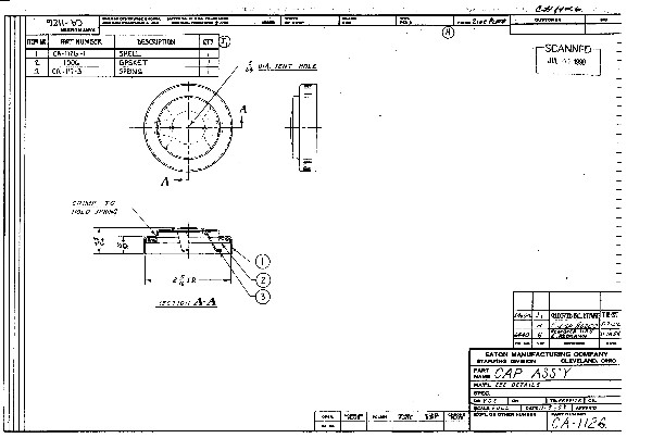

    I have been doing some research regarding the cap listed on this thread. It looked correct except for the chain attachment. I found another cap that looked correct without the chain and had the company send me the print drawings for both. The one I found that looks identical has what appears to be the correct dimensions. It is cap CA-1126 that you can see in this link: http://store.capsnecks.com/ca1126.html
    While looking at the two drawings I noted on the other one, with the chain, that revision dates go back to 1947 and noted Eaton was originally in Cleveland, Ohio making me think they may have been the original suppliers to Taylorcraft.

      Re: FYI--- Gas Caps
      I will see if this scan is better...

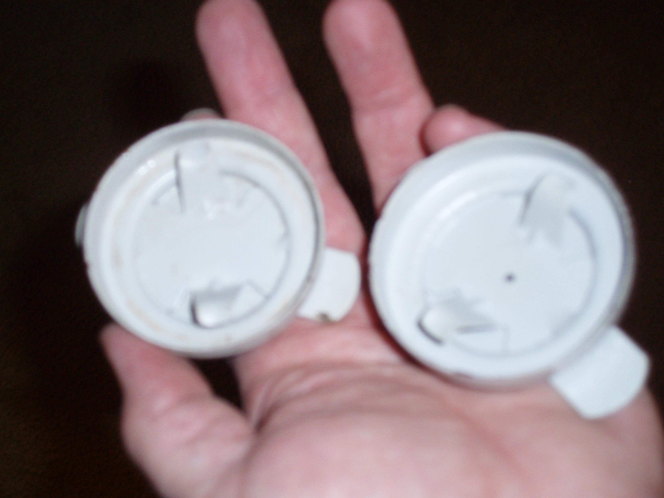

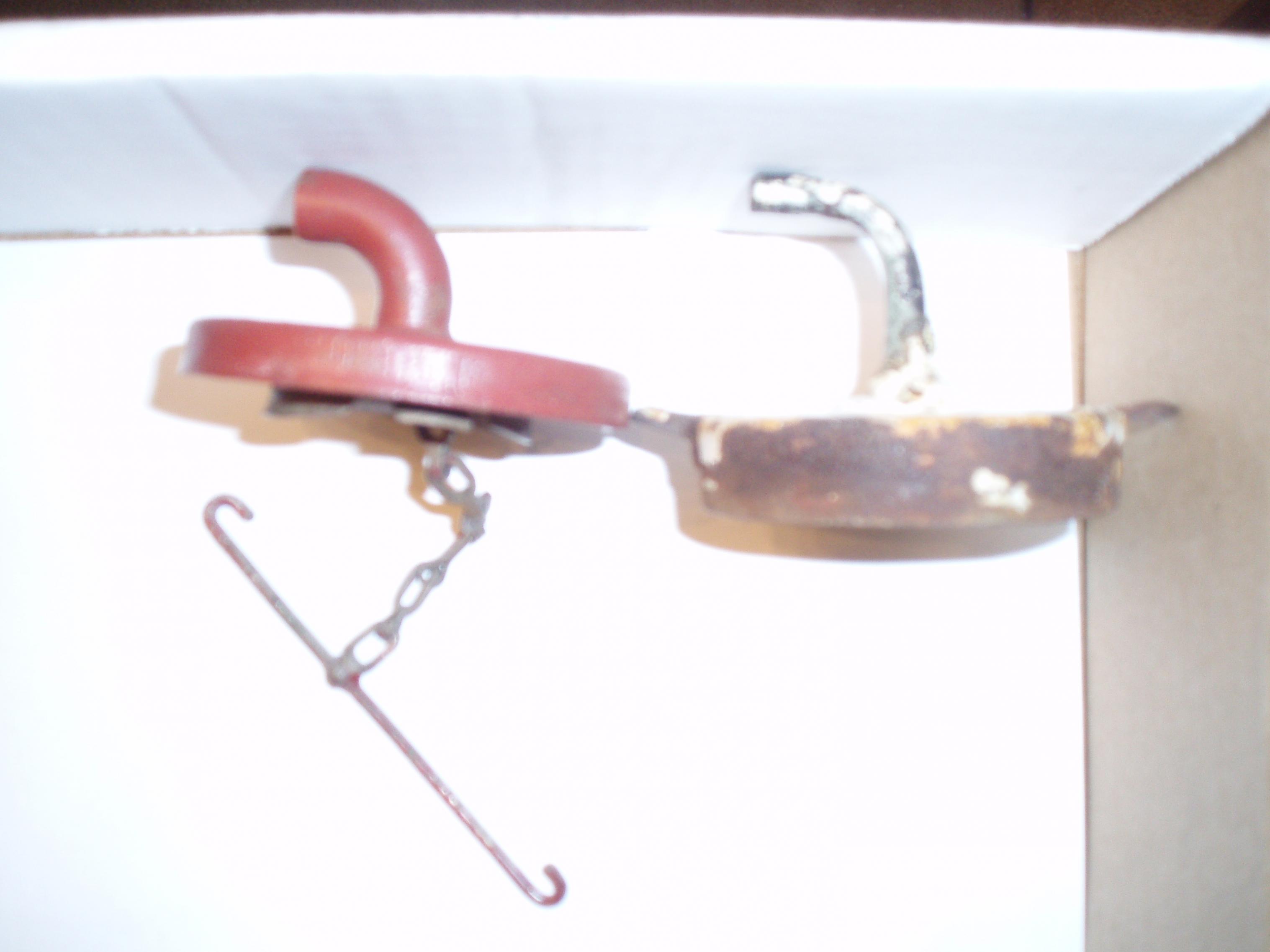

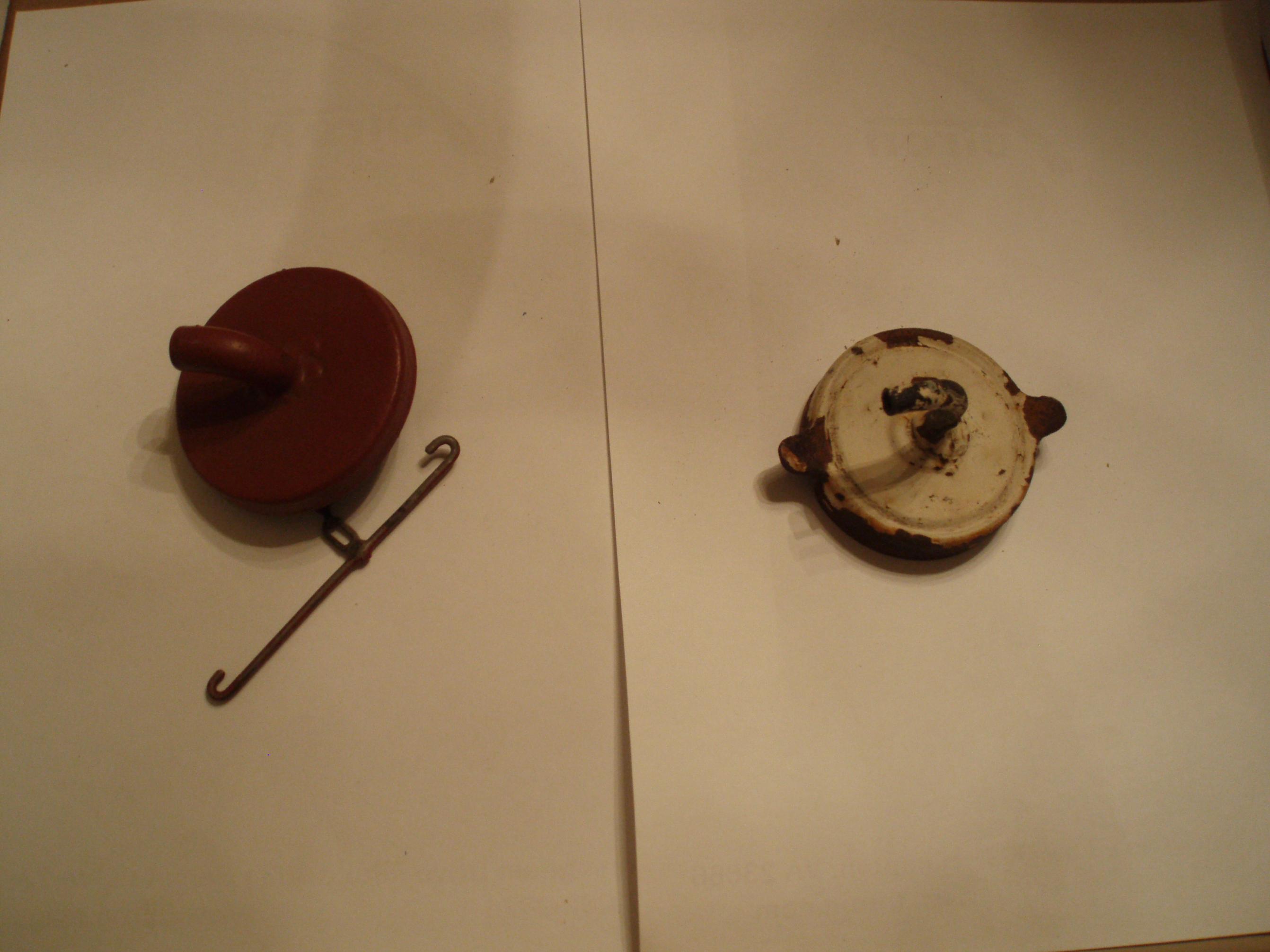

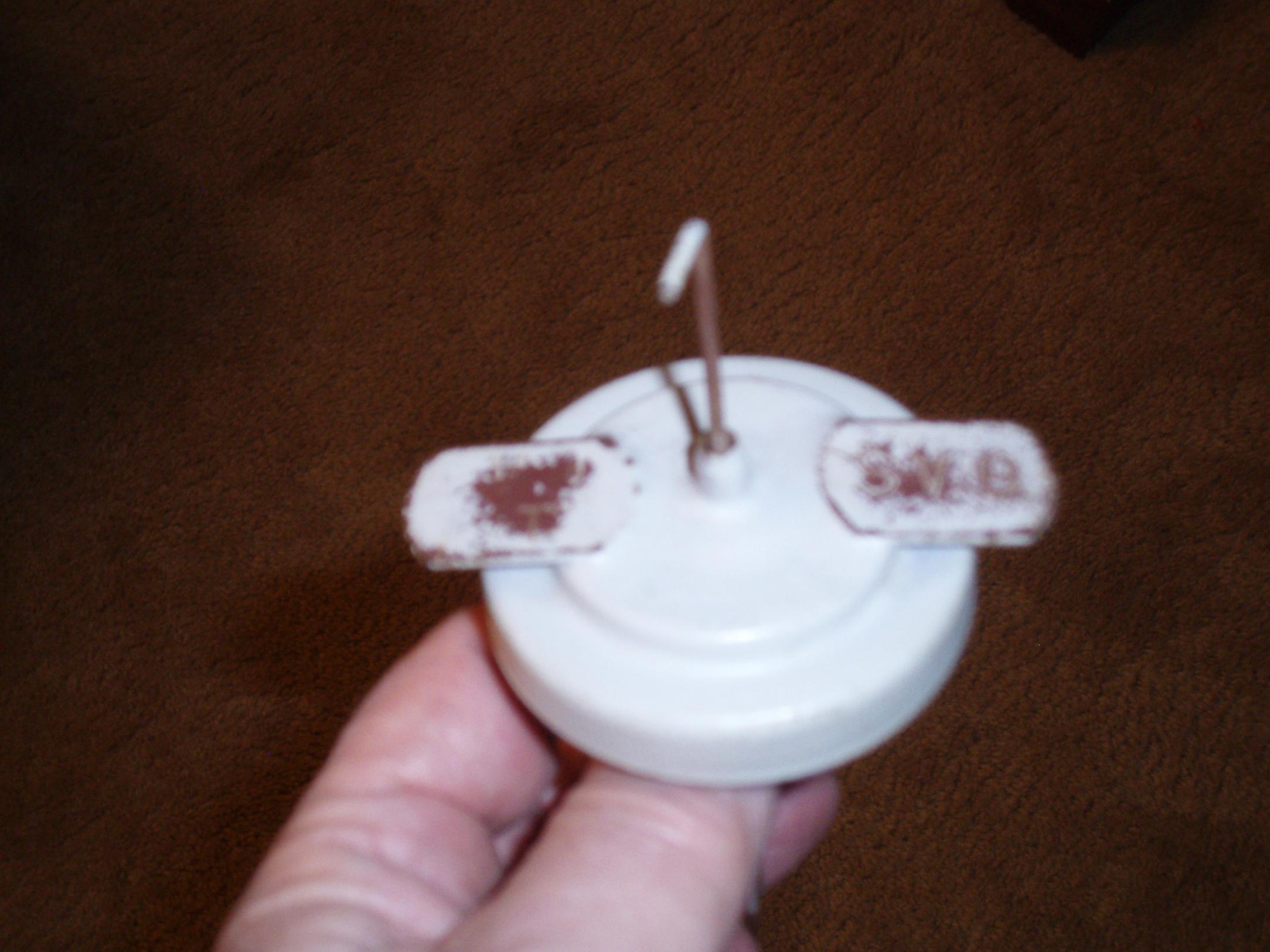

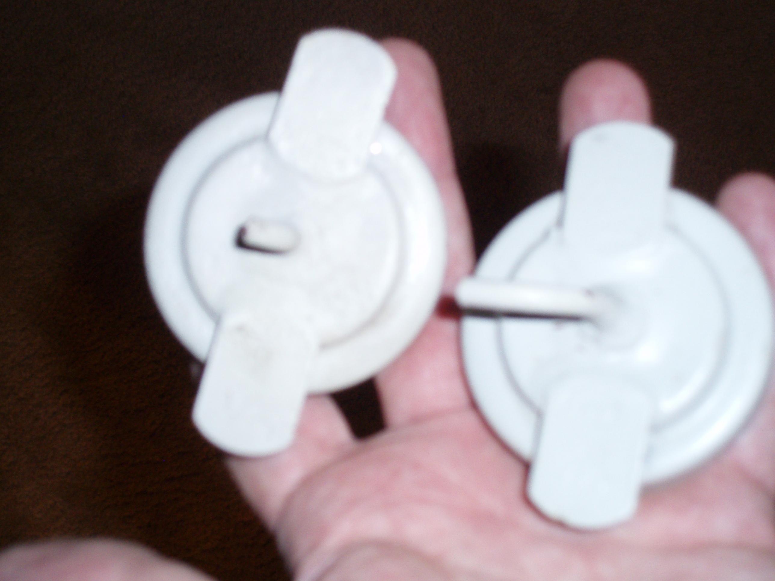

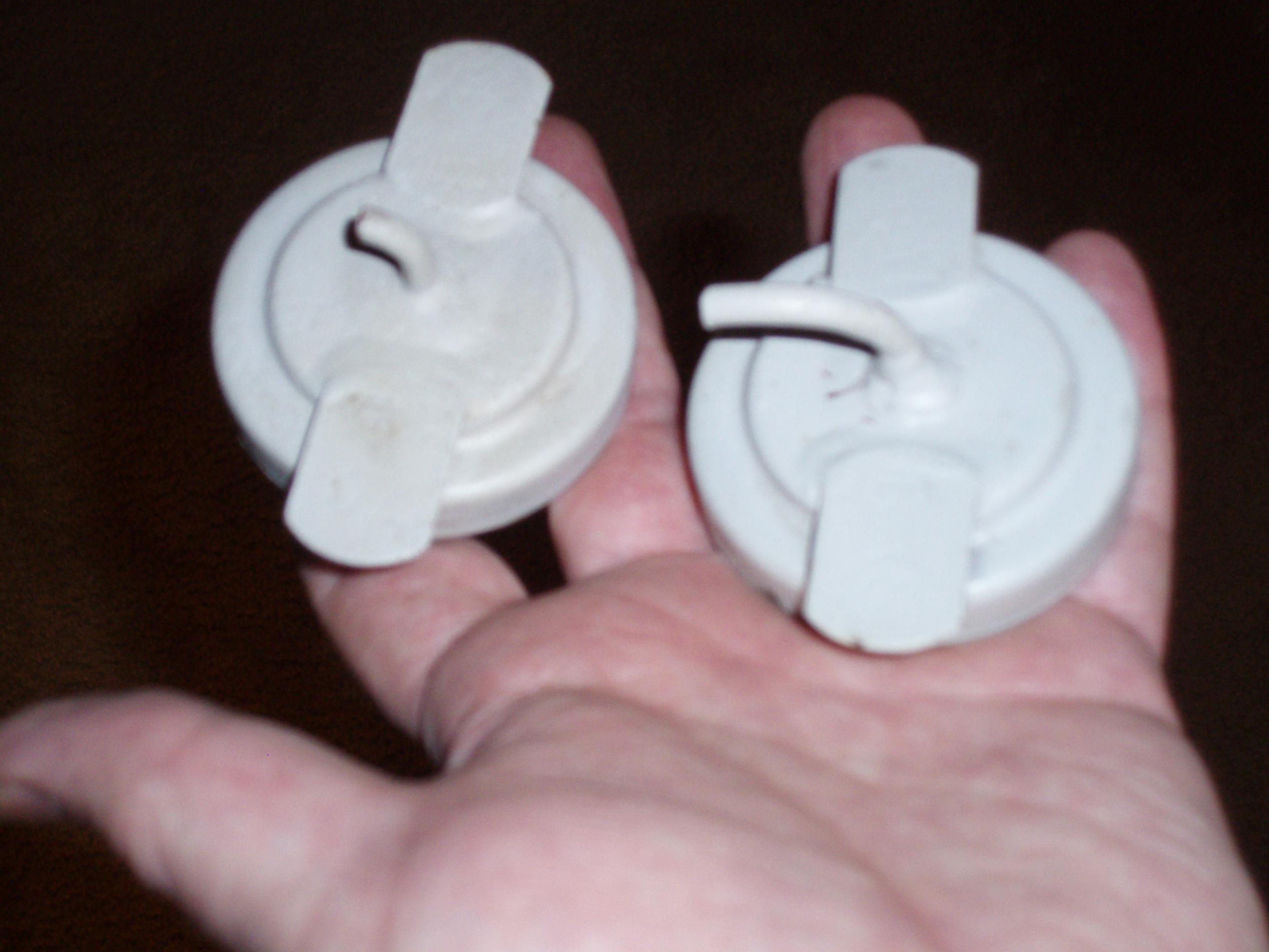

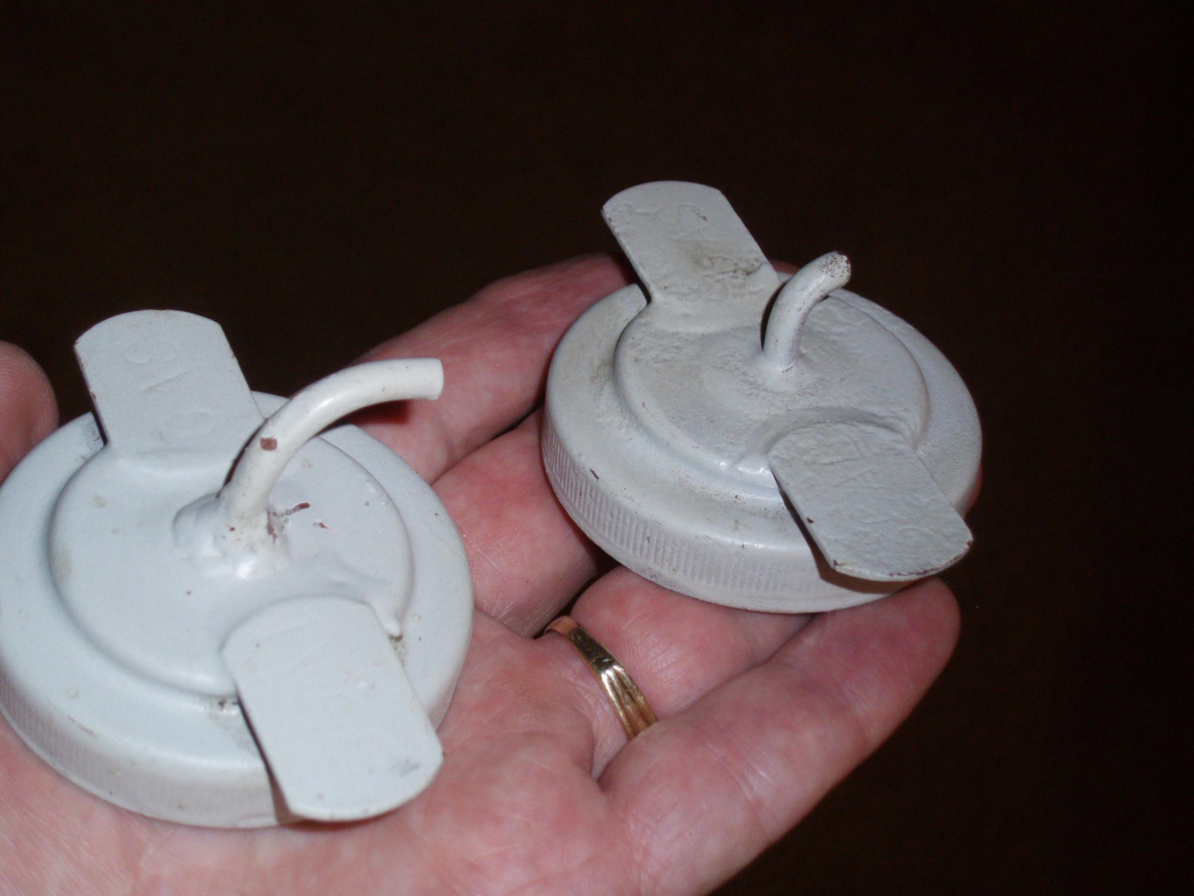

                          Made it out to the airport today and finally found the fuel caps. I think they may be based on the caps you found. If so I will have the originals at home and should be able to get details on the markings for the tabs so you can have the markings engraved in them before you braze them on the caps. The engraver I have been working with should be able to do it if you don't have someone there to do it. Let me know what you find out on the cap availability ad cost. I have a guy here who needs one too.
                            Re: FYI--- Gas Caps

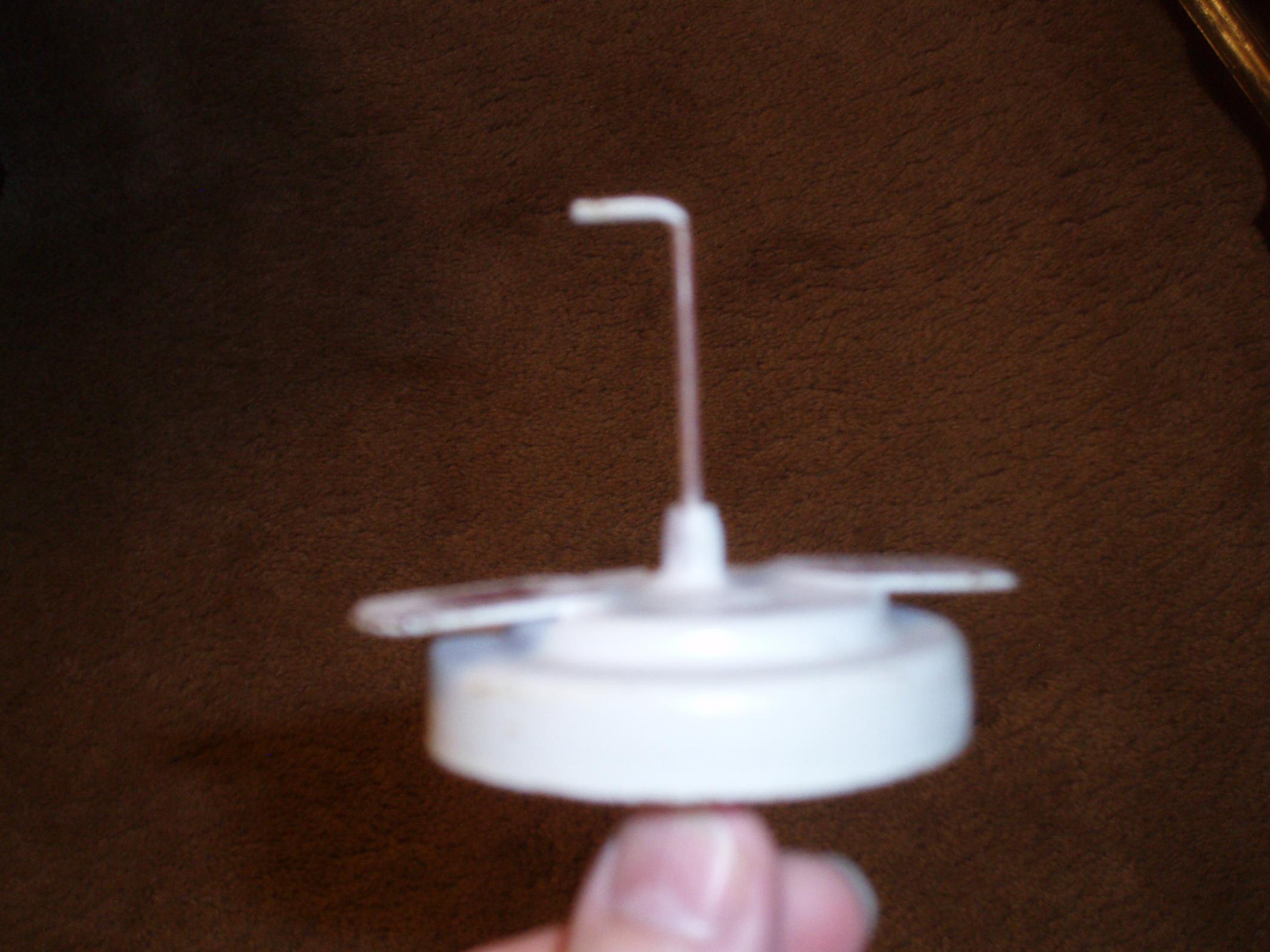

                            Tabs on the main cap say "GAS" and "12 GAL"
                            The wing caps were slightly different. They are based on the same basic cap with a breather tube. One tube looked to me like it has been cut shorter. The tabs on the cap say "GAS" and "6 GAL". One cap has a hole drilled through and the other breaths around the arms on the bottom.

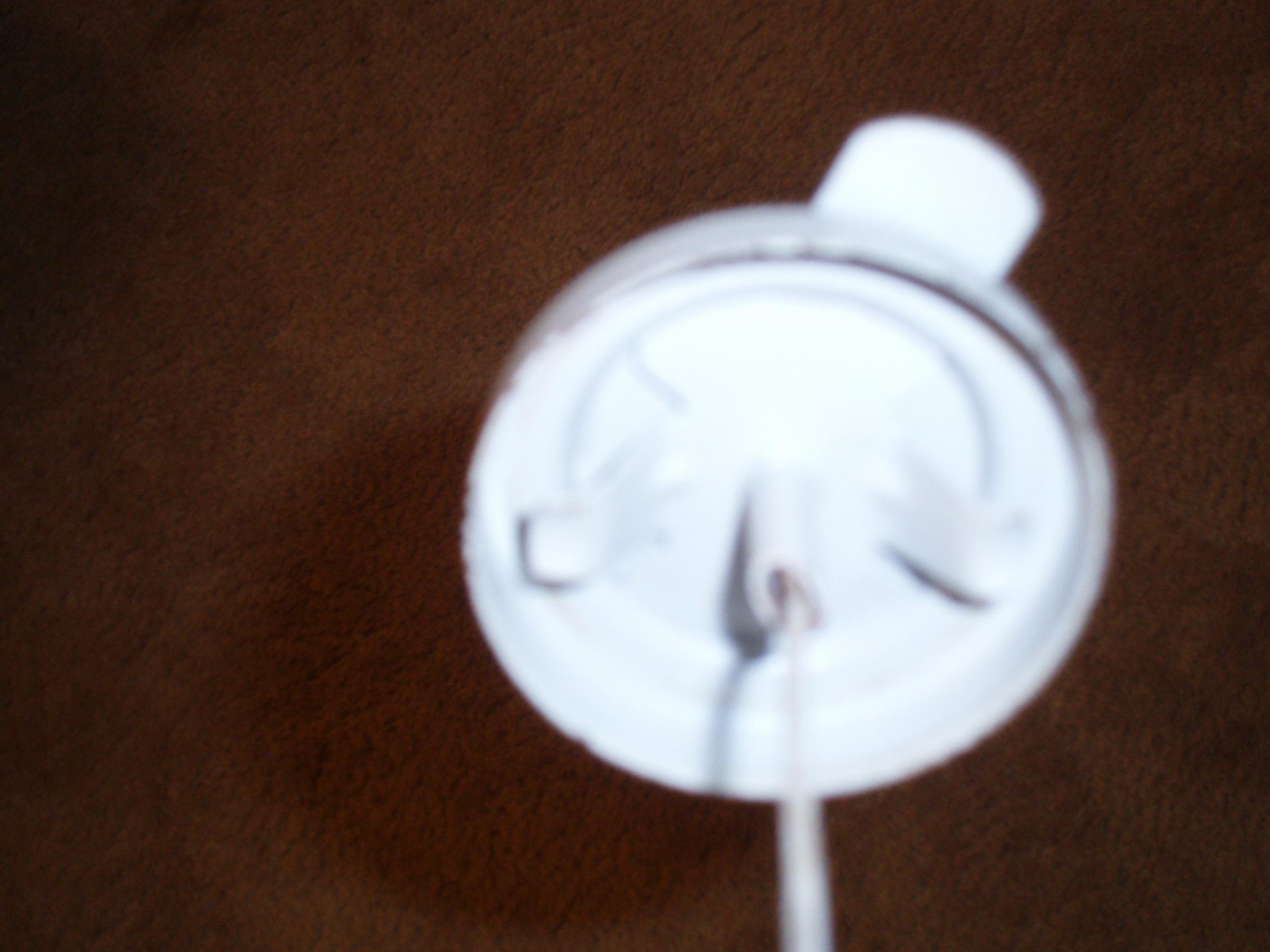

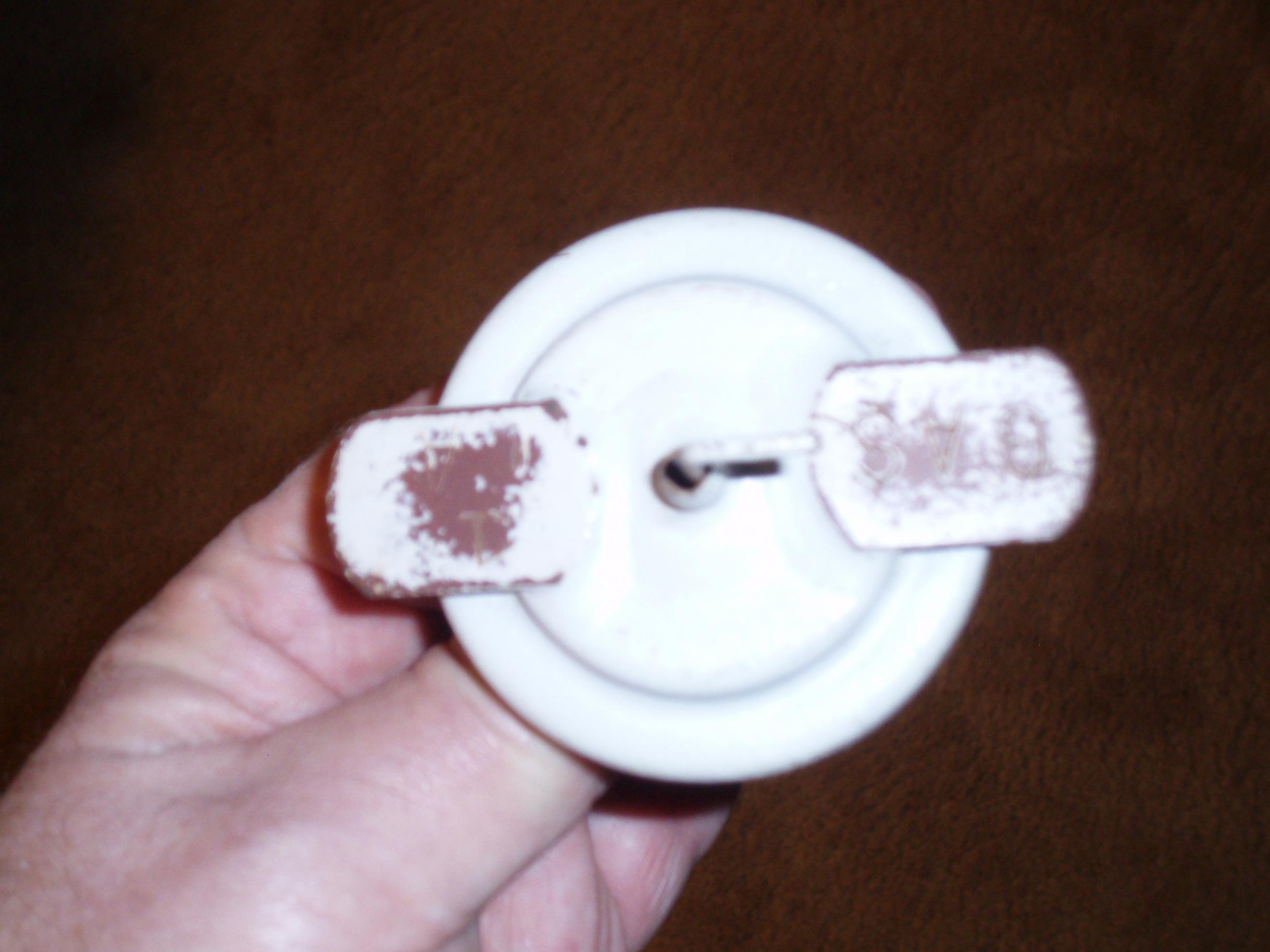

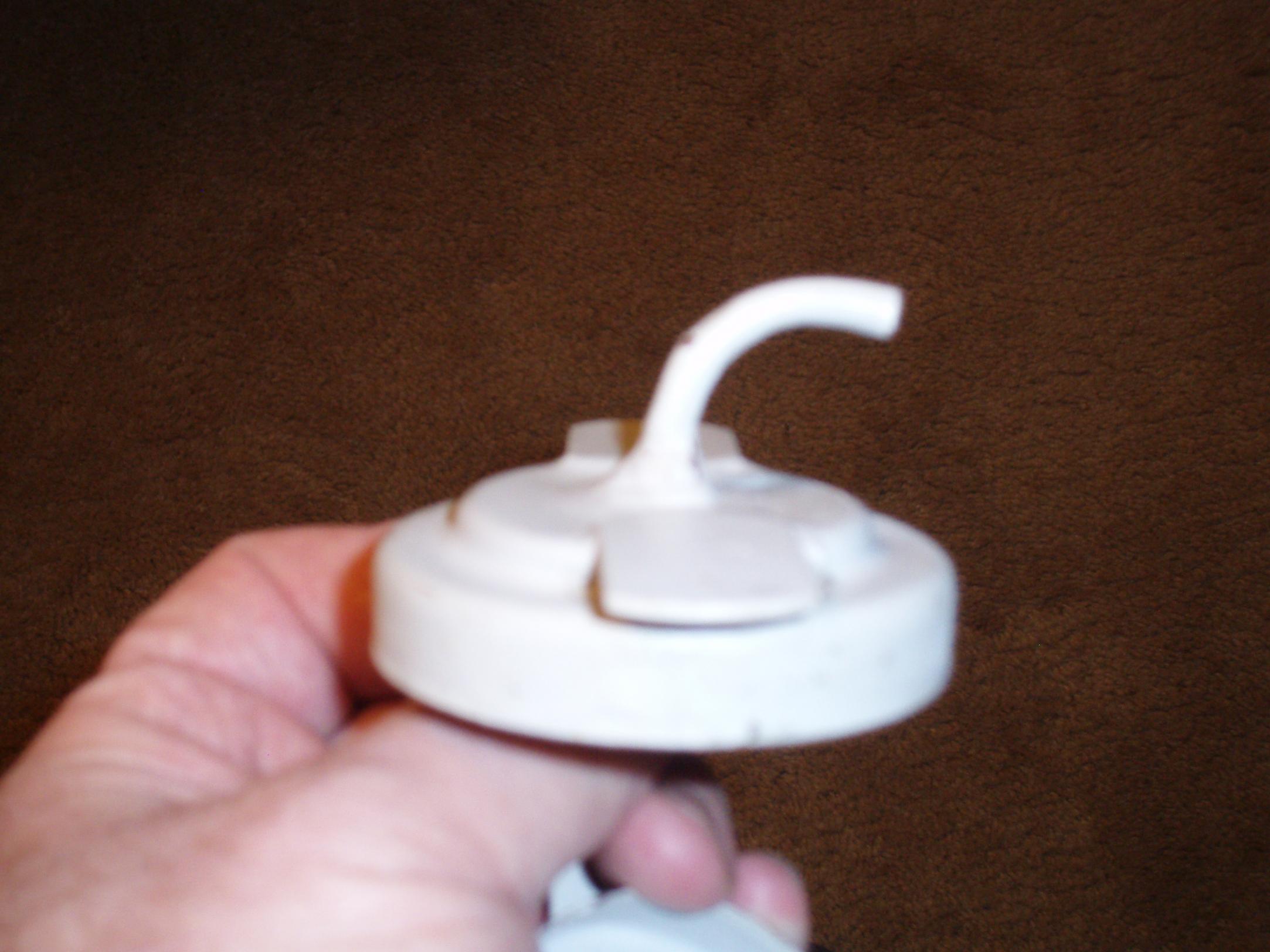

                              Re: FYI--- Gas Caps

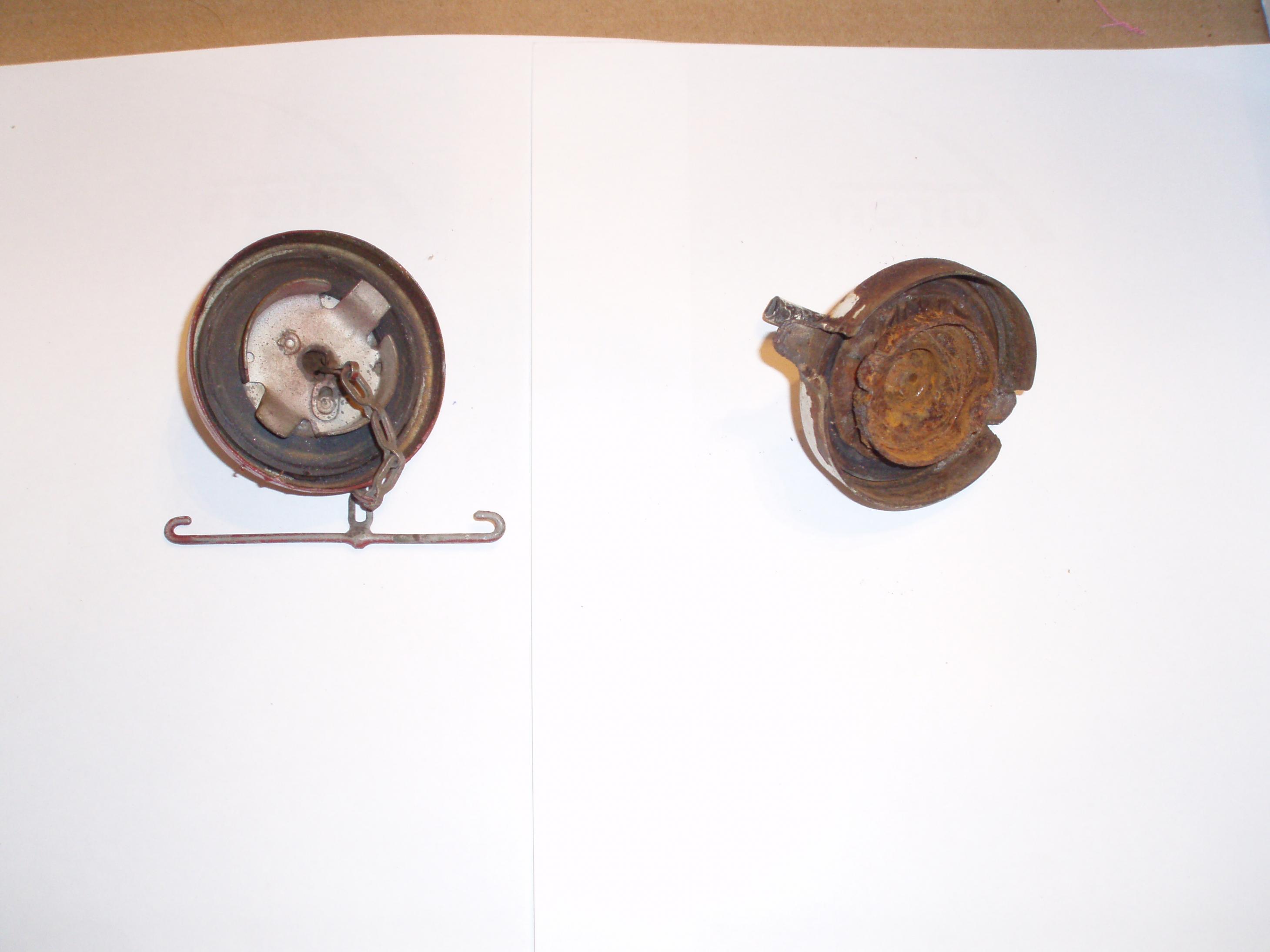

                              OK, One more set. The previous ones were for a post war plane. These are some extra caps I had with my 41. The one with the HUGE vent tube was on it when I bought it. I'm not sure where I got the rusty one. The main cap looked like the post war one (in fact I'm not sure which one is which).
