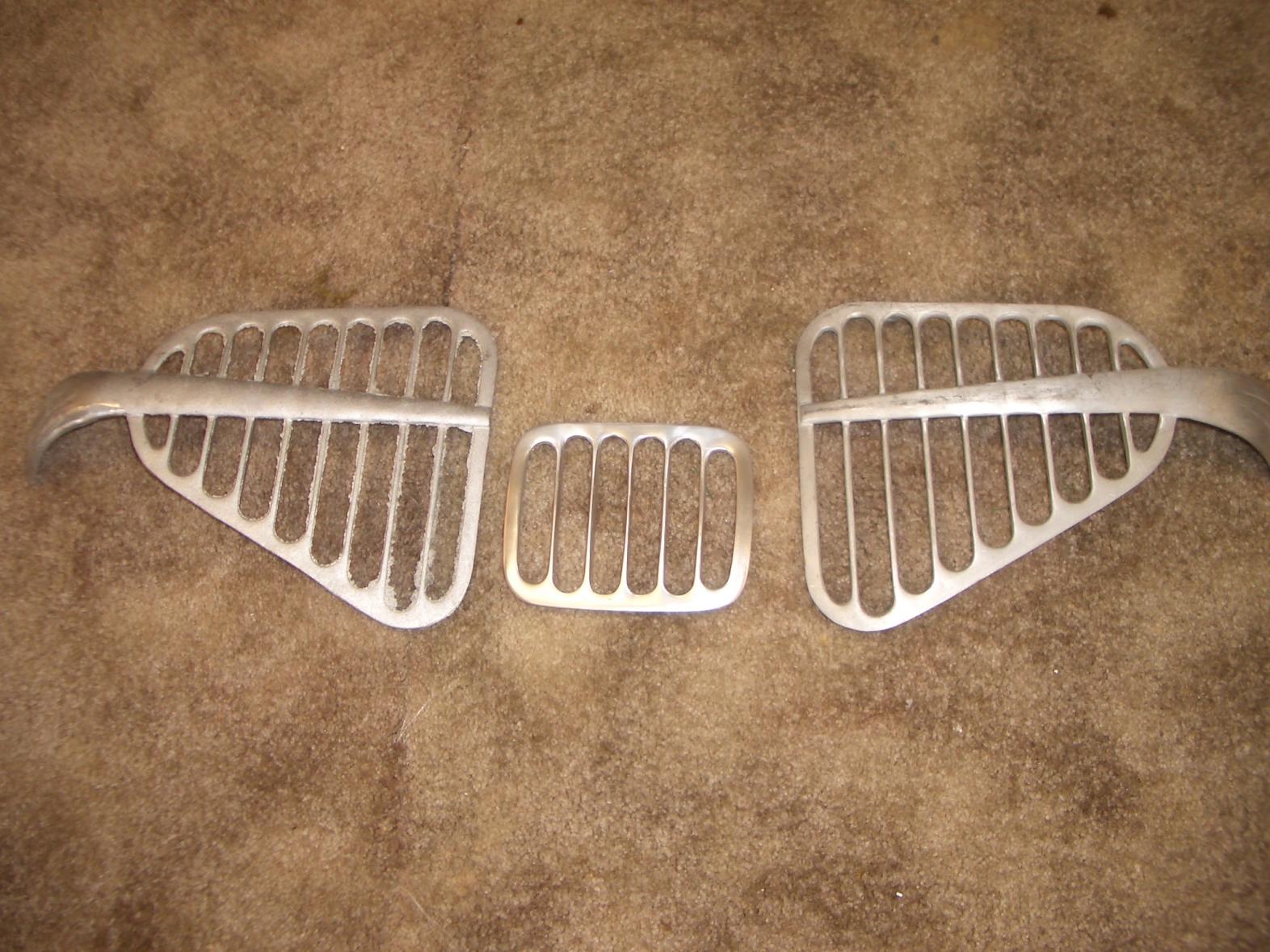

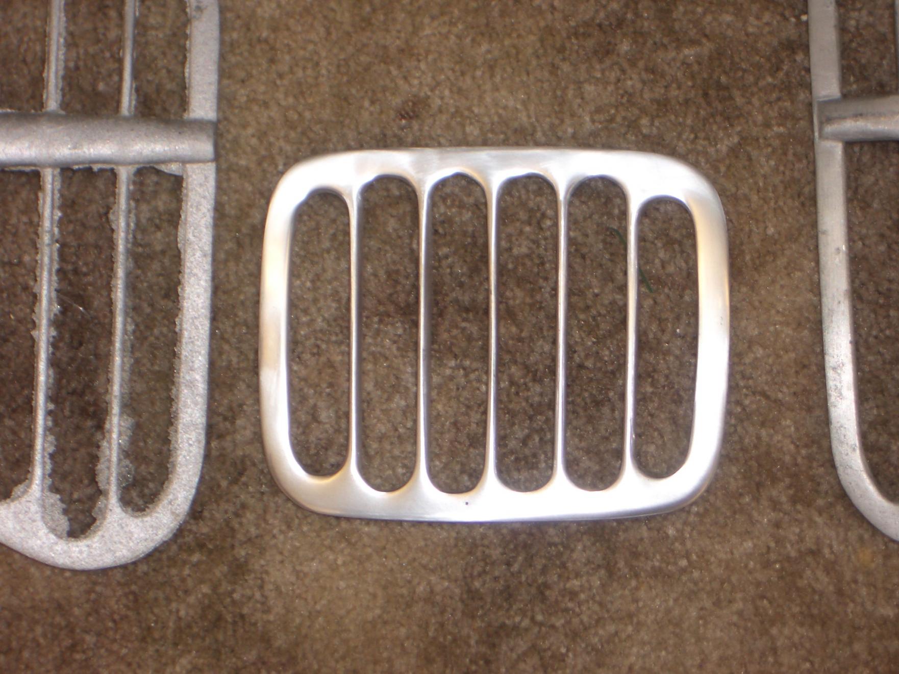

              The grills on ebay went for $171? One was broke and all were ruff cast needing the ol'sweat and polish. Here is where I am, on my odessy of sand until your arms fall, take a day off and do it again, and again, and again, and again. I have; since this pic. finished putting a high polish on the center grill and have moved one of the side grills in to the sanding for ever position and have just started grinding off the flash on the last one. After they are all polished to the chrome look I will let my buddy at the body shop clear coat them. He does show bikes this way and it looks like chrome and the aluminum will stay that way with out any more polishing for years even if left outside!
              Larry
                Re: Cast & stamped cowl grills on eBay
                You are doing nice work Larry! Mindless, tedious work is good for the soul. You will be set for a career in Government service when you finish.
                I have a set of those rough cast grills and it is good to see that there are some nice parts under all that flash.

                        Polishing isn't all that bad. My center grill was dull when it came with the plane but a little 0000 steel wool and buffing wheel work and you can see yourself now.
