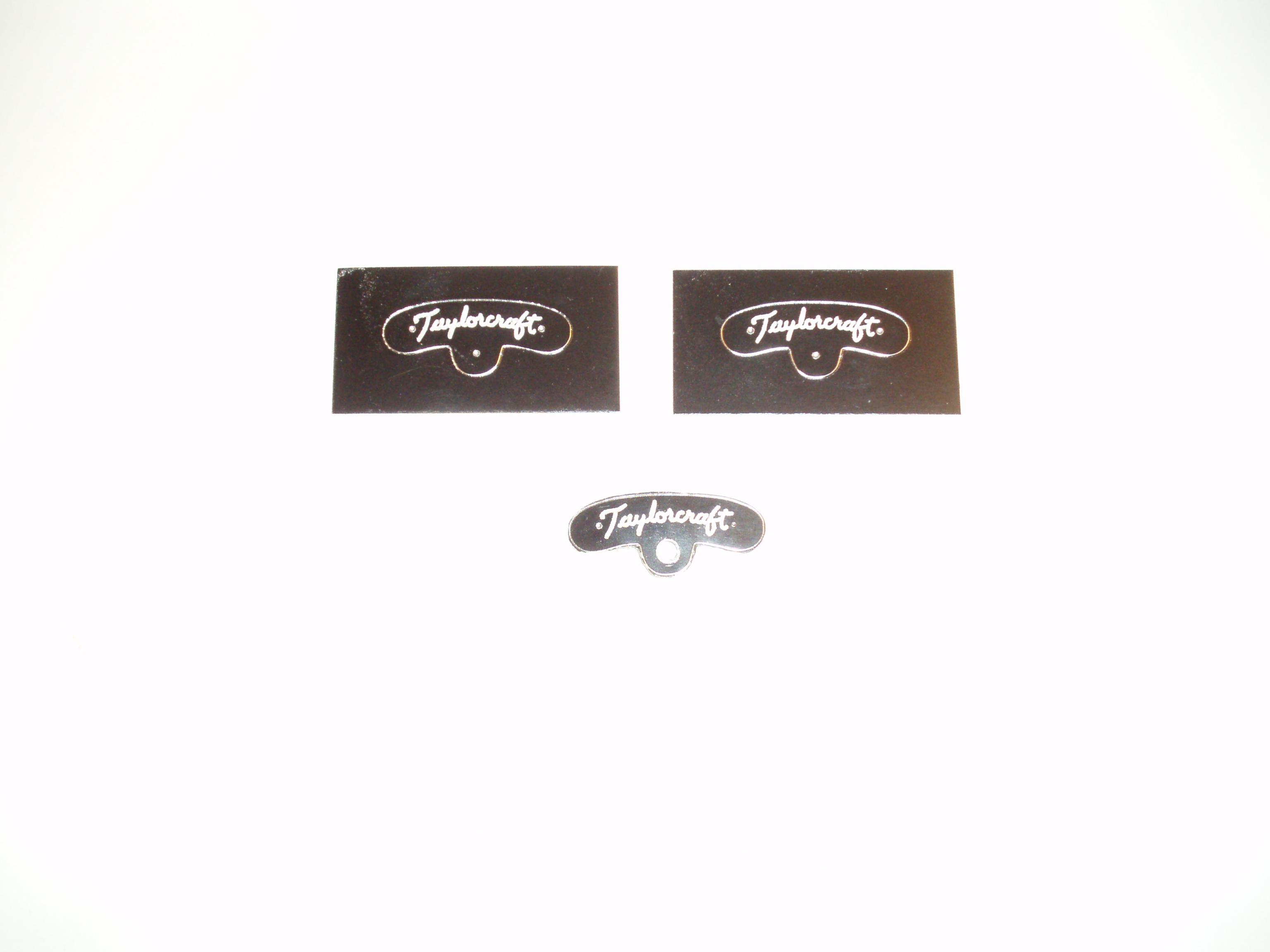

    Some time back I mentioned on another thread I was getting some placards made for the cockpit of the 41. I wasn't happy with the sticky back paper stuff that I had for warnings, limitations and all the other "stuff" in the cockpit.
    The first one I wanted was the Taylorcraft logo on the front of the large bubble face compass (my original was a mess). The first samples are back from the engraver and came back looking great.
    Several folks have expressed interest in getting copies of different placards and the engraver has all the artwork programmed and can make duplicates fairly fast now. The first one was NOT done very fast!
    Anyway, I have 4 right now and can make more. All I want if you are interested is the cost to make each one and a little towards the setup and programming cost. He can make more for about $5 each and the nonrecurring cost was about $50. I plan to use two for my two planes and will probably make a tie tack with another if no one else is interested.
    Next on the list is the 140 MPH limit "Wings". I have also finished the artwork for several others that are coming.
    I'm also starting to learn a new skill to make the raised burnished brass trim indicators. No promises on that one. I will probably ruin a lot of nice brass sheet before the first good one comes out!
    Anyone interested let me know and I will start figuring the final cost for the compass logos. The more he makes, the less they cost. I'll post pictures of each as they are worthy of putting on our planes.

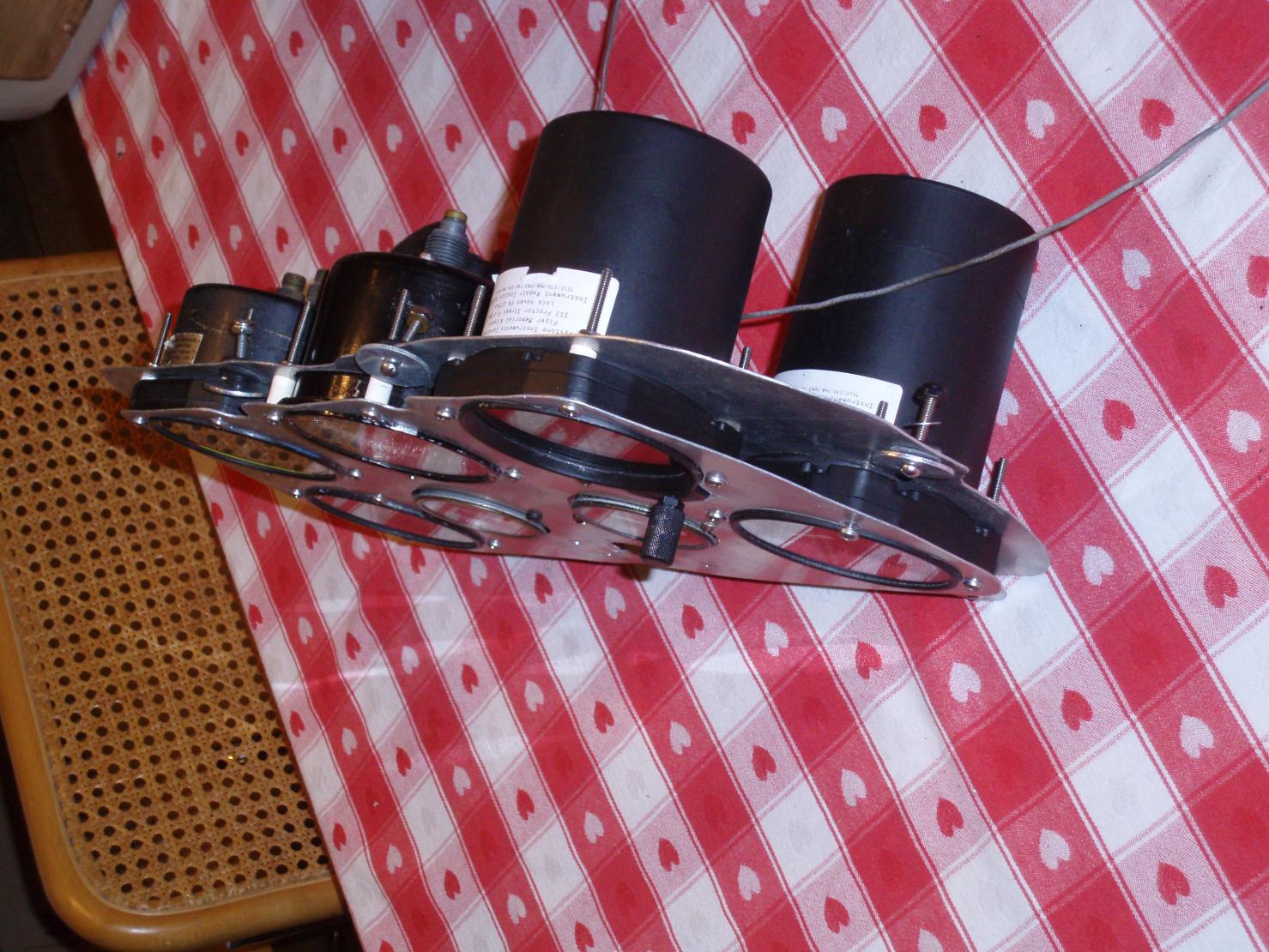

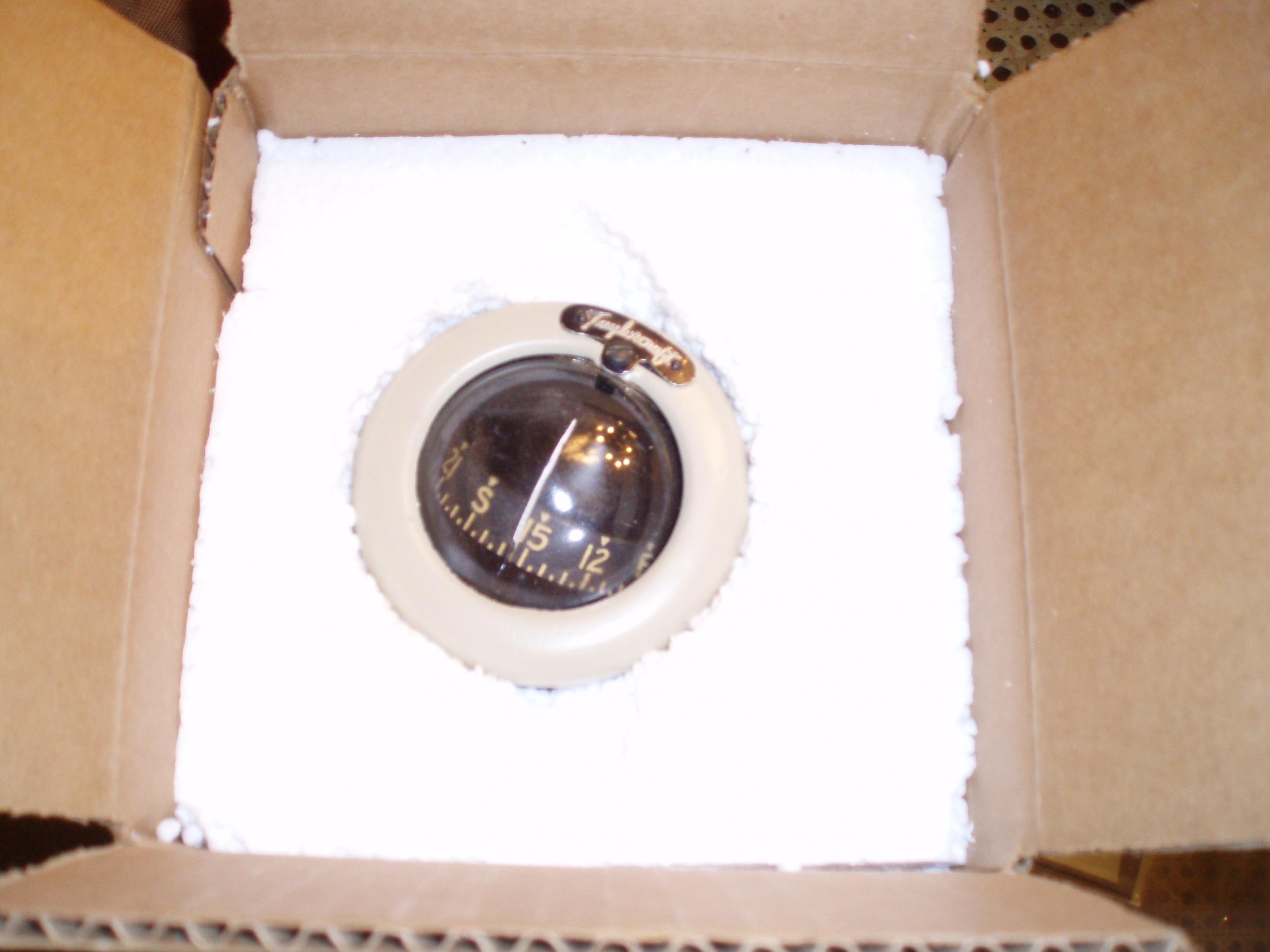

        The compass came filled and sealed so I wouldn't DARE open it up now! I just finished building up the instrument carrier (the 41 has to hold the worlds record for complexity of the instrument mount!) and set it up on the dining room table with the panel cover I made. What an exciting thing to get to finally see together on the last day of the year.
        Next is the mag switch mount and apply the 140MPH "wings and mag switch plate (the one in the picture is just printed on paper, the engraved one isn't done yet).
        By the way, the Alt, ROC and Compass were the ones Keystone overhauled.
        COMING TOGETHER! WING STRUTS NEXT!!!

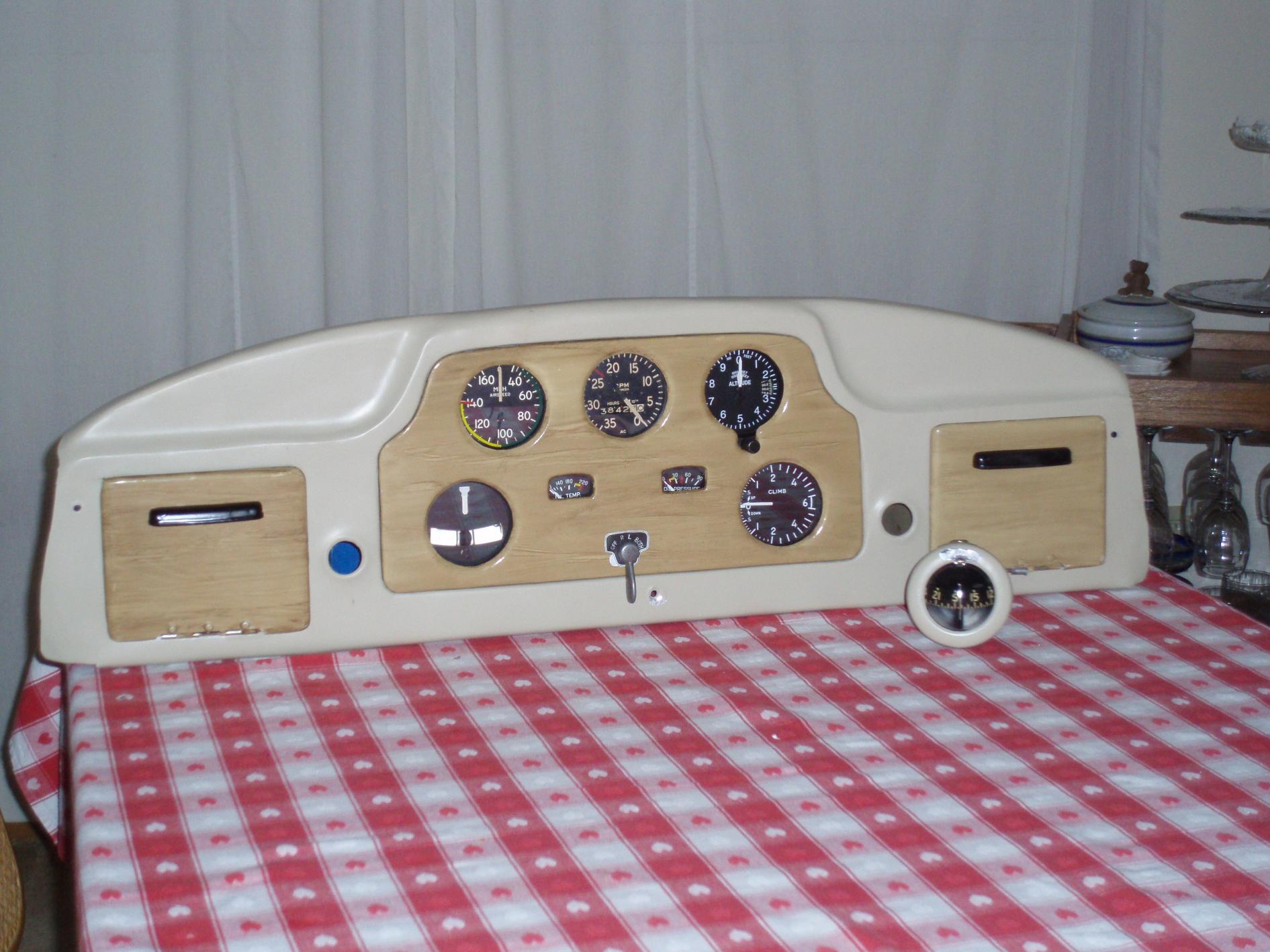

                          That is a beautiful panel. Long time since I have seen a complete original panel done right. The solid color should be a little darker based upon the original panel I have here.
                            Re: Engraved cockpit parts
                            Thanks for the kind words. It's a long road with a LOT of details left to do. I plan to focus on what is needed to get her FLYING and do the goodies in the bad weather this winter. The 41 was originally supposed to be practice for the real restoration on the 45, but I have really fallen in love with my pre-war baby.
                            In the photo there was actually so much glare on the panel under the dining room lights I tried taking one with the lights out and used the flash only. It came out nice and clear, but makes the panel look a little lighter. You can see that the glove box door handles are also black, which is not right. They have now been repainted the same "putty" color as the main color on the panel.
                            This was my first try and faux wood grain and I got a little carried away. My mother is a pretty good artist (painted "nose art" on ties and bomber jackets while she worked in a munitions plant in WW-II) and I knew she would be casting a critical eye on my work. When I painted the wood grain I even made the side edges of the doors and the edges of the instrument holes look like end grain. I got a piece of wood and made the parts from that and copied the appearance. Must have worked. When a buddy saw it he asked why I used real wood instead of faux painting metal parts like the original. Neat feeling when he rapped the metal and jumped when he realized it wasn't real wood.
                            Got to wonder how much is too much. She (the PLANE, Not my mom!) is a long way from when she was voted ugliest Taylorcraft in the tribe. Didn't loose that title till someone found that one with the tree growing through the fuselage!
