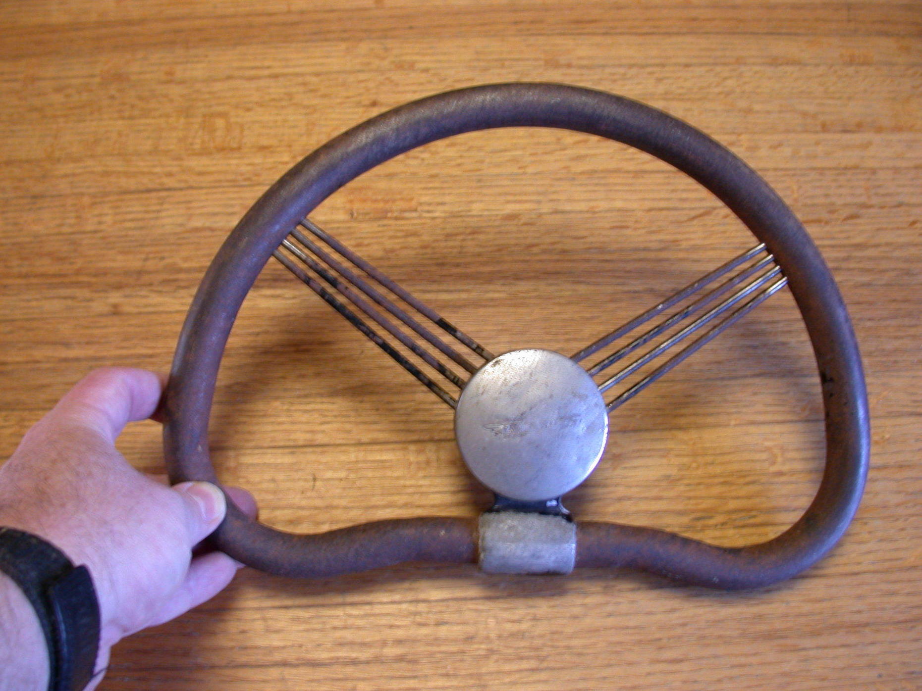

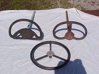

    I have to wonder how many of the cast wheels are cracked , fixed with Bondo and painted. I have a few of the cast late wheels and ALL are cracked under the paint! The pretzel wheels with the center ball seem to stand up well, even though the ball falls apart. The round wheels were only on the really early planes and are hard for current size humans to get their legs under. The REALLY fancy Banjo wheels are REALLY hard to find and expensive to restore.

      Thanks for the info Hank, i believe that Univair has some new version of the pretzel wheel that I have always liked. They sell the center caps too. I think I'll go that route. They say that they will need to be reamed and are set up for a 7/8 inch shaft. I measured mine and i came up with a 3/4 inch but maybe i was off. In any case it looks like they will work and i really do like the looks of them. You have a great collection there. I don't think i ever saw the banjo style.
