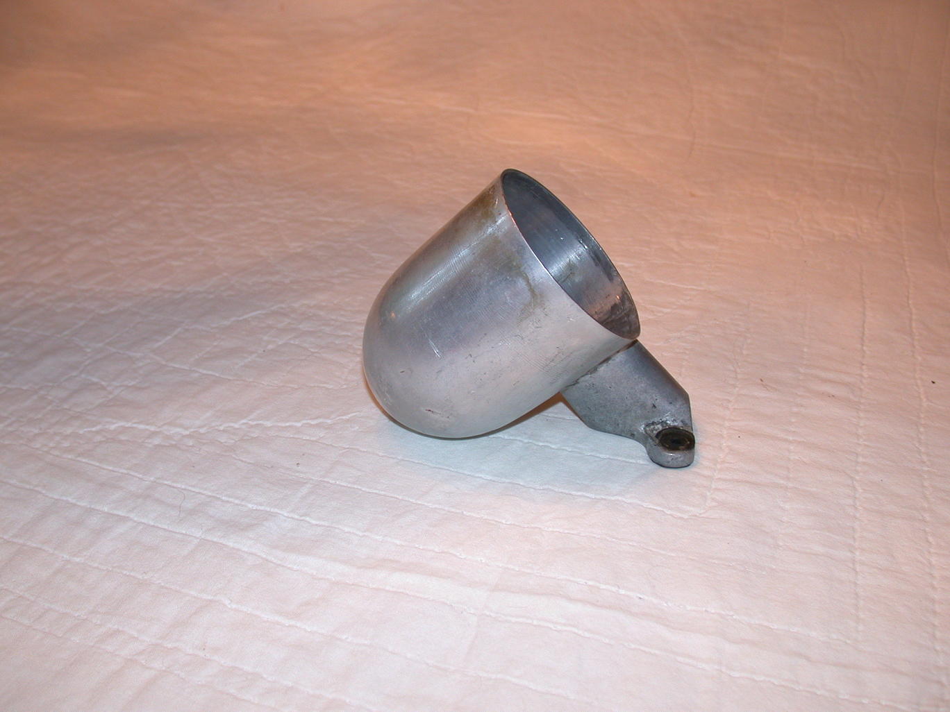

                  They are kind of hard to find, unless someone has one sitting on a shelf and doesn't even know what it is. Click image for larger version

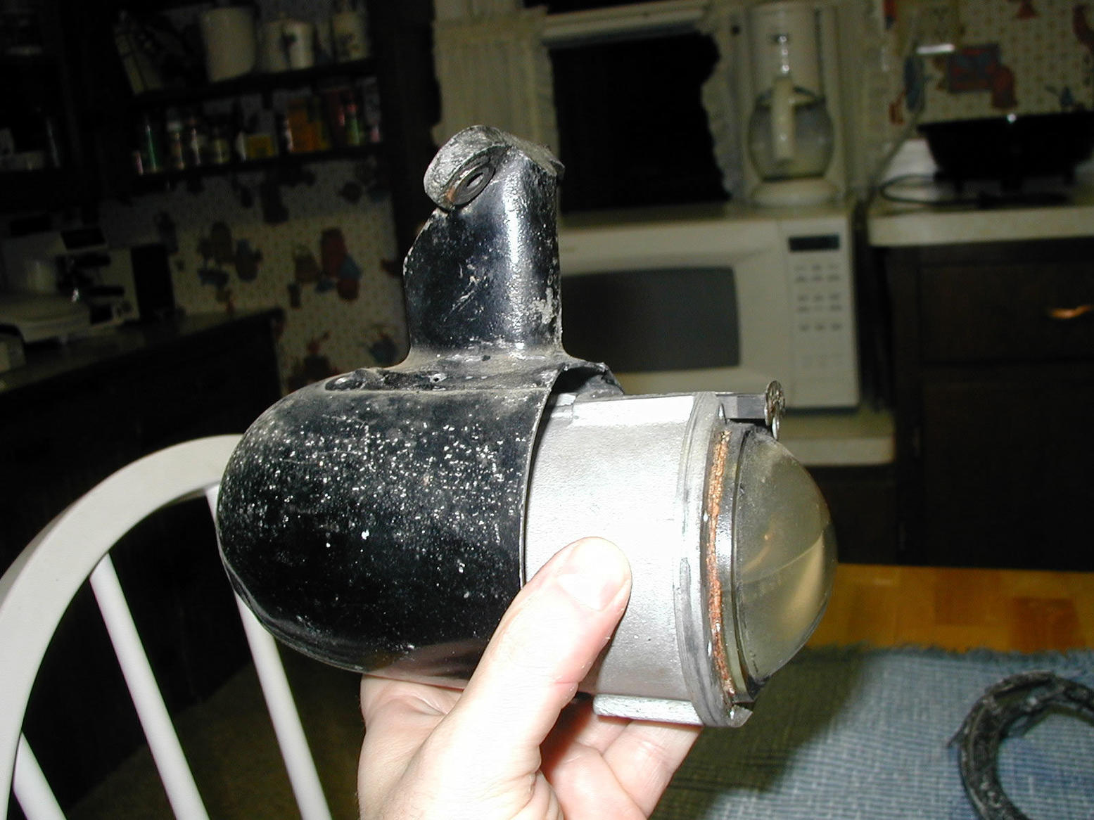

                      Click image for larger version  Name:	LCompMount1.jpg Views:	0 Size:	192.6 KB ID:	190075 The one in the photo above is in my 41 now. Photo taken after straightening, taking out the dents and damage and stripping the paint. This is what I started with.
                      Yes, the front face of the compass is off. DON'T DO THAT!!! It was loose when I got it and it is VERY easy to put the screws in wrong and crack the glass. You CAN NOT get replacement glass. I tried clear up to the contractors for NASA telescopes and no one would touch it, for ANY price.
