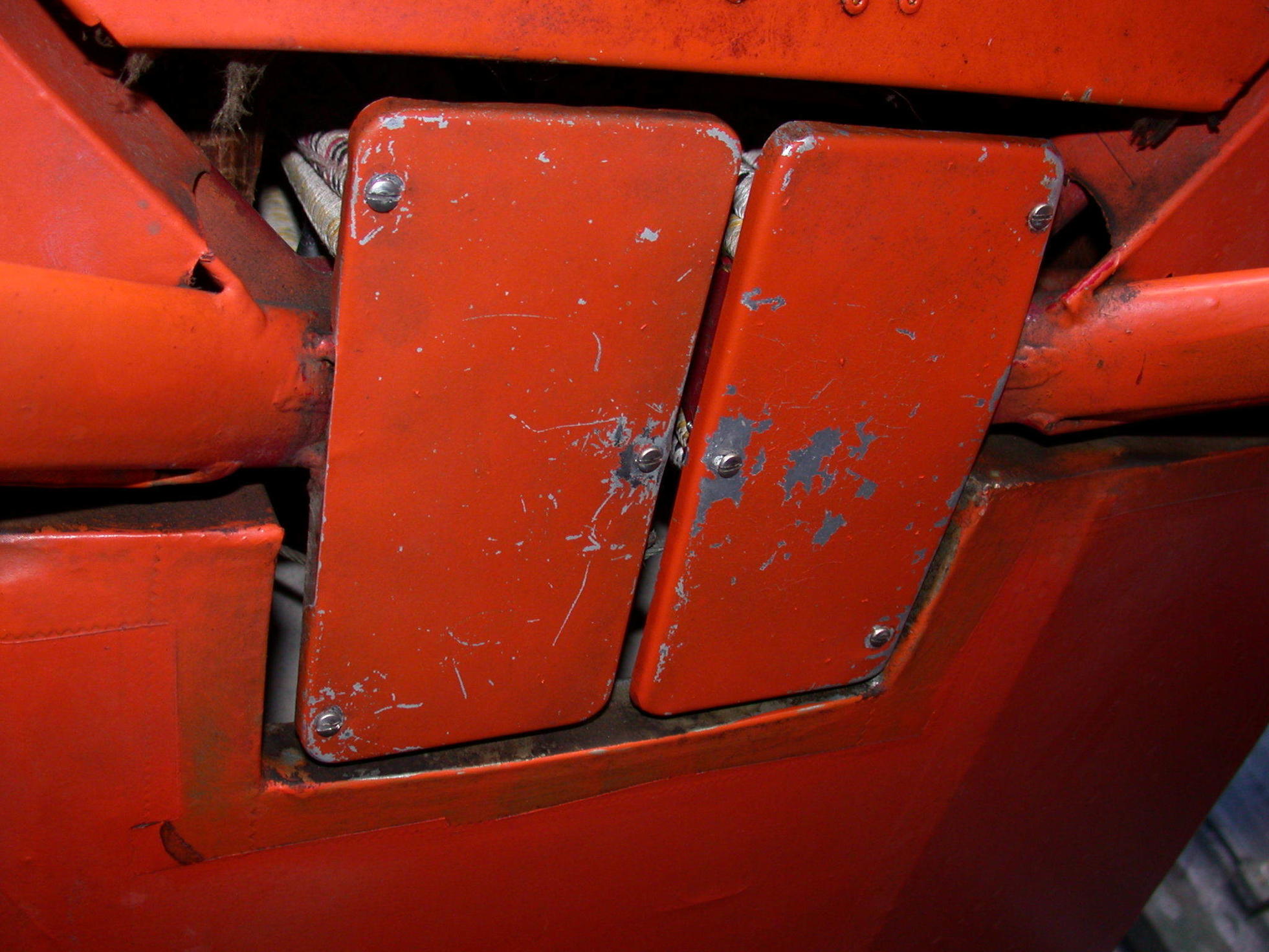

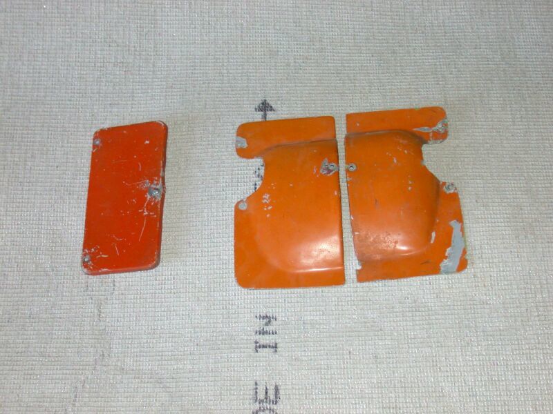

    Flat ones or domed? The flat ones are pretty easy to make. Someone here was selling the bulged ones. These are the pre war flat ones Click image for larger version

      The ones on the Click image for larger version
Name:	41 & 45 Bungee covers.jpg
ID:	188807Click image for larger version
ID:	188808 right are the post war curved covers
        Only the 41 deluxe had the flat covers. Other pre war had domed.

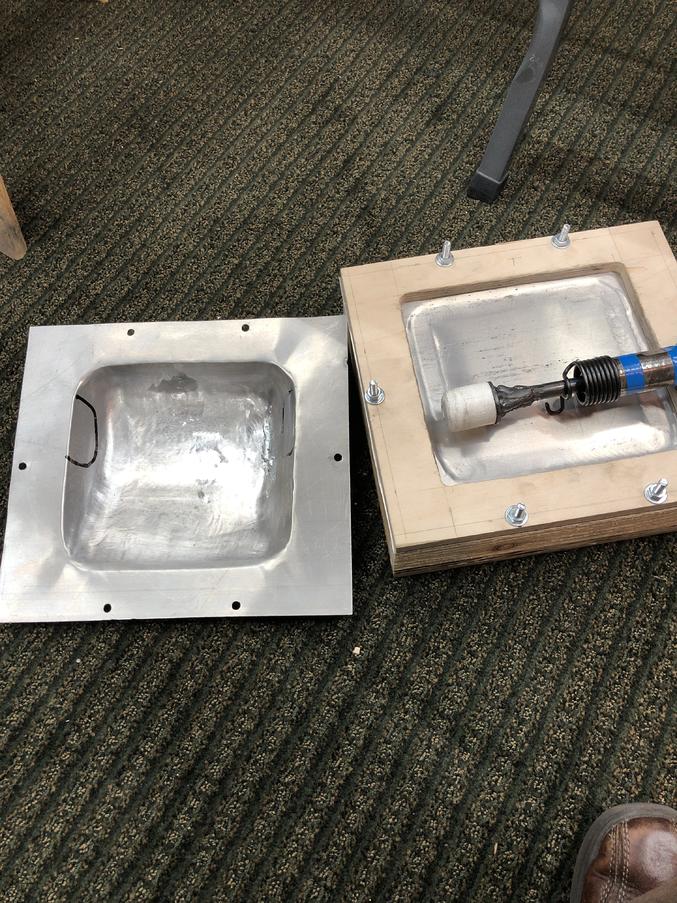

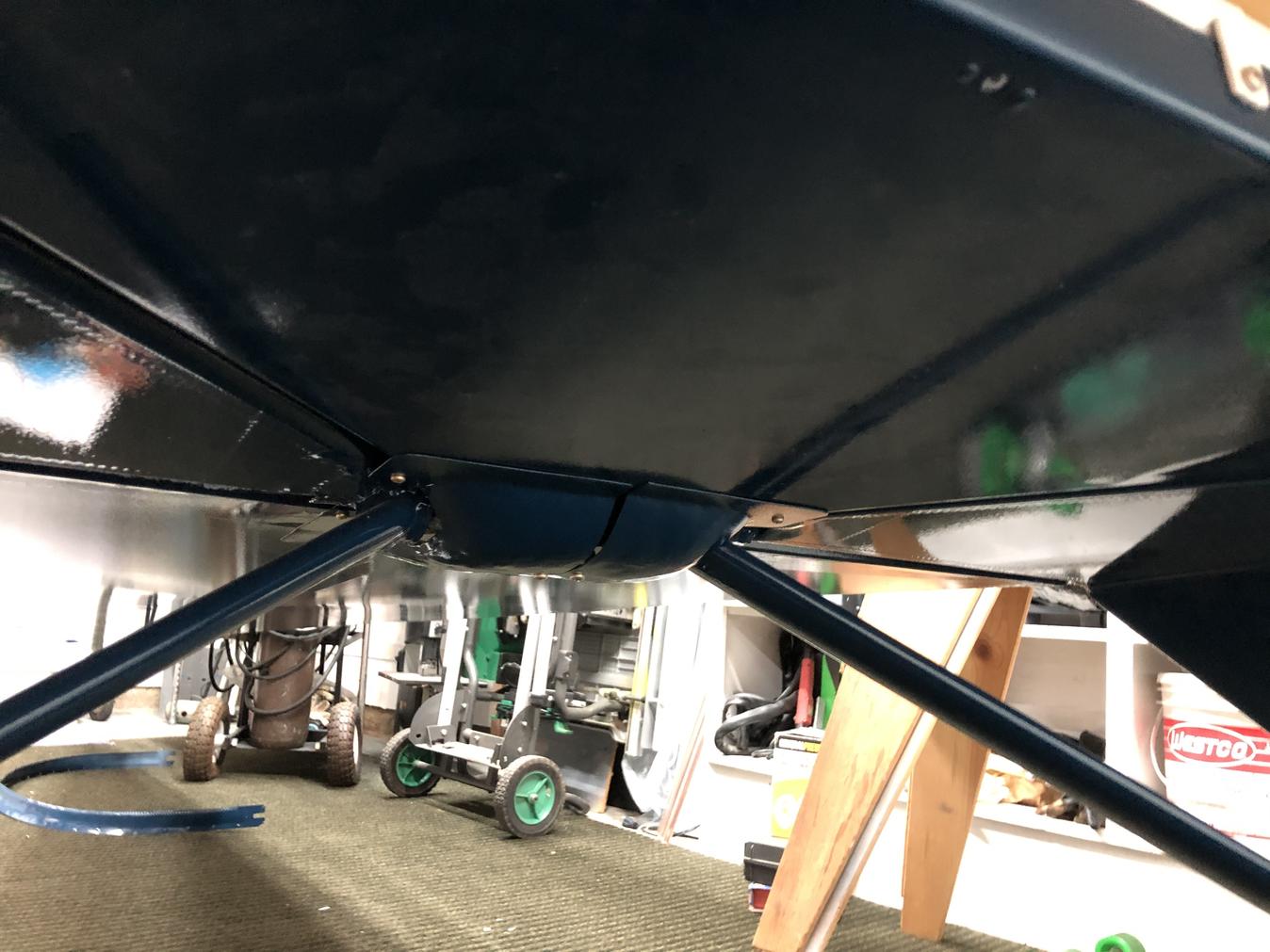

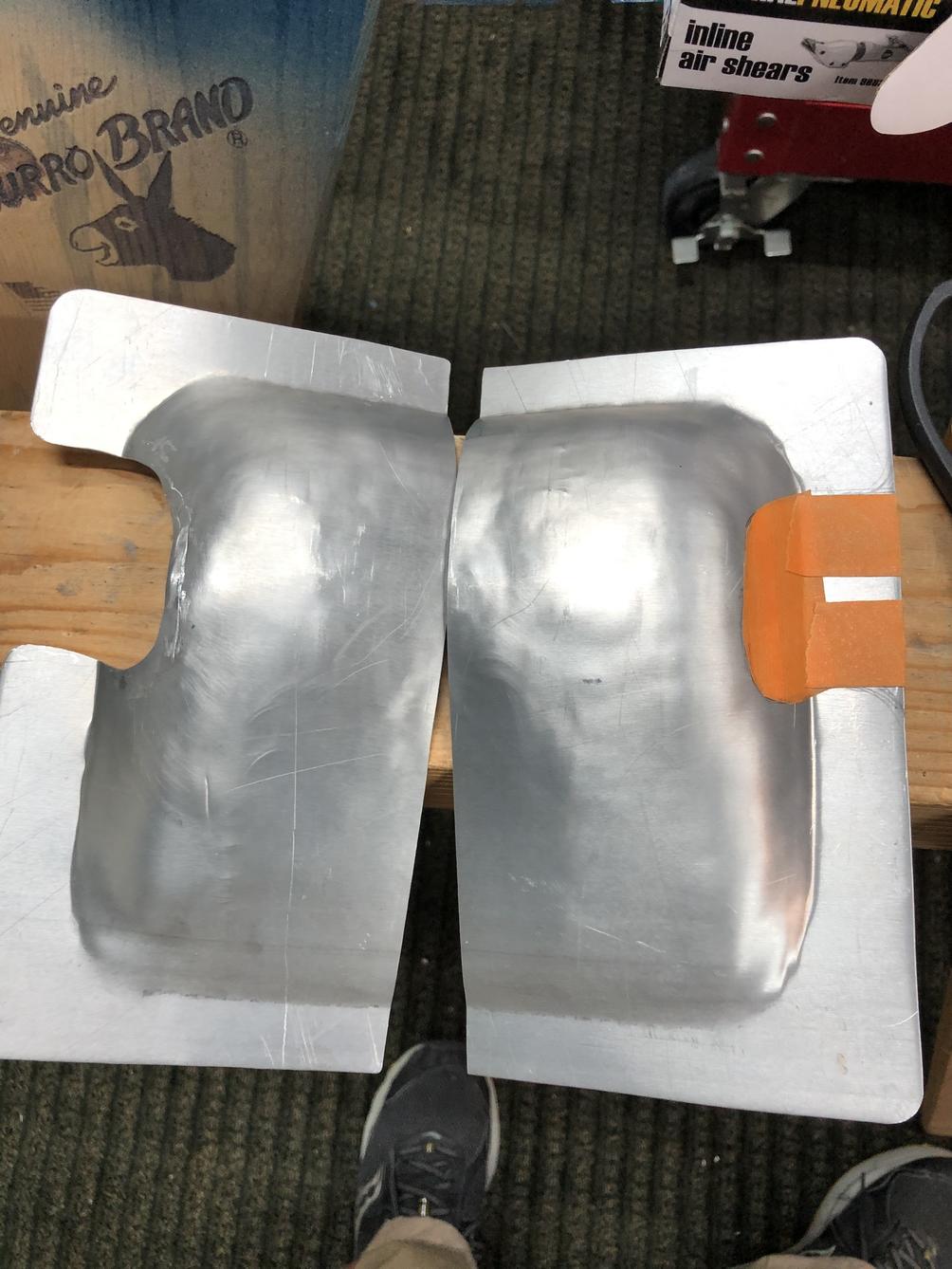

                Did you get a set of bungee covers yet? I recently made some new bungee covers for my Taylorcraft. I made an extra blank that is ready to be cut out if your still looking for some covers.
                  Nice work, Stacey. What alloy did you use? Did you anneal?
                  Mike Wood
                  Montgomery, TX
                  '46 BC12D
                  N44085 #9885
                    Mike, I believe it was .025, 3003 alloy. I did not anneal the metal. On both sets that I made, I ended up with a small tear in the same place. I used an aluminum brazing rod to patch the tear. If you look closely at the photos I posted, you may be able to see where I brazed the tear. Before color coating the set I decided to use, I further smoothed out the blemished spot with some body filler. Despite the small imperfections, they are much better than the beat up set that came with the plane when I bought it.
                    Flow forming the metal probably would have been a lot easier if I had annealed it the sheet aluminum I used or found a softer aluminum alloy.
