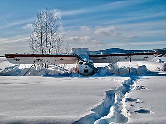

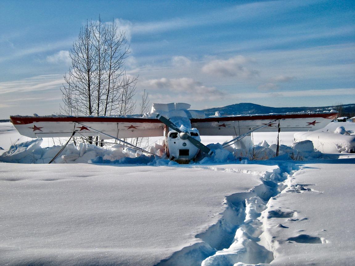

Thanks Hank for the comments. Life's too short for me to ride rusty especially with STC SA1-210's potential for a 1500 GW. But others may be more cavalier or wear parachutes. In addition to the Pipers that have had failed struts due to corrosion, the failures I've seen with struts are in compression particularly the rear strut with high snow or rear wind loads. Example below from this winter. The snow load was 17# per square foot @ 170 sq ft = ~2890# total. The plane's GW is 1650# x -2.0 G's rated = 3300#.

A crippling failure in compression is a completely different failure mode. You are right though, it needs to be looked at in any AMOC and will be. As I see it the problem with compression failures is usually from load distribution being all wrong for the design compared to NORMAL flight loads. Snow load on a wing causes all sorts of strange load paths that will fail a perfect strut too. Repairing struts isn't something I would take lightly. The testing would have to show that all the loads a NEW strut could handle could also be handled by the repaired one. Snow load is one that most struts are NOT designed to take and are one of the main reasons for the jury struts. They make the strut two short struts in compression instead of one long one. That drives the compression cripple strength up significantly. Before I ever flew with a repaired strut (or let anyone else use the process) there would be significant testing (more than the FAA or the factory ever did). Nothing cavalier about it. Life is too short. I just think the FAA got ridiculous about our struts because they believed a con man who owned the TC at the time who had no idea what he was talking about. He was looking to make a quick buck. The FAA was embarrassed that they got conned and wanted an easy way out. He gave it to them.
Prior to failure on this particular Citabria the wing tips bent down primarily at the rear followed by the ailerons drooping. The fabric showed buckling underneath. The inclined angle of the plane ~10-12* typically would put more load on the rear strut. I drive by every day to see my Taylorcraft and walk the dog and observed the progression. The owner never brushed the snow off during winter unless forced and I notified the airport routinely but to no avail. Finally a tail wind of about 15 made it fail while I was walking nearby. Someone did come by and remove the snow later. He hadn't flown the plane in years and it was out of license and deemed unairworthy due to the fabric condition.
